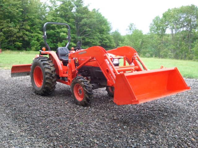

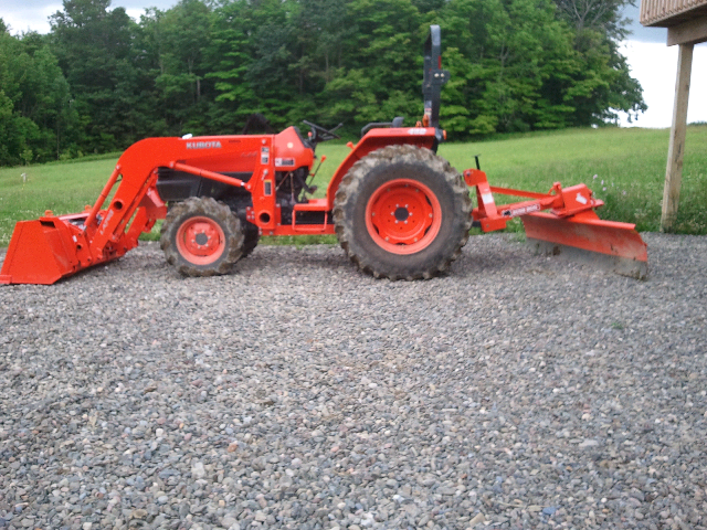

Hi guys, new member here! About 8 weeks ago I bought a bran new L4400. Had absoluteley no problems with the hitch, and considered myself lucky after reading all the posts. It was smoothe as silk. When I bought the machine I wanted one rear remote on it, and my dealer told me they where on back order and when it comes in he would pick up the machine and do the install. Well I just got the machine back and and never paid it no mind while mowing, but went to do some back bladeing yesterday, and now am the proud owner of a jerky hitch. Could this problem be caused as soon as additional lines are added? Was never there before! Almost seems like the fluid is cavitating, air bound or something.

Weldermike- I believe your L4400 and mine are the only ones at least on the forums that posted our 3pt hitch is jerky. I don't have rear remotes but my hitch was jerky since new. Its only jerky when raised slow, when I pull the raise lever up in one smooth motion it is smooth.
/ L series jerky 3 point #5
Same here general, only jerky on way up, if you go in small incriments, but if I go up quick it is smoothe. Problem only showed up with new remote tho, so weird, gonna look into it.
