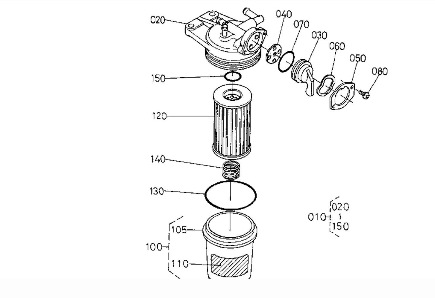

Hey folks, I have a question. I have a Kubota L3010 that I am in the process of changing the fuel filter on. I have the new filter ready to go on with the new large O ring on the housing. The folks at the dealership also gave me a smaller O Ring. I can't see where this fits onto the filter or onto the inner part of the housing. Is this O Ring necessary? If so, where does it fit? Thanks so much!!!

I generally read the L10 series posts, as I had an L3410 for 15 years. I couldn't remember the filter layout, so here's a parts breakdown...
/ L 3010 Fuel filter question
RJ thanks for your reply and the parts layout. What I don't get is the placement of the O Ring part 150. Does it just lay on top of the filter as I installing it? There does not seem to be a lip for it to rest on. What am I missing?
/ L 3010 Fuel filter question #4
IIRC, there is a nipple sticking down from the filter base that has an oring on it. The filter will slip over this. Just look up inside the base.

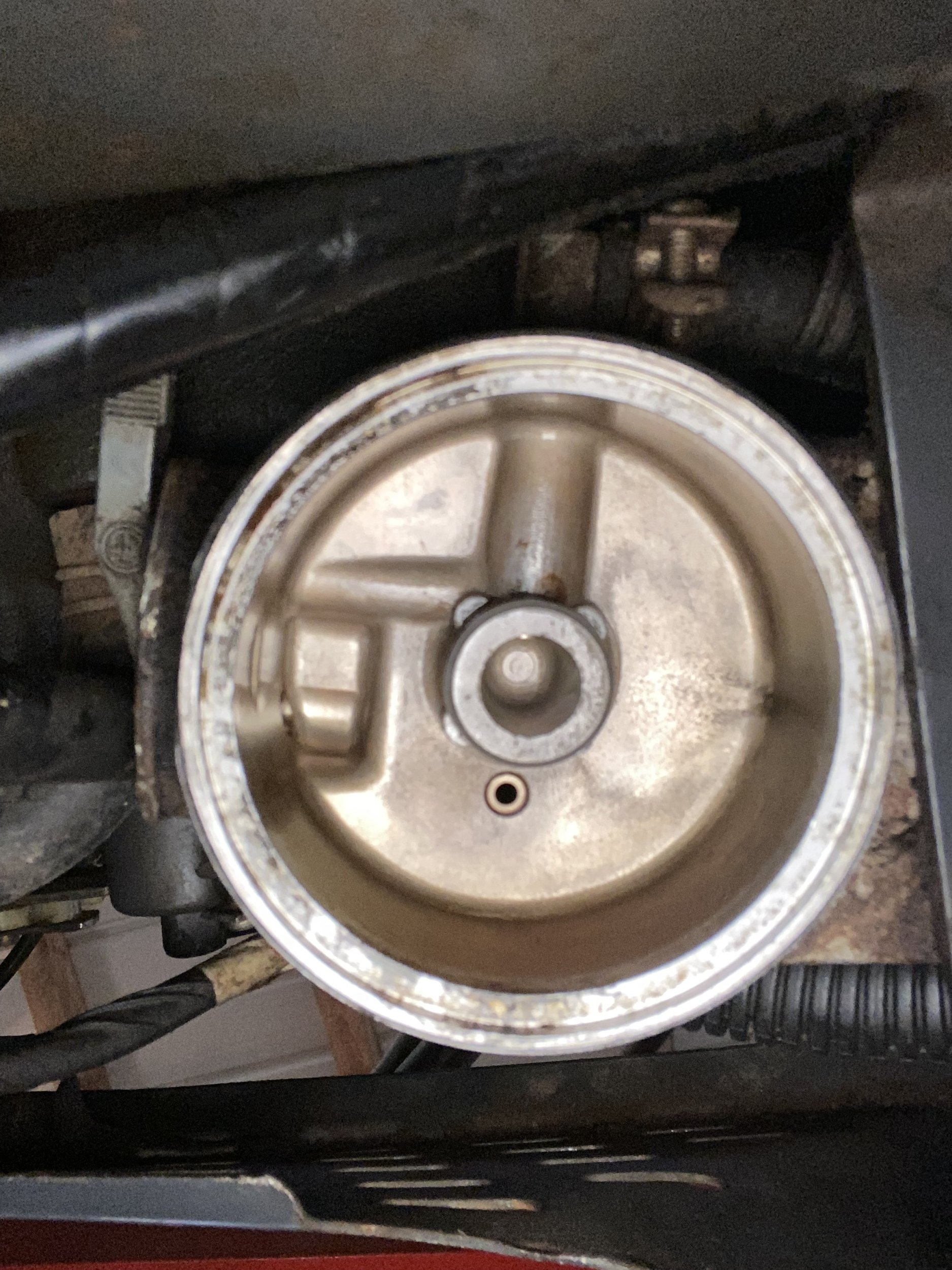

AZ here is a pic of the piece. I have tried to slip the O ring up on to this but it doesn’t seem to fit. Will it stretch a tad and go on?

/ L 3010 Fuel filter question #6
Yes, the oring will stretch. Just use a pick to remove the old one. Put a little oil on the new one after it's in place. Then push the filter element up in place.
Thanks much, I'll give it a go!
Thanks for your help, I got it on with no leaks!!!
