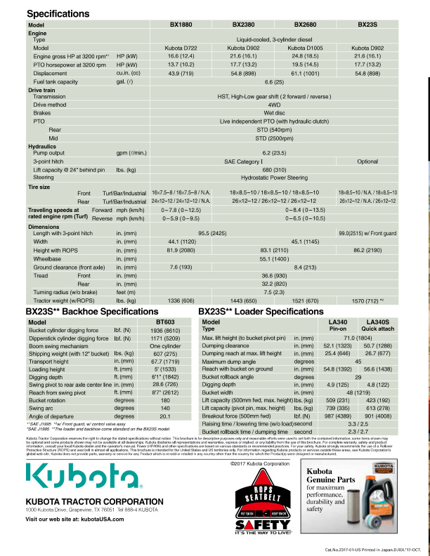

I'm thinking about buying a BX1880. My primary use would be cutting grass. However, my yard has lots of landscaping and I generally have to spread 30 yards of mulch every year. Loading it and spreading it myself via a wheelbarrow is too hard on my back to I usually pay someoeme one to do it. The BX1880 with a front end loader should allow me to do it on my own and would save me several thousand per year. So over time the 1880 should pay for itself. I also have a long hilly driveway and it can be difficult to get out when it snows so a snowblower would be nice also.
Would apprecaite any thoughts on whether this would be a wise purchase. My main concern is that I am on a hill so in parts of my yard I worry about tipping over. I assume (hope) I could alleviate that risk with a ballast box and keeping the front low to the ground while moving the mulch.
Currently I have a John Deere X300. I put a 40 inch tractor shovel on it but it only moves a max 1.7 cubic feet at a time. It takes forever to get the mulch moved with it.

In succession to a 2-WD Lawn & Garden tractor a 4-WD Kubota BX will be a significant upgrade.
The BX, like most Subcompact category tractors, sits low to the ground. Not good for woodlands nor lumpy pastures. Fine for smooth lawns.
The BX, like most Subcompact category tractors, sits low to the ground. Because of minimal 7" front / 8" rear ground clearance many operators feel comfortable with the stability of a subcompact tractor but less comfortable on a Compact tractor with 12" to 15" of ground clearance.
Wheel spacers on a BX will certainly make a BX feel more stable.
Most only add wheel spacers to the rear. Front spacers increase tractor turning radius.
My yard has lots of landscaping. I generally spread 30 yards of mulch every year.
I have a long hilly driveway and it can be difficult to get out when it snows so a snowblower would be nice.
BX1880 has only 13.7 PTO horsepower. With this minimal power snow will not be blown far. Consider a plow or snow-box.
Consider if BX1880 will have enough power to climb your hills when laden.

Your Deere X300 has a 17-horsepower gas engine mobilizing a 500 pound piece of equipment.
The BX1880 has a 16.5 horsepower diesel engine mobilizing a 1,336 pound piece of equipment. FEL adds more weight over bare tractor weight of 1,336 pounds.
