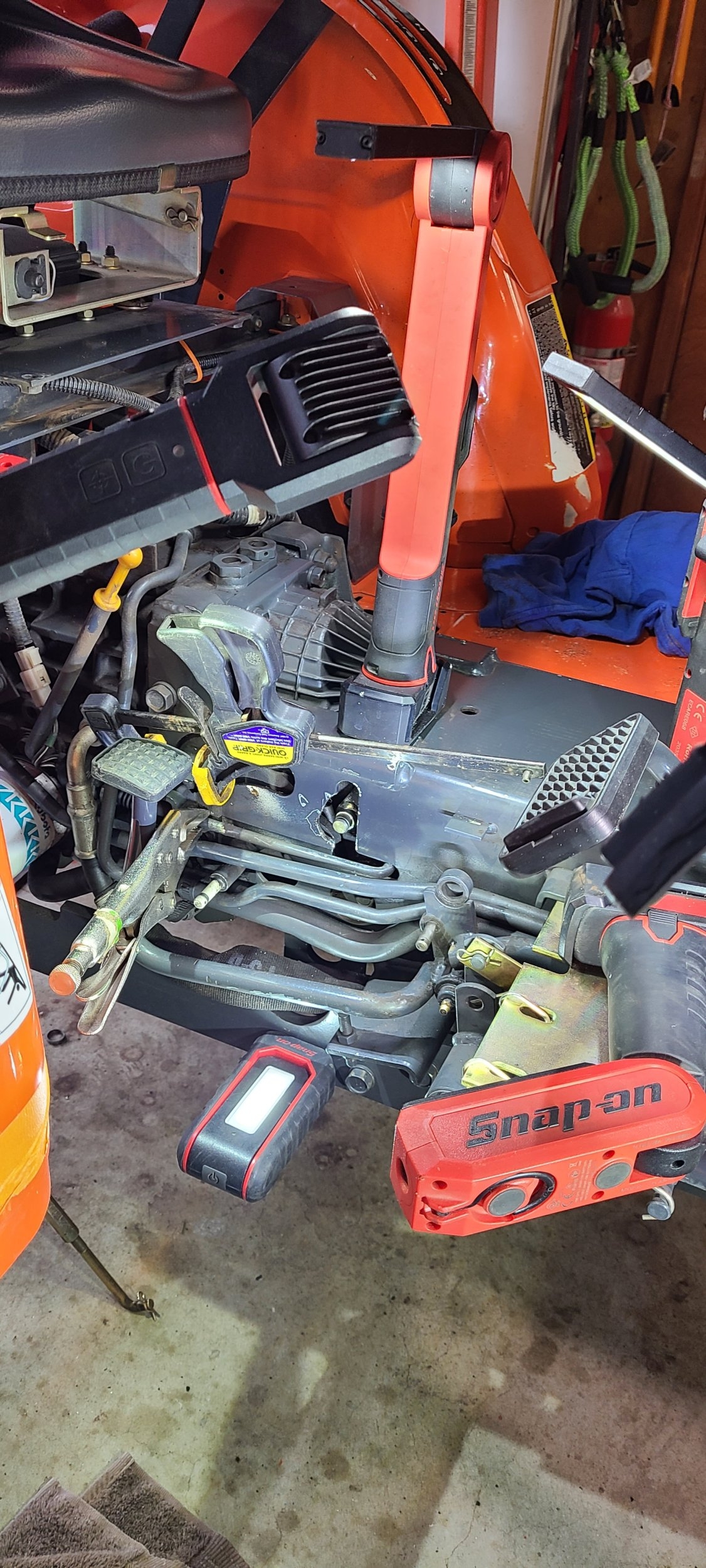

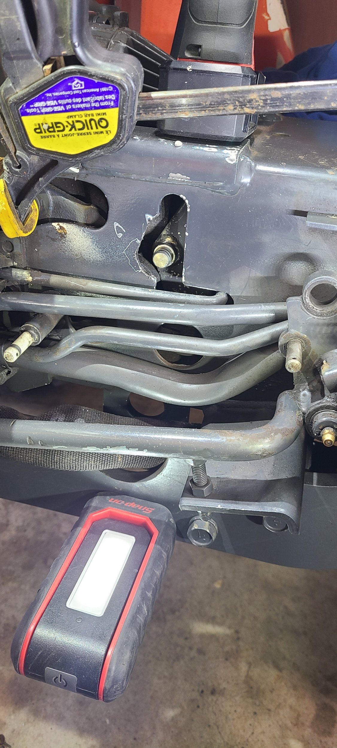

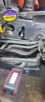

Well I spent the afternoon grinding and removing the bearing or what left of it. The hardest part was getting the race off.
