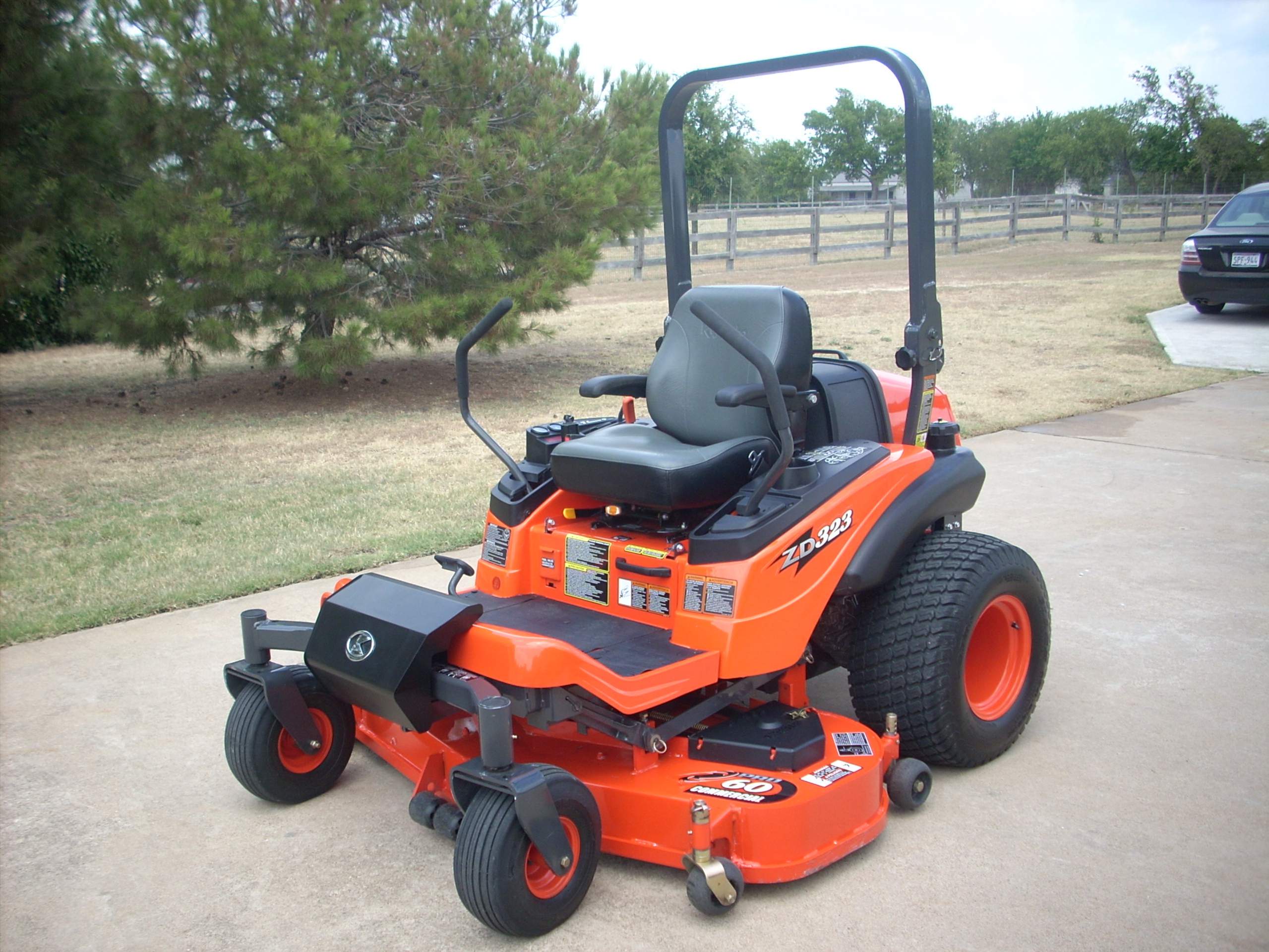

I have not owned both products, but I could offer up a little of my perspective. My next door neighbor and brother in law, was my father in laws originally, both have Scag Tiger Cats and really like them. I think the Scag gives a slightly better cut than my Kubota ZD323 and it is really quick. Nothing is bullet proof without the proper maintenance and my neighbors is a victim of that. He is waiting for me to do some work on it for him. It is not the mowers fault, but lack of maintenance. My neighbor across the street has a small Hustler and the previous owner had a Scag Freedom Z. They will all do the job and with proper maintenance will last a long time and give a good cut. I looked hard at the Scag's before I bought, but I really wanted a diesel and when you put that in a Scag, Hustler, Bad Boy, etc the price jumps way up and makes the Kubota look like a bargain :)
If you decide to go the Kubota route, I would really try to talk you into the diesel. You will never have to deal with gasoline turning to varnish, adding stabilizer, spark plugs, gumed up carbs, etc. As soon as I fill my gas cans with gas, I immediately add stabilizer and Lucas ethanol treatment. My diesel cans I do not have to add anything and the diesels alway run perfect. The diesels are also much better on fuel. I don't think you will recoupe the fuel savings dollars wise just mowing your lawn, but the lack of gas issues and higher resale is well worth the price of admission to me. You also get the great diesel sound and smell. Again extra credit :cool2: Also, the ZD gives you the articulating front axle, which I use quite a bit to clean the deck. I leave it in the articulating position instead of fixed to allow a better ride and it allows me to go through my ditches in multiple directions following the terrain. The diesel will get you a liquid cooled engine as well, which again helps with longevity.

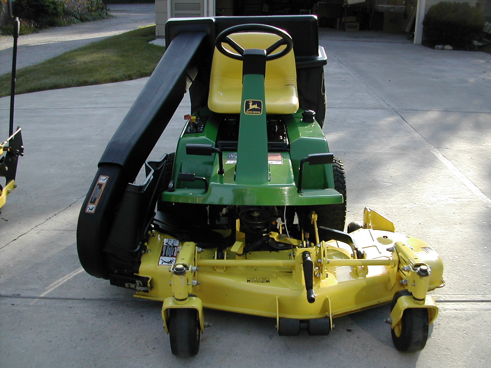

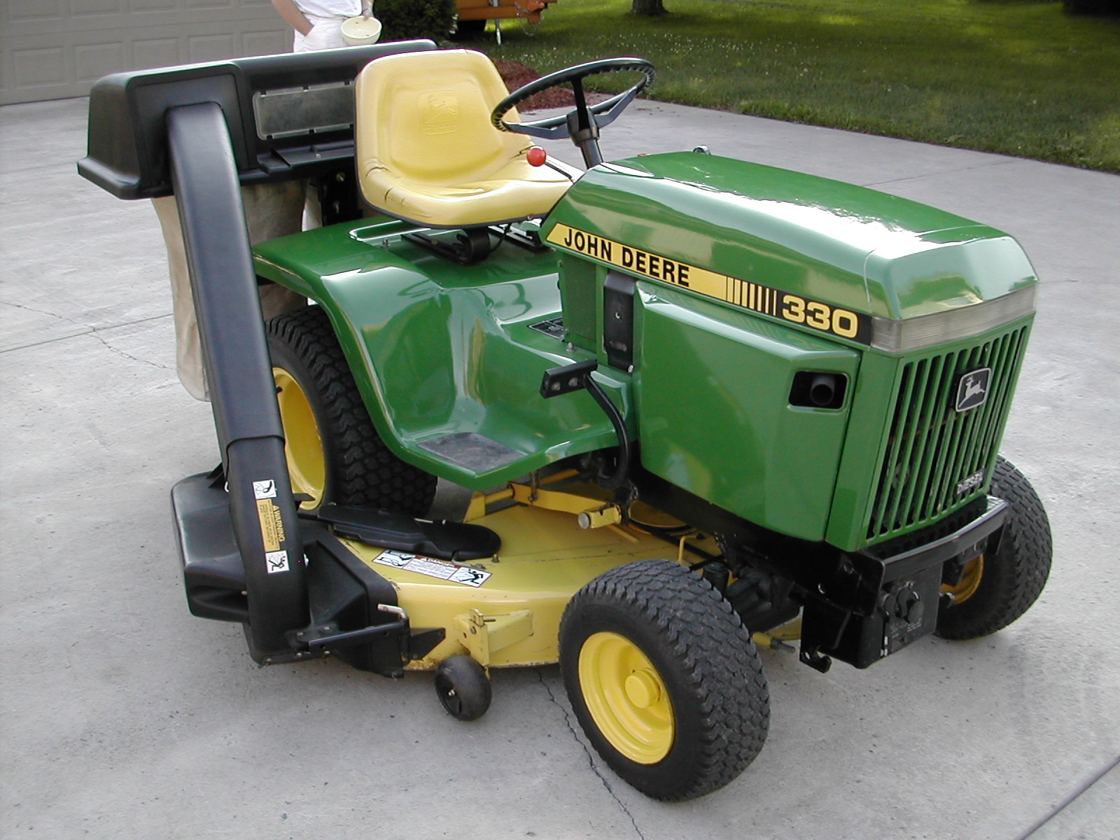

I have owned a few different diesels over the years and I have also owned two lawn mowers with Kawasaki's. The Kawasaki is an awesome engine, but it is not a diesel. It still has all the gas related issues. I am not an engine expert, but from what I know, the Kawasakis I have had and the ones in the Scag's are vertical shaft engines whereas the Kubota gas engine (and diesel) are horizontal shaft engines. The horizontal shaft engines always seem to have greater longetivity. Someone will probably tell me that is not true, but just my 0.02. I do not agree that a diesel engine will outlast the rest of the mower. With proper maintenance, the whole mower will last a lifetime. I will post a picture of my JD330 I sold when I moved to Texas. It was 23 years old in this picture and my old neighbor bought it from me and still loves it. It is now 27 years old and the only thing other than regular maintenance was an electric fuel pump went bad and the fuel filter mounting bracket broke. My father had a JD332 and had the same great luck with it. Every diesel I have had has been perfect. With my JD330 it blew snow every winter in Western New York (snow belt) and mowed all summer. I also posted a picture of a JD525 with a Kawasaki 17 hp engine I picked up on craigslist for the kids to mow with. They were somewhat afraid of the 330. The 525 had a powerflow bagger and a snowblower we used. The 330 had the bagger as well. The only mower that came along with me is a JD JX75 with a Kawasaki engine. Great little mower.
Sorry for the long post, but I would say go drive both. See which one you are more comfortable on and driving. I really wanted a diesel, but would have bought a gas if I found one that I really liked. What sold me on the Kubota was the big tires. Two inches taller on both front and rear than the Scag. Makes travelling on my not so smooth lawn much nicer. The Kubota also has a super comfortable seat with armrest and reclines. I think that is pretty much the same as Scag. The articulating axle that I mentioned above. The zero percent financing is nice with Kubota. I know Scag was not offering that when I was looking. I am not sure their current offers. To me, if you are going to spend a somewhat premium price to get a Kubota, why not get the diesel?

P.S. I think another note to add is the Kubota deck has a gear box and is shaft driven, verses belt drive to the deck on most everything else on the market.
