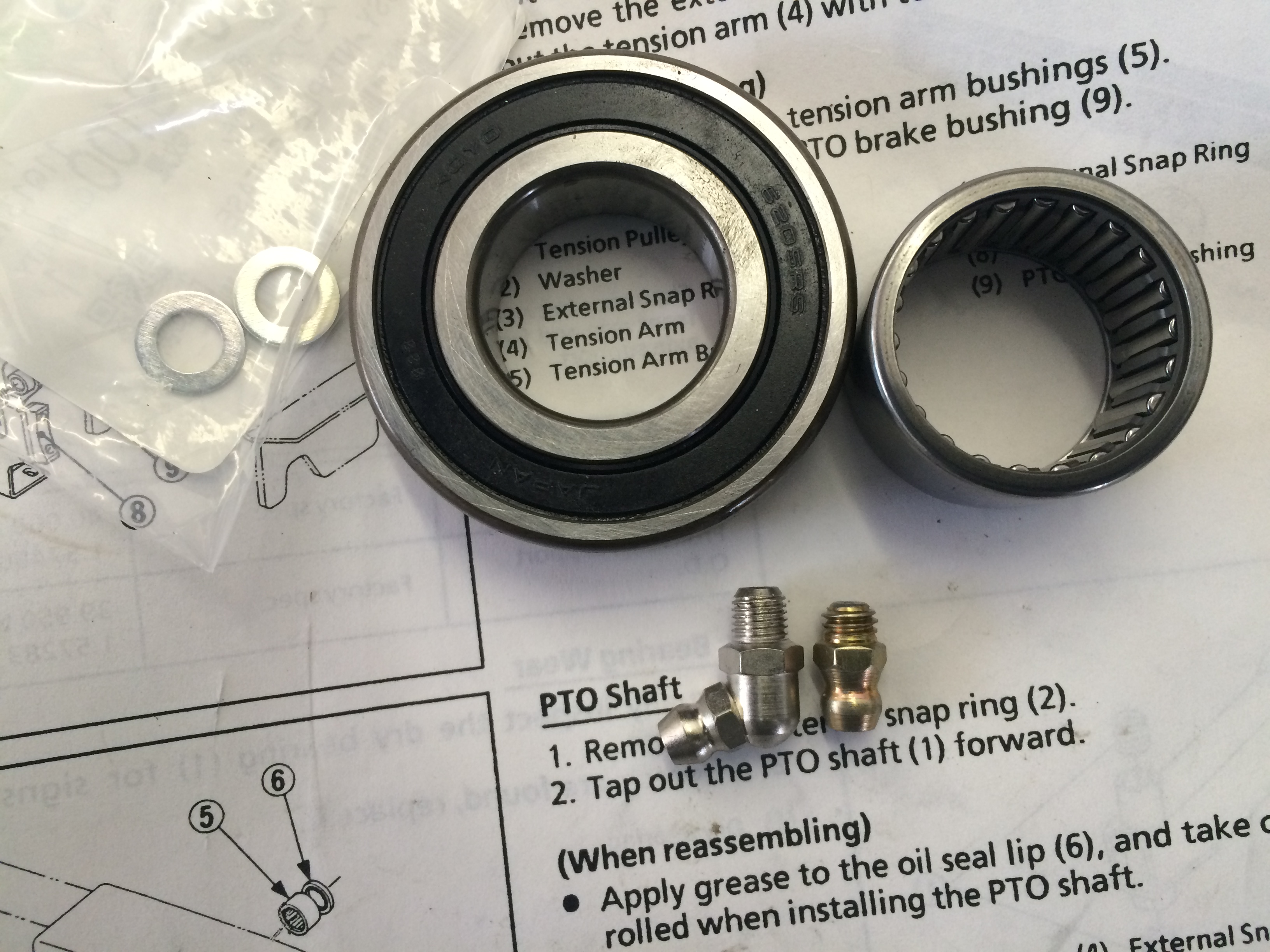

Post 1 of 3 on this fix. There is a happy ending! I just got time to put it back together this morning. I learned several things that I will share that might help non-pros who fix their own stuff. First the issue was the front PTO bearings on my G1800 garden tractor had come apart. The hole on the PTO support was clogged, preventing grease from getting into the shaft area and out to the ends to the front bearing and rear roller bearing. I pulled both the PTO shaft and the front axle support, which is what the PTO shaft fits into. So here is a picture of those. I purchased a new front axle support (left item in the picture) because I wasn't sure how to get the stuck outer race of the bearing out. And there is a roller bearing inside on the the other end, which I could have probably forced out. And you can see the inner race of the bearing I cut off the PTO shaft laying next to the pto shaft. I re-used the old PTO shaft.

My second concern was getting the correct length grease fitting because I thought if it was too long and up against the PTO shaft, that grease wouldn't go in. Since I had to special order the front axle support I also ordered the OEM Kubota grease fitting. Notice in the picture, that the shinny, new Kubota fitting has longer threads than the standard metric one I got off the shelf from the Kubota dealer. And notice the two washers in the plastic bag that came with the OEM fitting. The manual doesn't say if to use the washers or not, but I did. And since I had the PTO shaft out, I could ensure the grease fitting wasn't sticking out too far and hitting the shaft. From now on if I can't pull the old one out to ensure an off the shelf one is the same, I will order OEM. The previous owner had already replaced this grease fitting, so I wasn't sure.
Also in the pic are the new front bearing and rear rolling bearing for the PTO shaft. I also replaced oil seals not in the picture.
