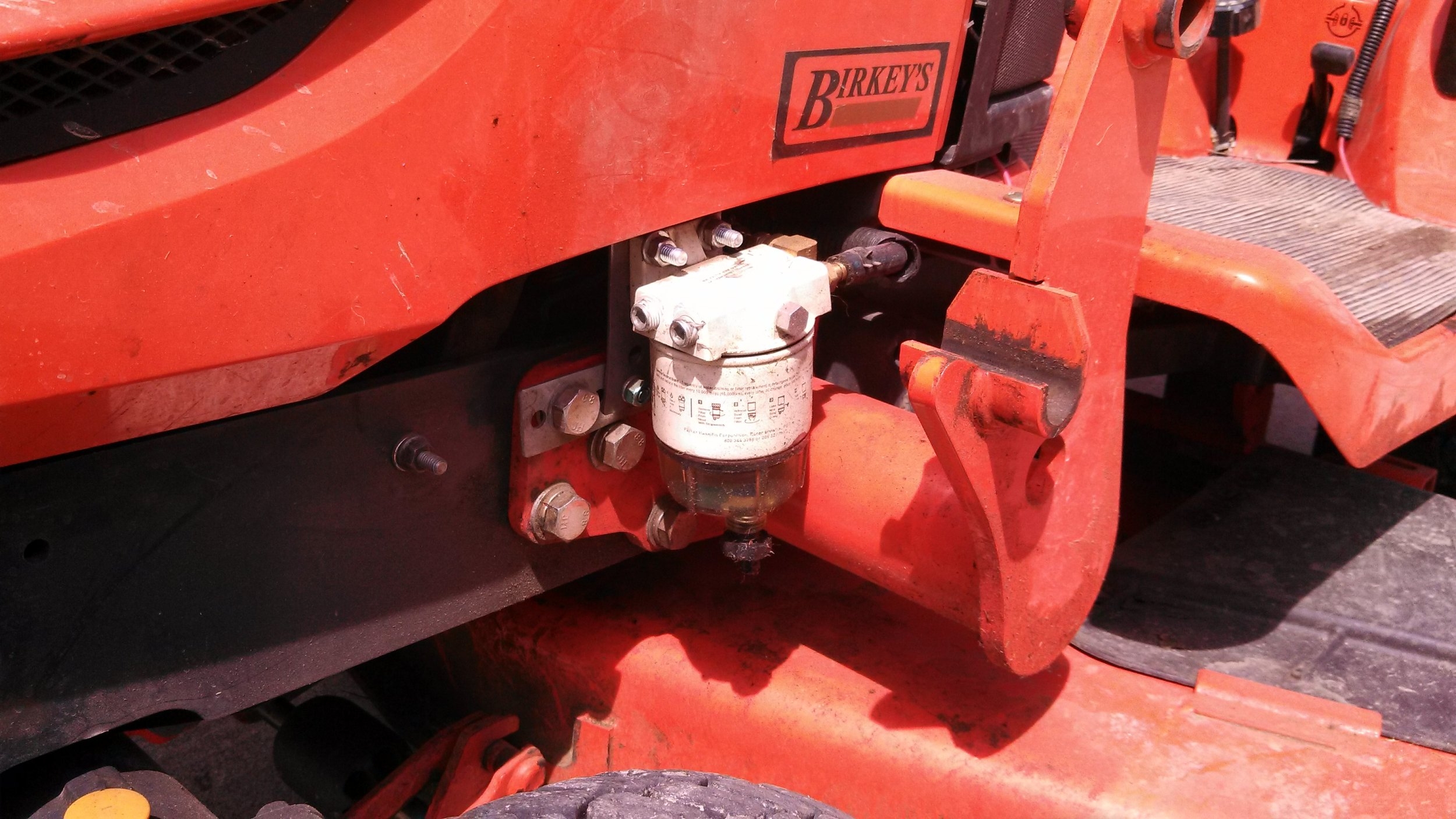

My little BX2660 does that too, but usually after an hour or two of running. Now, it's constant. It is VERY hard for me to work underneath it to change that filter, thanks to my injuries. I've watched several YT videos where others have replaced the underneath filter with a larger, more practical one mounted outside the frame. It is also transparent where you can see the filter as it gunks up. Gotta get me one of them... It also has a drain and the filter itself is easily replaceable. About $80 AIUI.
   / Kubota Stalling #6
This is a Racor setup I put on mine. You still have to get under the tractor to reroute the fuel lines and remove the old filter from the system.
   / Kubota Stalling #7
That's exactly the kind I want. yeah, I gotta get under there, like now. <sigh>
