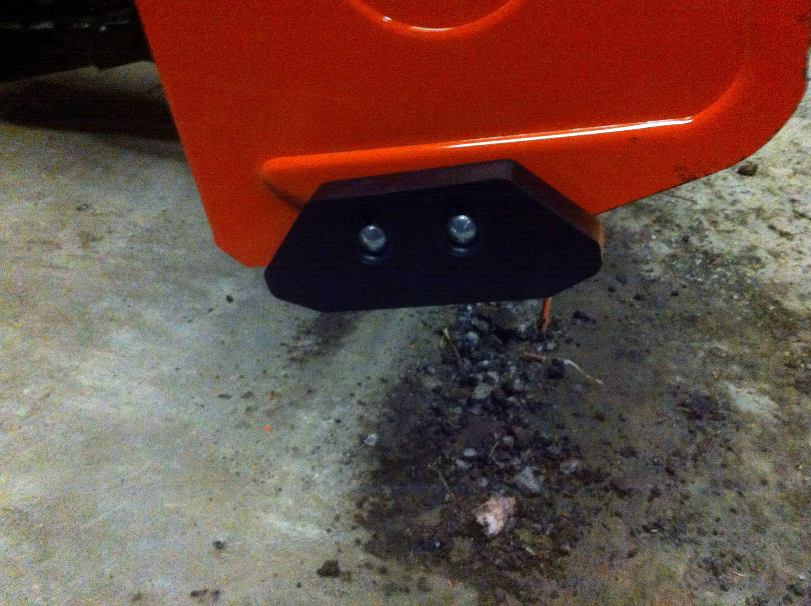

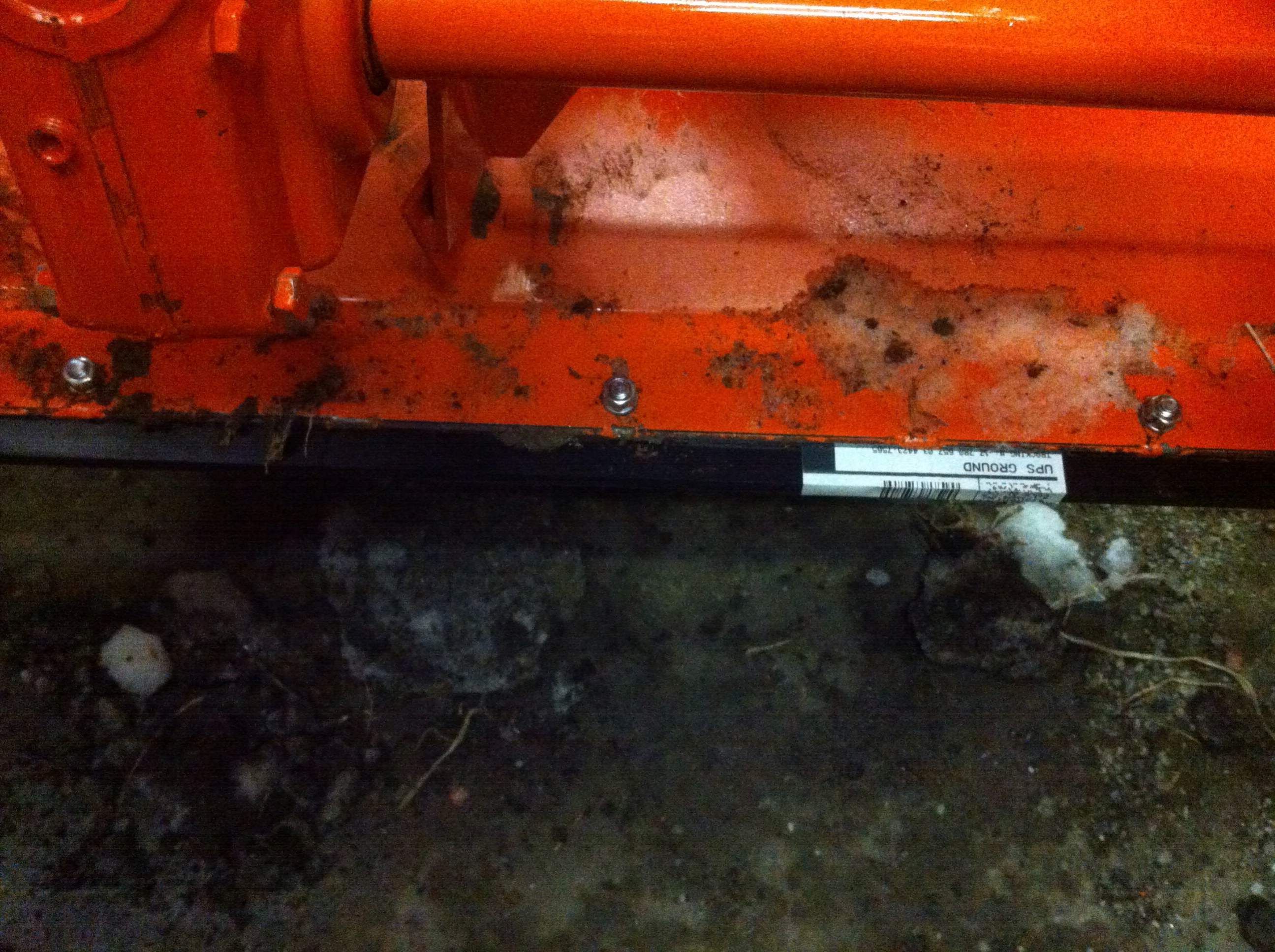

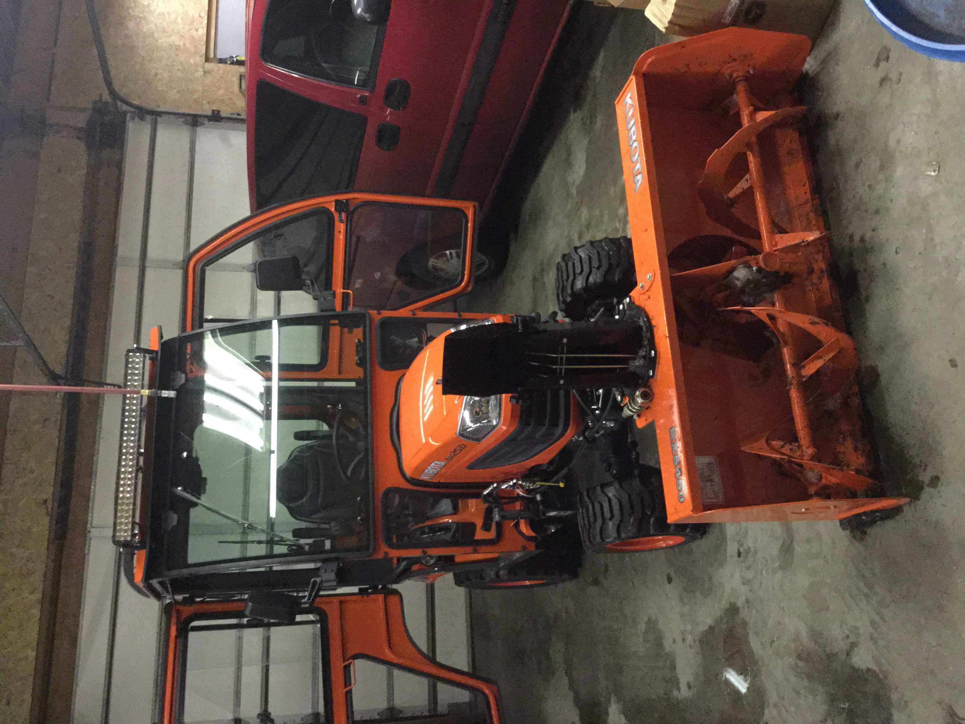

Hi my name in Ron I have a BX25d-1 or 2014 I have a bx5450 snowblower the only difference between that and the bx2750 is the 5450 has four blades on the second stage and you can replace the shoes and cutting edge with plastic part# bx5444 skid shoes and part# bx5445 cutting edge. image.jpgimage.jpgimage.jpg

Hey Ron,
Welcome and thanks for the information on the BX5450.
That's a nice looking setup you got there. :thumbsup:

Where did you purchase the material to line the chute ? How did you attach it ?
