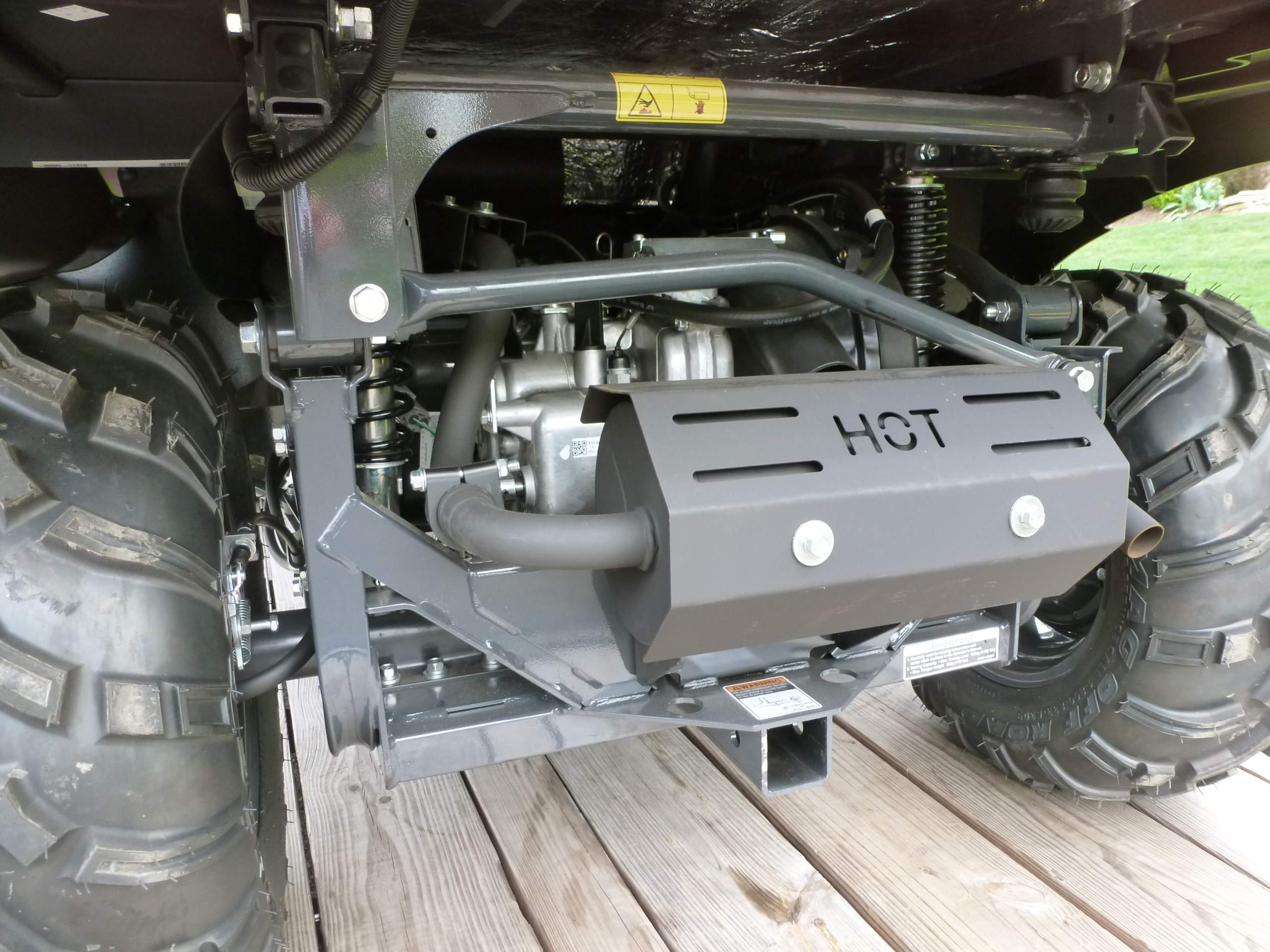

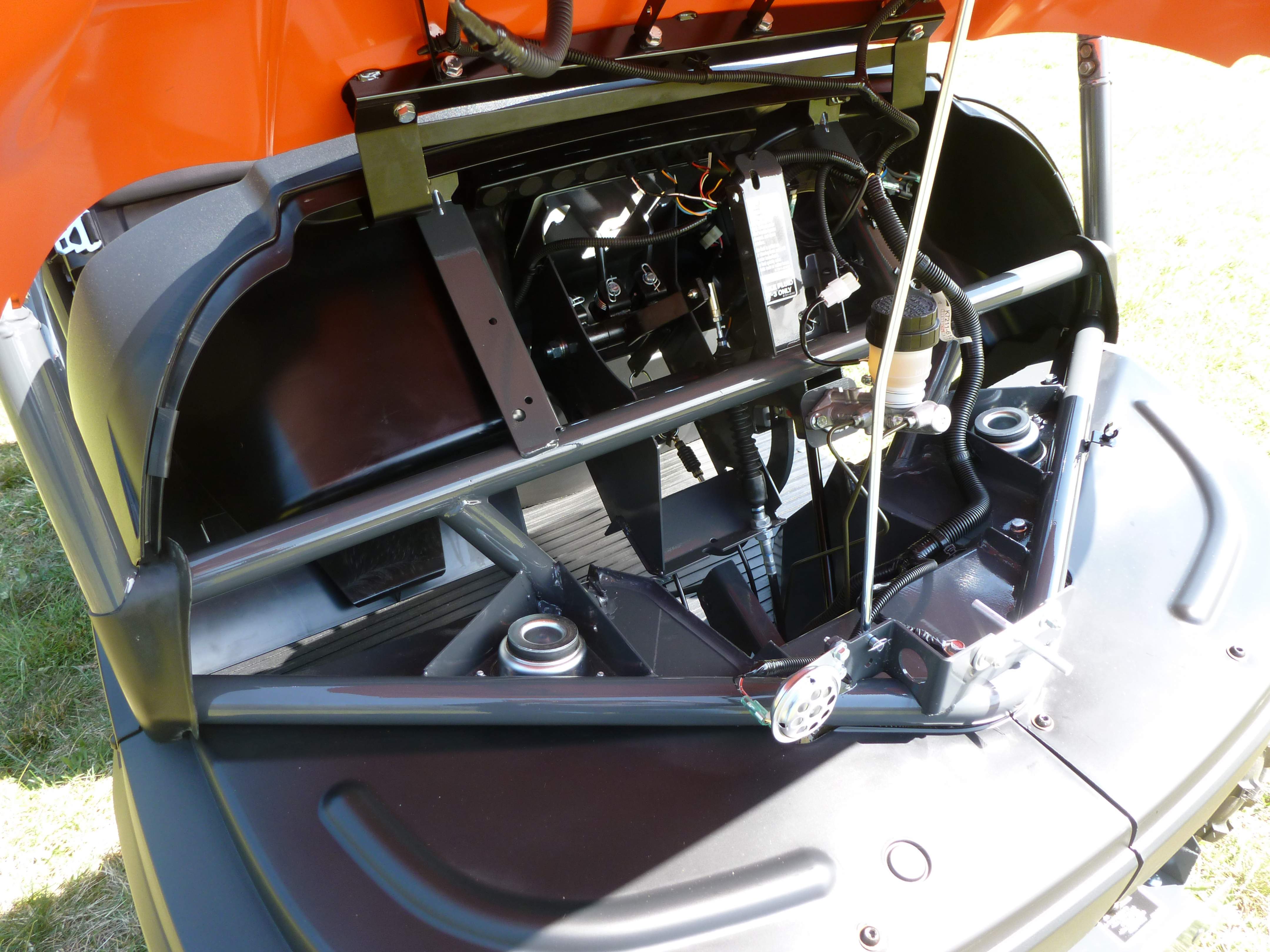

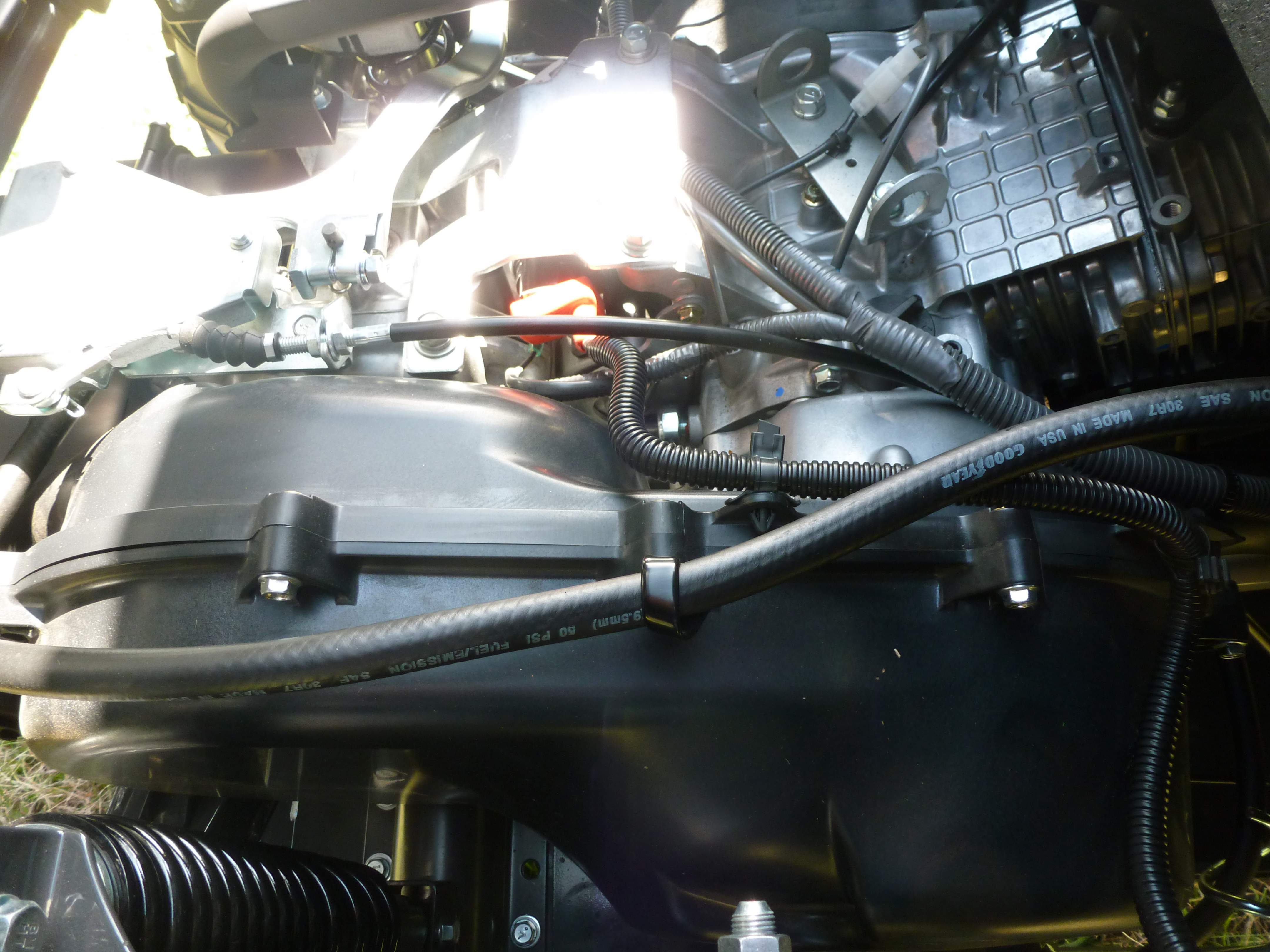

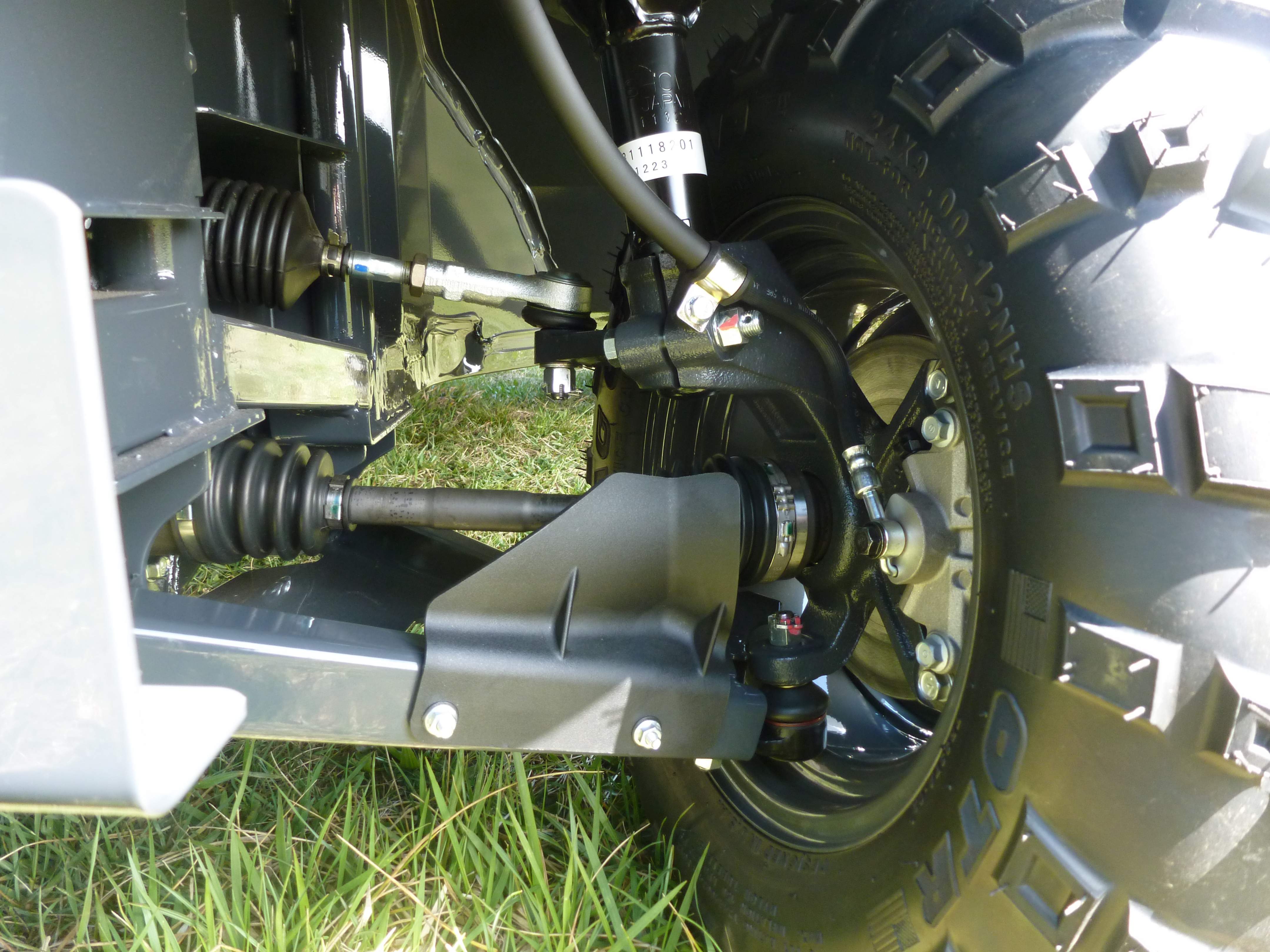

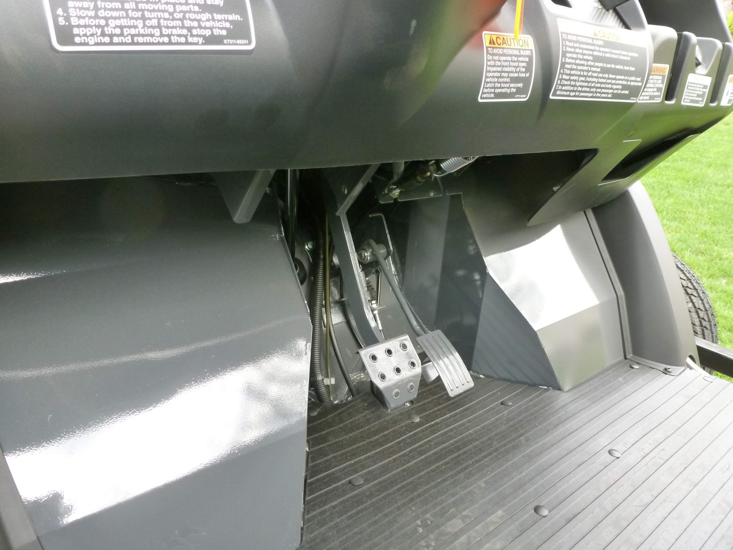

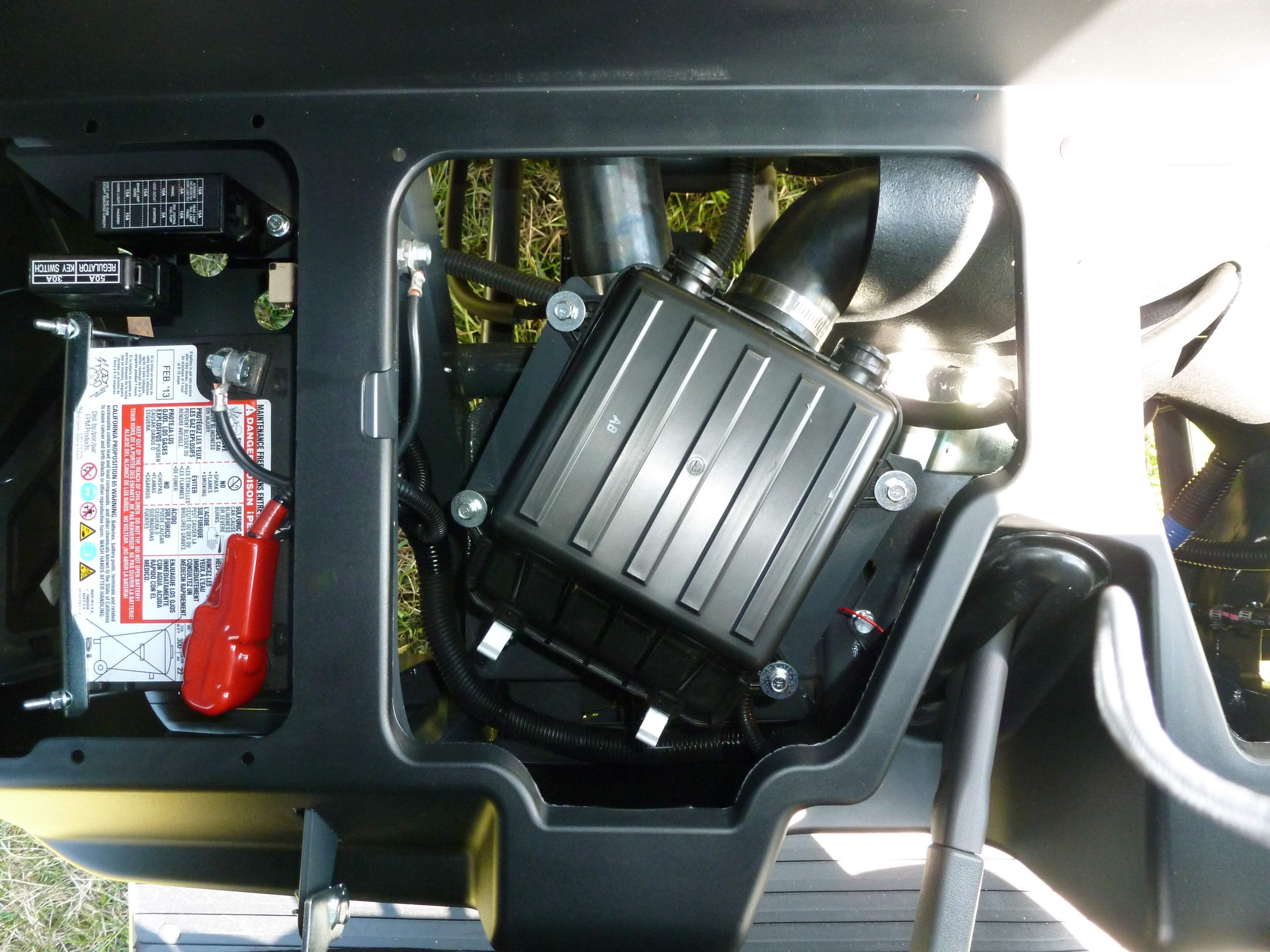

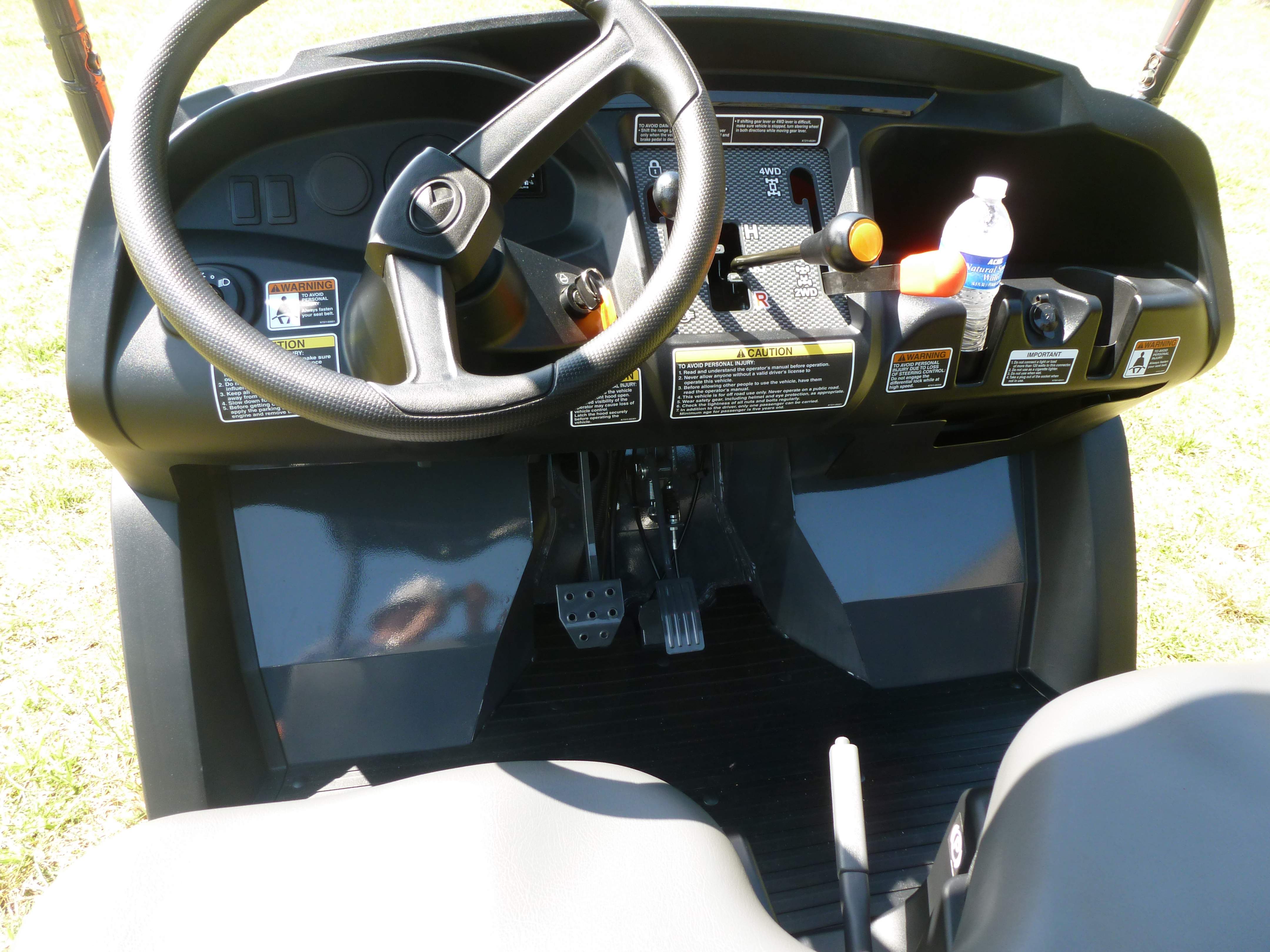

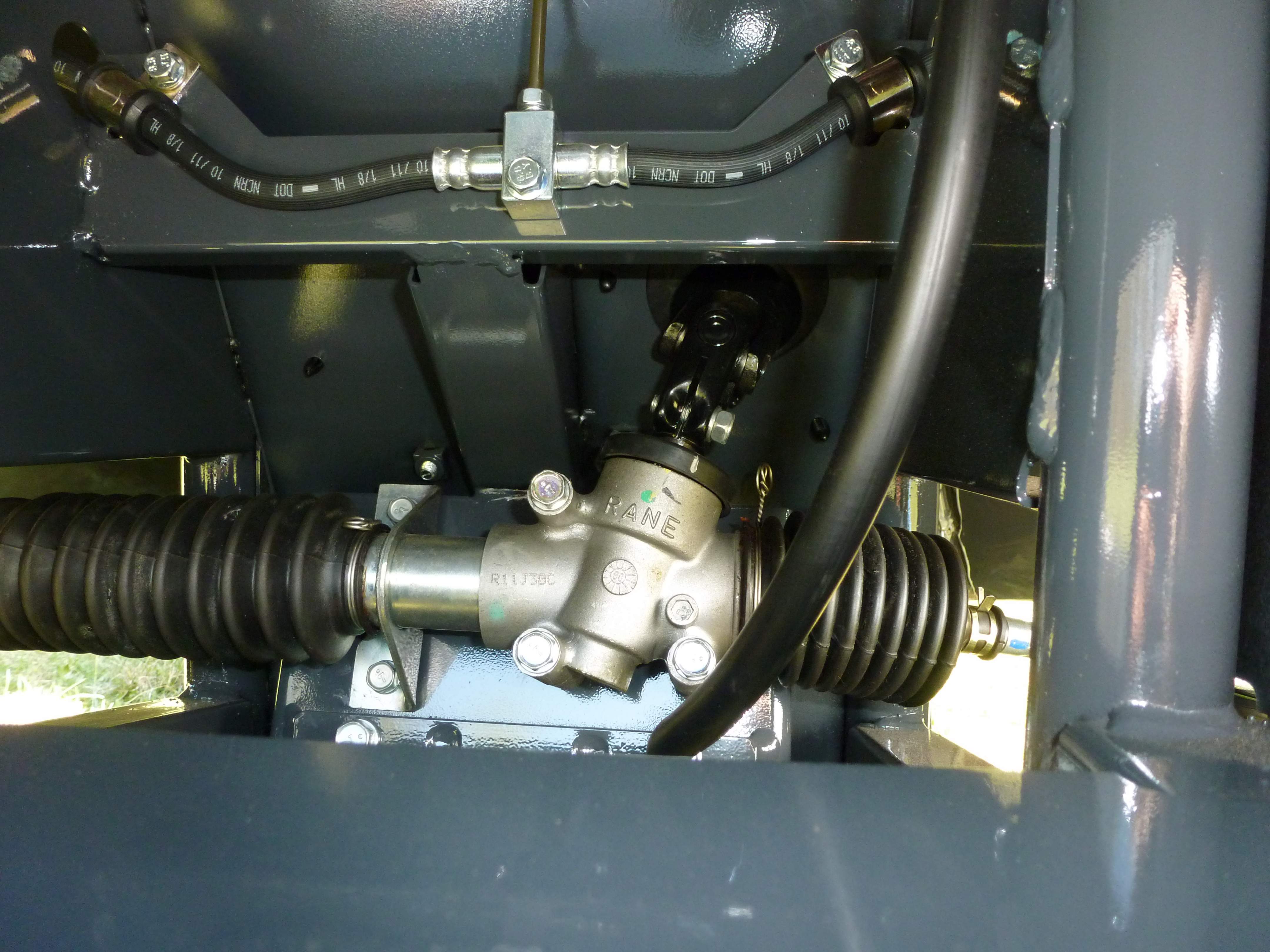

some new pics below, while it's squeaky clean, showing various parts.
Will get some time on it next week.

It's a 500 with a 400 in it (observation by picture)...Keep us up to date as to it's behavior.

I had a friend look at this, someone very knowlegeable with heavy equipment, and he was like me the first time..."where is the engine"? The CVT casing is strange, the motor layout is strange, I don't get the visual cues like the kneebone is normally connected to the thigh bone here. More like "what is that thing?". I read the manual and will now compare their pics to the real machine. No zerks anywhere, just linkages requiring spray grease, so very low maintenance, EXCEPT, wow, what Kubota expects one to do, like replacing fuel lines after some very short number of years, and other parts that went far beyond any maintenance spec or time frame I have ever seen.
