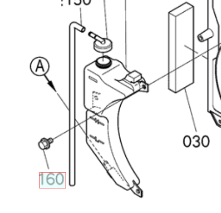

I don't believe that's correct. The overflow from the radiator cap goes to the _bottom_ of the burp tank. That's how it's able to draw coolant back in when it cools w/out aspirating any air.
The barb on the cap goes to an overflow hose that is open at the bottom and drains "overboard". At least that's how it is set up on my BX and GR.
thanks,
Z.
I will have to take a closer look then. That is how our B7500 is setup (with both a dip tube that goes to the bottom of the tank and a vent in the cap, it has 2 hoses that connect to the cap, 3 if you count the dip tube).
Aaron Z
   / Kubota Recall - Be Aware!!!!! NOT SURE WHO OR WHAT YEARS ARE EFFECTED...!!!!!!!!!!!!! #32
Aaron Z

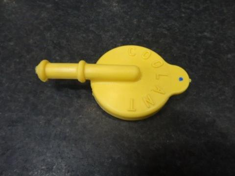

From the recall notice:
Z
[edit to add] Burp tanks from GR and BX. Radiator overflow hose nipple at bottom, burp tank overflow at top.

Okay, the risk must be that the tank will pressurize and then pop open dumping steam all over you.
Aaron Z
That's the way I read it. Not trivial, but more a user safety issue than a serious engine problem.
later,
Z.

Pulled it off and is clear so I won't need the new one when it arrives but I am surprised there is no hose into the tank, how does it reticulate what it has emptied into the tank?
   / Kubota Recall - Be Aware!!!!! NOT SURE WHO OR WHAT YEARS ARE EFFECTED...!!!!!!!!!!!!! #40
As mentioned up-thread: the hose from/to the radiator is at the _bottom_ of the burp tank. The hose on the top is an overflow that dumps over the side.
Z.
