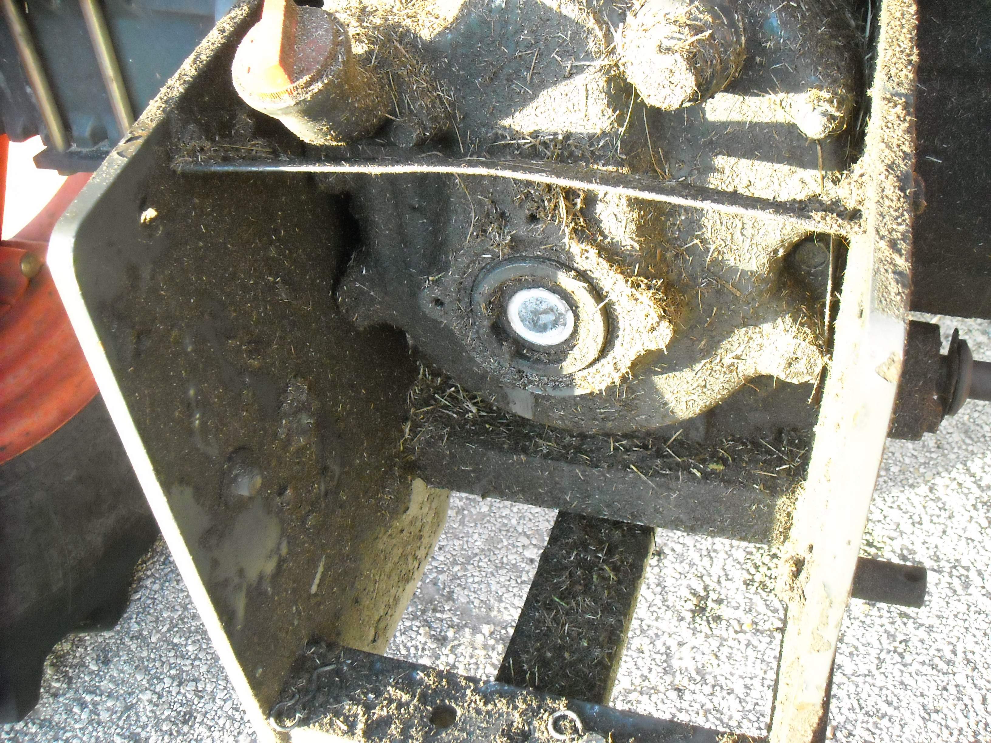

I have two Kubota M110x, one pulling a 15' Bushhog RotaryCutter, and a 20' BHRC. My problem is this: We have had to replace the PTO shaft on each tractor at least twice. My question is, is this at all related to operating the attachments at higher than 540? I am leaning towards yes, but I am getting nowhere trying to get a definitive answer. I'm sure once the operators are in the field, they are operating at max RPM. I wam considering having my mechanic put governors on the tractors to keep them at or below 2300 rpm. Any help?:confused:

I doubt that the shaft speed is a direct cause - the engine doesn't make that much more torque at higher rpm anyway. Impact loading is the more likely cause. And the M110 should be able to soak up quite a whack without breaking. It sounds like the pto shafts may be hardened too much and are brittle. Has the factory been involved in any of these replacements? Are the gears ok? Where are the shafts failing? At the same spot? Do they twist and bend or just crack apart? Could you post a closeup picture of the broken pieces?
/ Kubota PTO Breaking
It's pretty consistent in the same spot, give or take an eighth of an inch or so. We've had a warranty repair on it the first time, but the dealer felt he was actually just doing us a favor. As far as he was concerned , it had to be operator related.

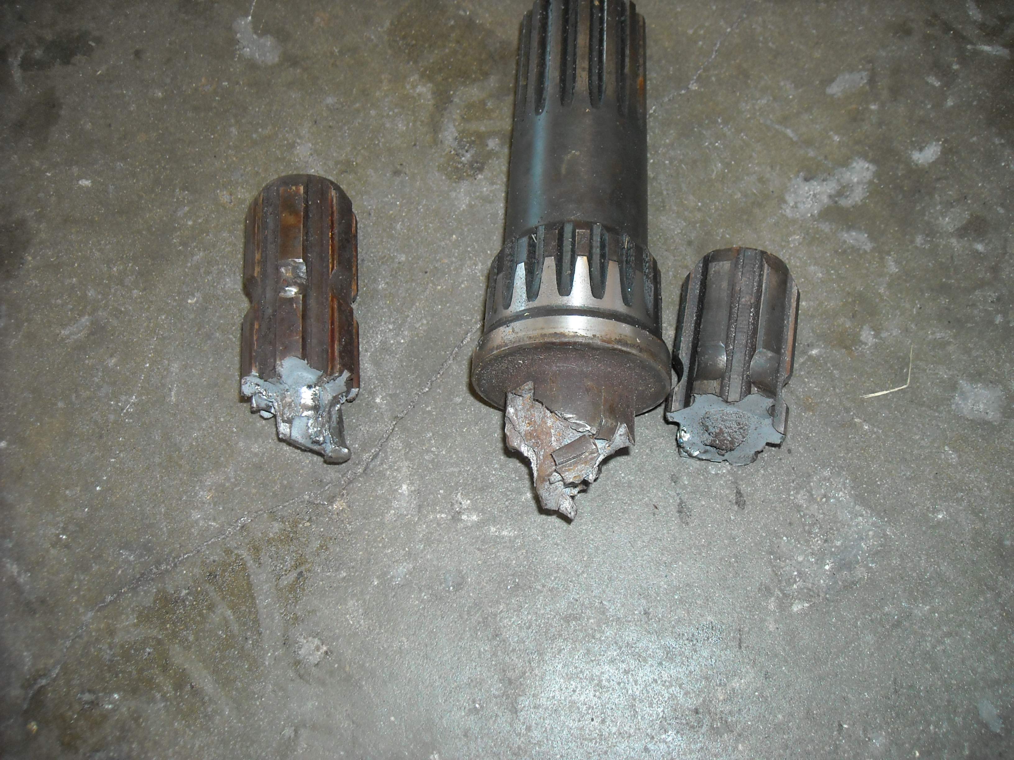

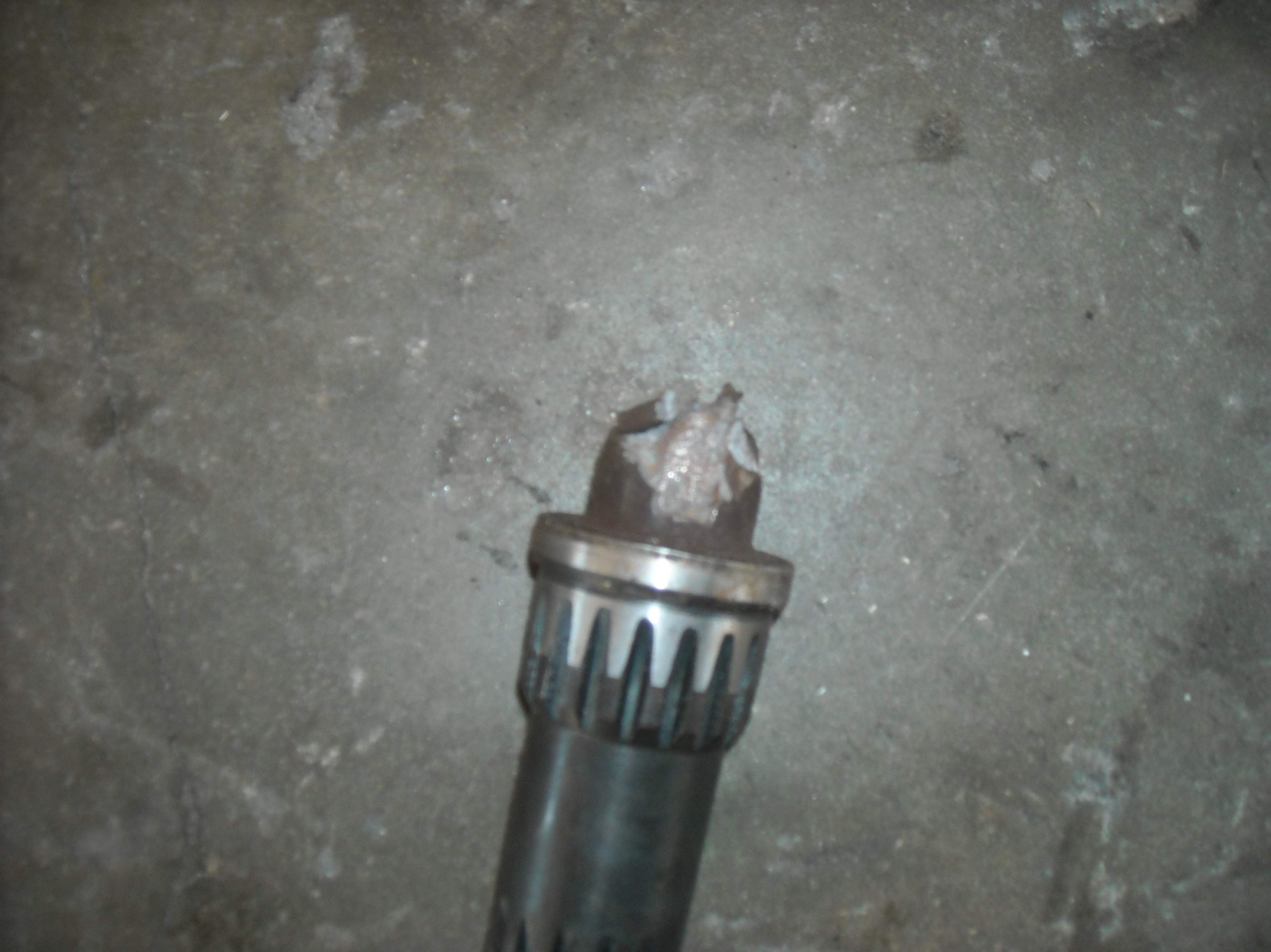

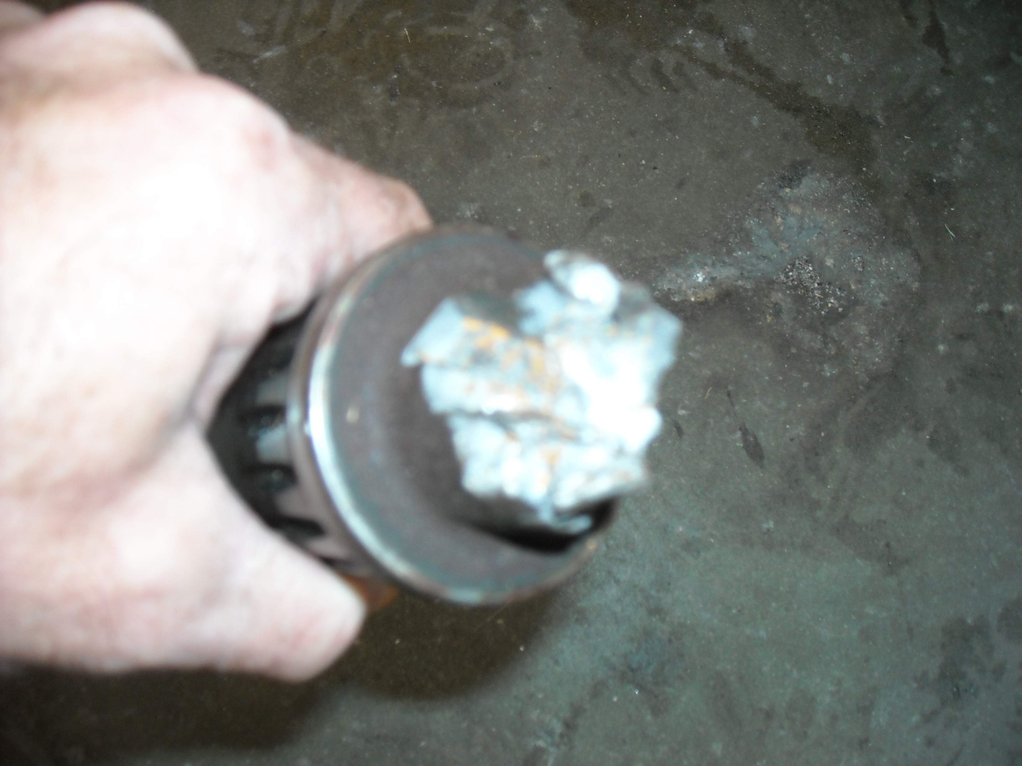

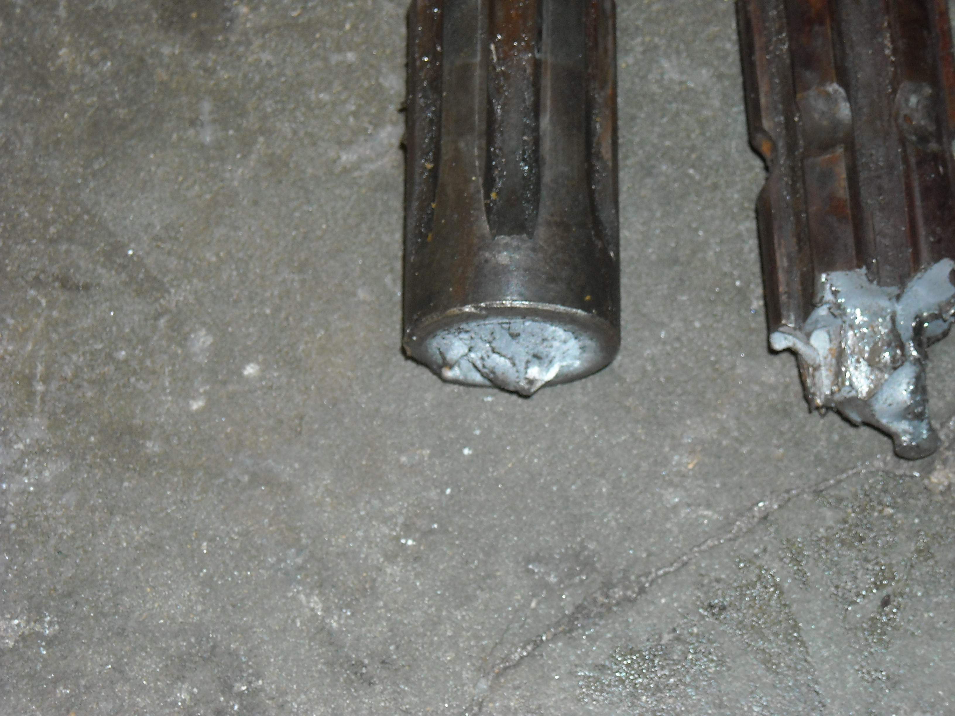

Here's a few more pics. The inside gears look okay. One shaft looks like it was twisted before it broke, but the other three are clean breaks.
That's as close up as I could get with this camera.
Pictures 1,2,and 4 look like impact breaks to me. caused by impacting an object or start up torque! or so I think with pictures. Have you taken them to a drive line shop or someone that see's alot of these and get their ideals!

Those breaks have a little of everything - combined side load, twist, and brittle fracture. The spiral break is more of a torsional failure - but the first pic is a classic brittle failure. Slowzuki's idea about the shaft pushing down with a bending load rings true to me. If it was all due to torque impact some gear tooth damage would be expected too.
Dumping the clutch to spin up a big mower from stopped can overload the driveline to the breaking point for the shear bolts. Check that the shear bolts in the drive line haven't been replaced with hard (grade 8) bolts. Hard bolts transfer the abuse to a more expensive part.
I'd ask the dealer to show those parts to the Kubota service rep and get some factory eyes on them. To my semi-trained eye they look through-hardened near the bearing and maybe case hardening with a ductile center would be better for this part.

Some look like torsional overload but at least one appears to be bending fatigue. Is it possible you have one mower with a bent drive shaft? We had one of our old IH 1456s snap its 540 rpm PTO shaft this year running a chopper and discovered a bent PTO driveline was creating a wobble that fatigued the shaft. The failure looked just like your picture of the tractor end.
