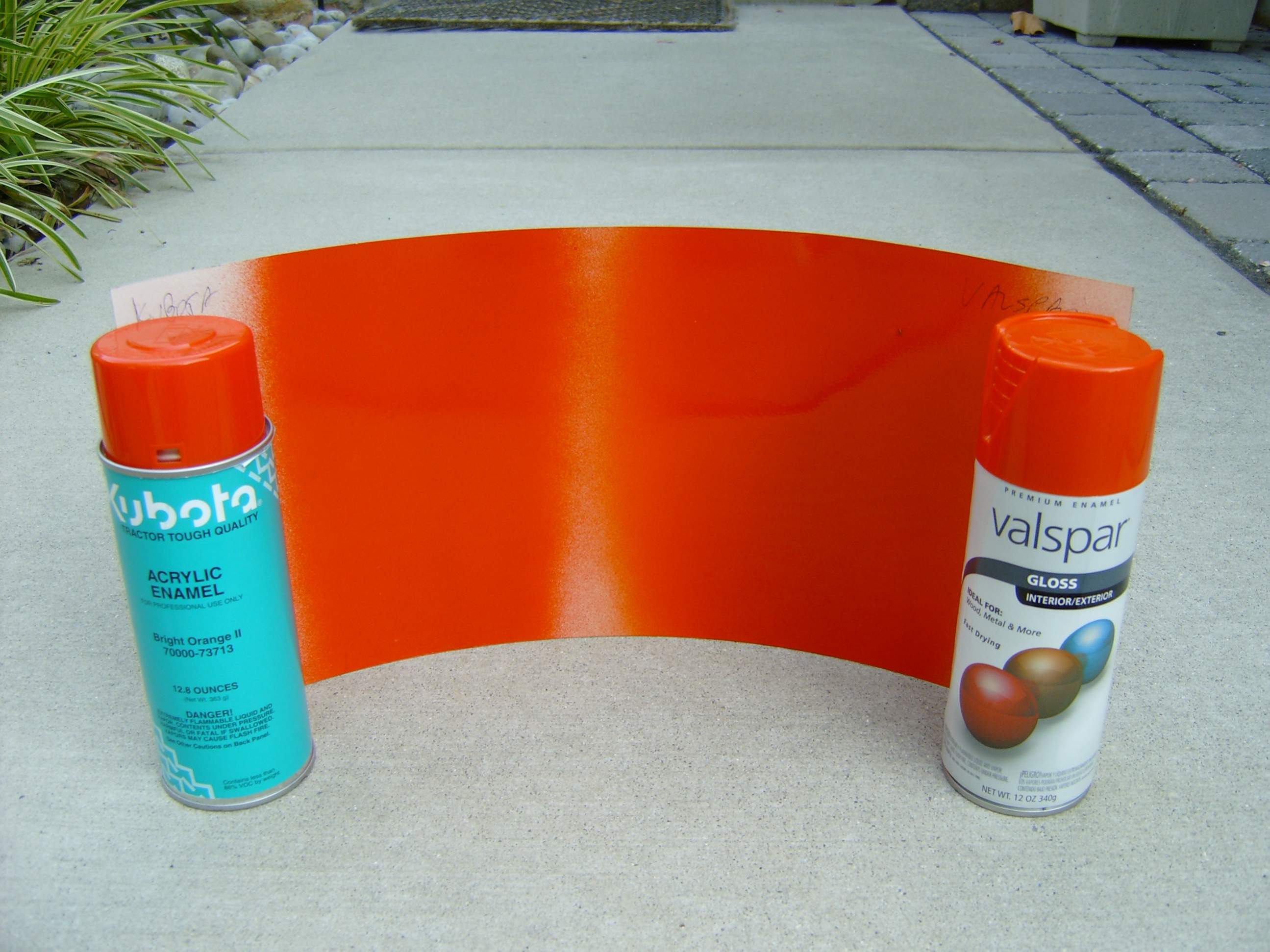

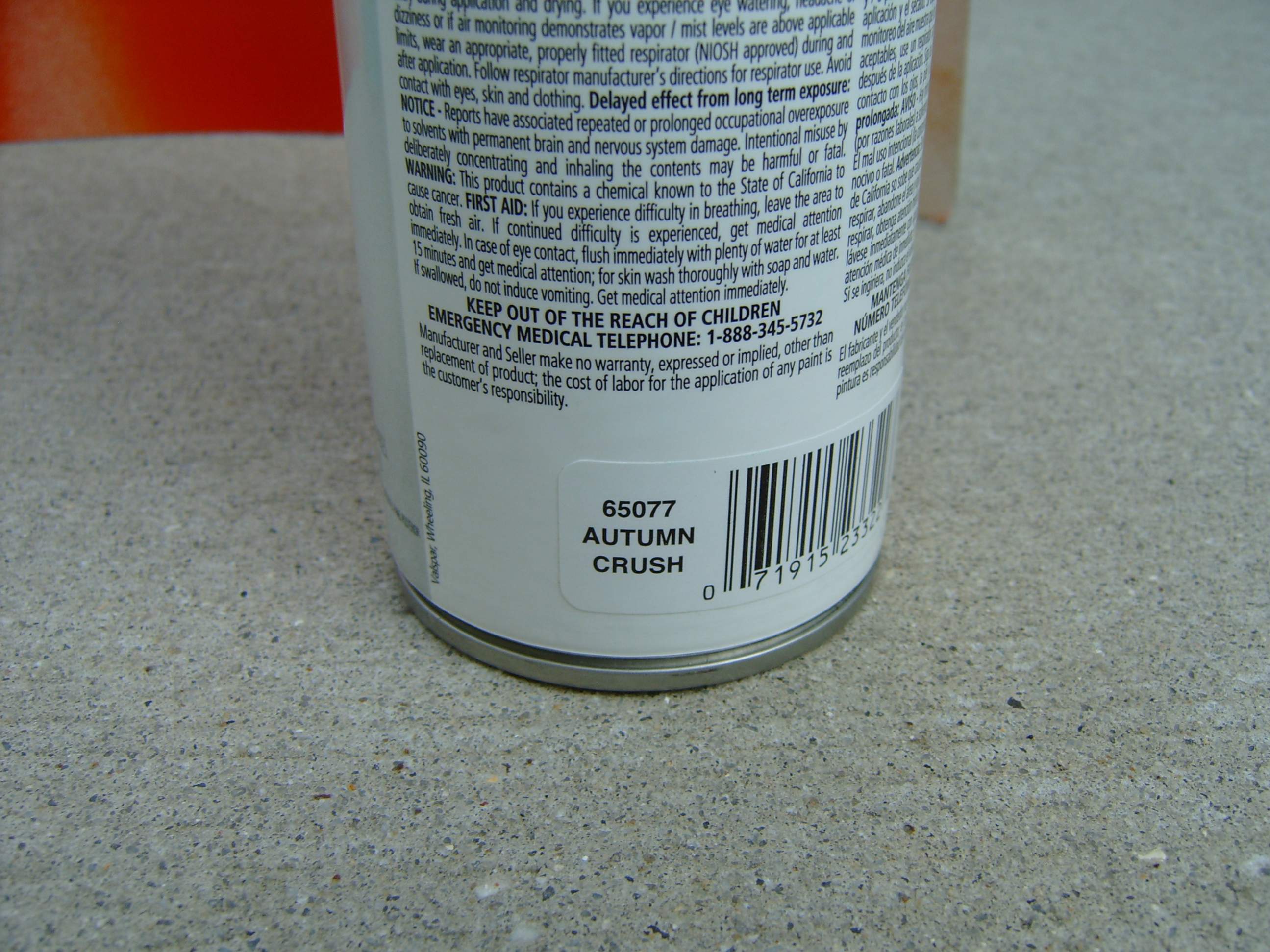

Lowe's has this Valspar "Autumn Crush" 65077. It's not their Orange, it is right next to the Orange on the shelf.
Not bad for $3.44 versus $11.50 for the Kubota paint.
As far as the two Valspar Kubota oranges listed on the TSC website, Manufacturers Number: 5339-27 and Manufacturers Number: 5339-24 , which one is the old and which one is the new color? They don't even give you a clue on the website, and the Valspar site is also no help.

I just bought Valspar "Orange" at Lowes. It's a bit lighter of an orange than your Autumn Crush but the only other Valspar orange I saw was noticeably darker than Kubota Orange (I had a cap from an old Kubota Orange spray can with me). May have to go back and check for that Autumn Crush. Haven't used the Valspar cans yet so I should be able to exchange them. I'm using it to paint my very used Woods back blade so it doesn't have to match exactly, but now you've got me wanting to take another look at Lowes. Thanks, I think.

It was right between the orange and the red on the shelf at my Lowe's.

Thanks for the info on the Valspar "Autum Crush" I pipcked some up and it matches **** close to the Kubota Bright Orange II on my freshly painted loader, I however am naturally going to use the Kubota brand paint on my whole tractor once my cab is finished, the coverage and quality of Kubota's paint is exceptional!

I looked at my spray out sample last night under the florescent lights in the garage. Its not exact enough that I would touch up the hood with it, but its close enough to paint an implement to match your tractor.

Exchanged my 3 cans of Valspar Orange for Autumn Crush on the way home from work. Looks to be a better match to Kubota orange. Also, the brand I got from the dealer that wouldn't spray was Tisco Tractor and Implement Enamel. Wonder if they shipped out a bad batch of this stuff to various dealers?

I also tried the Valspar "Autumn Crush" #65077 from Lowe's and my eyes don't see any difference from the original on my BX24. It's now my go to spray for touch ups.

I too use the Valspar Autumn Crush #65077 paint from Lowes, It is a **** near perfect match in my opinion, I only wish they sold it in Quart cans for a spray gun!
