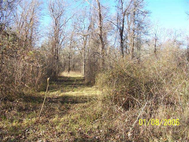

Maybe next time I'm cutting trails I can put the wax on...then let the brush take it off. Look at the left and right of the trail in the pic. That's what was in the middle...brand new trail. Put it in low range, first gear, about 1500rpm, hands in, head down looking for stumps, foot ready to hit the clutch...pray. :) Wait for daylight.

Now if you waxed it you would slip through that brush faster and have more power left over for the loader! :)
