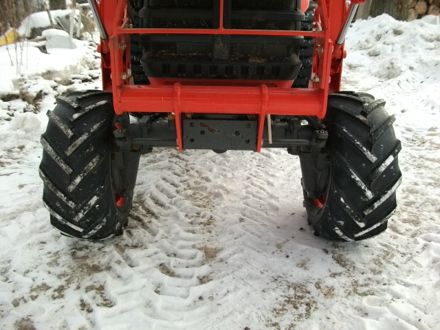

No one has mentioned ply rating. I put 10 ply R-4's on my L4350, 12" wide on the front because I wanted toughness and stability. On my B7800 I was unhappy with the 4 ply 8.5 wide R-4's on the front. I now have a 6 ply R-1 trencher tires on the front after getting lucky and finding the rims I needed. 1st time I have mixed tires but liking the results. The wider tires give me the stability I was looking for and the bar tread gives me a bit more traction.
