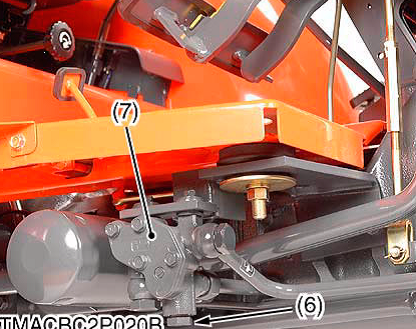

How true, so take some pictures of your existing hose setup at the hydraulic block (possibly similar to the attached pics) and I'll endeavor to show you which hose to tap into. I expect the block will be next to the filter, but instead of the blank plate with the 4 bolts, yours will have 3 hoses going into it.

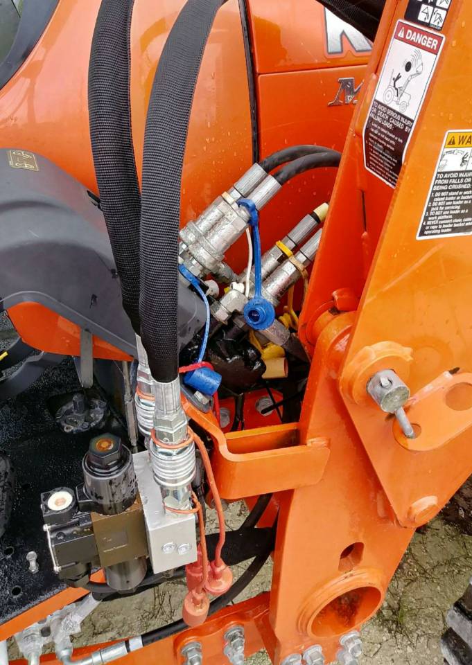

Here is a picture previously posted.
GR8 pic MVR, saves me trying to add labels! Note the slight difference, PB from loader runs in front on mine, behind on MVR's, but they are identical so to speak. If yours is like this, you just break in between the PB from loader hose, or the PB at block(top left port). If yours are three hose remotes, you will also need to run one to tank, teed like MVR's or to filler hole of hydraulics like some do.

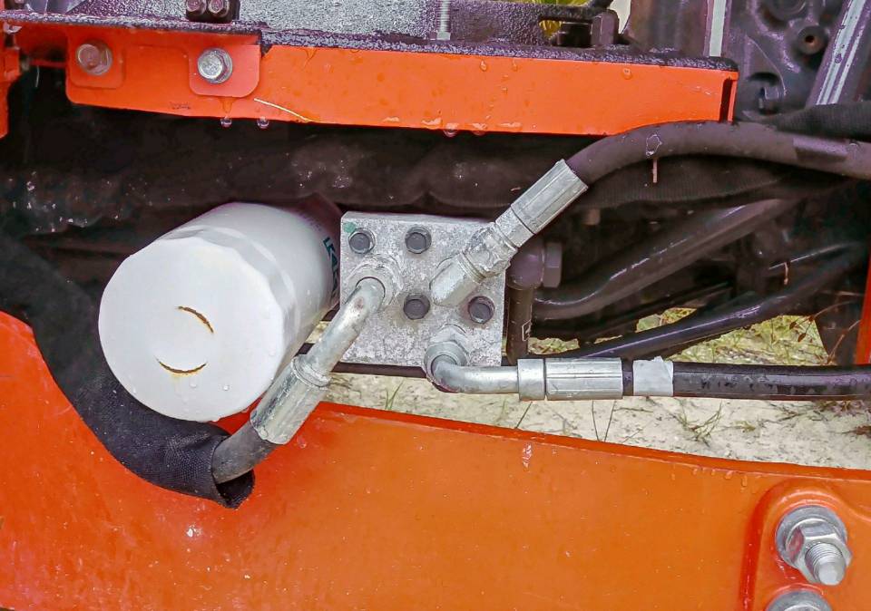

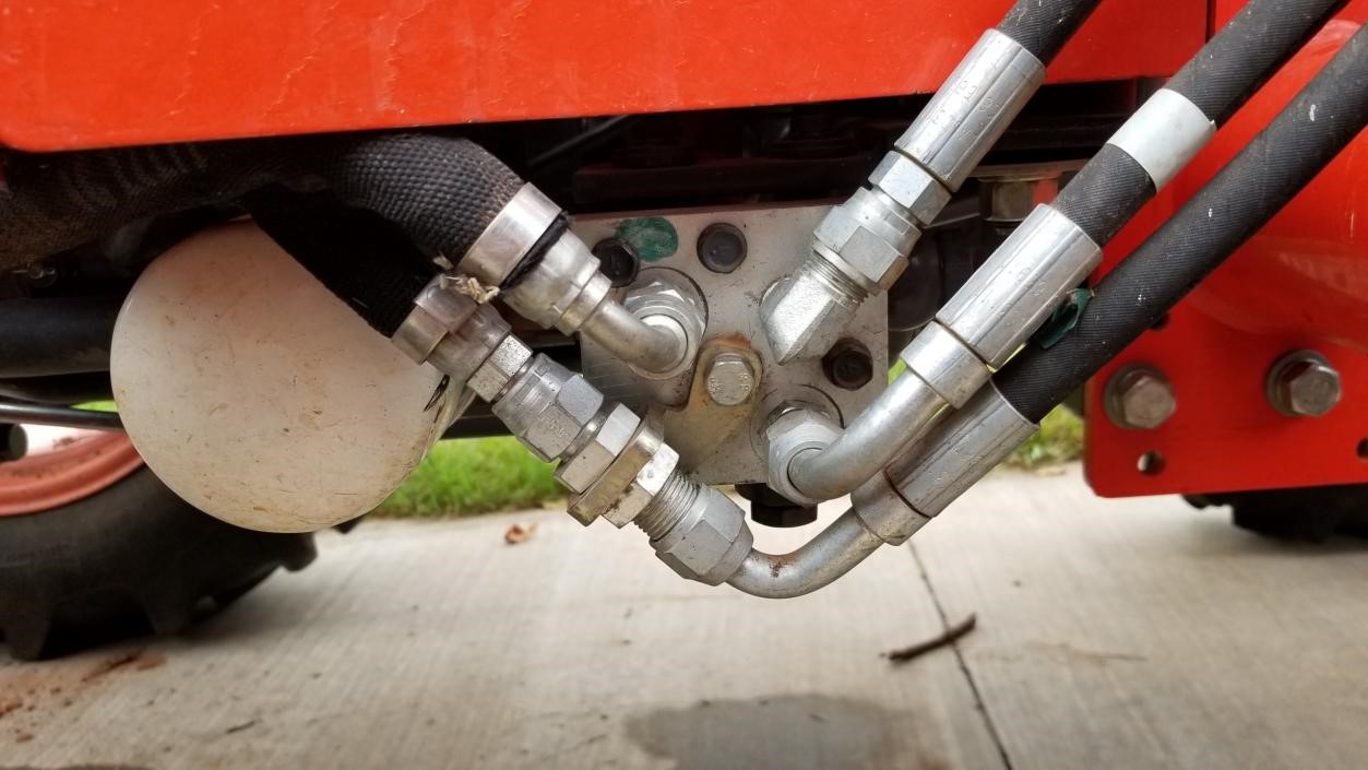

The pic I posted is not on an MX4700, as I noted, it may be similar. As I said to the OP, post pics of his and I'll tell him where he needs to break into his system. This is another reason I didn't waste any time modifying the pic with symbols and arrows, I can do that to his pic for clarity, as it may be different. Whilst I expect his to be the same, or very similar, it may not be, as I've seen some very "different" homemade takeoff blocks used to replace the OEM cover plate. Even if he has a homemade block, the ports should be in the same place if the OEM relief valve and base block is used. I don't recall if the pic I posted had a backhoe or remote valve, but I think they ran the tank line to the filler plug.

First lets make sure your block and 3rd fxn look like mine...
