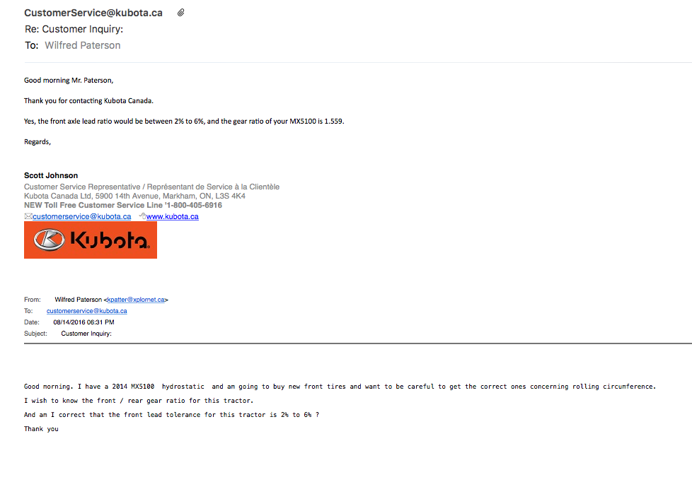

I have an MX5100 and went through this too a while back. I contacted Kubota. The gear ratio you are looking for is 1.559. I attached my correspondence which I hope comes through. Never tried attaching before.🙂
There is a formula to use with this ratio to assure you are in the appropriate front lead range.
Thank you for the information Hoobie!!
