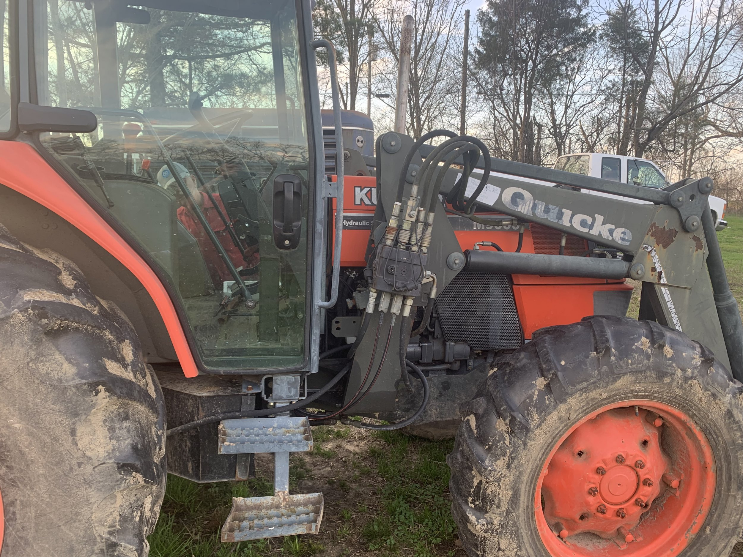

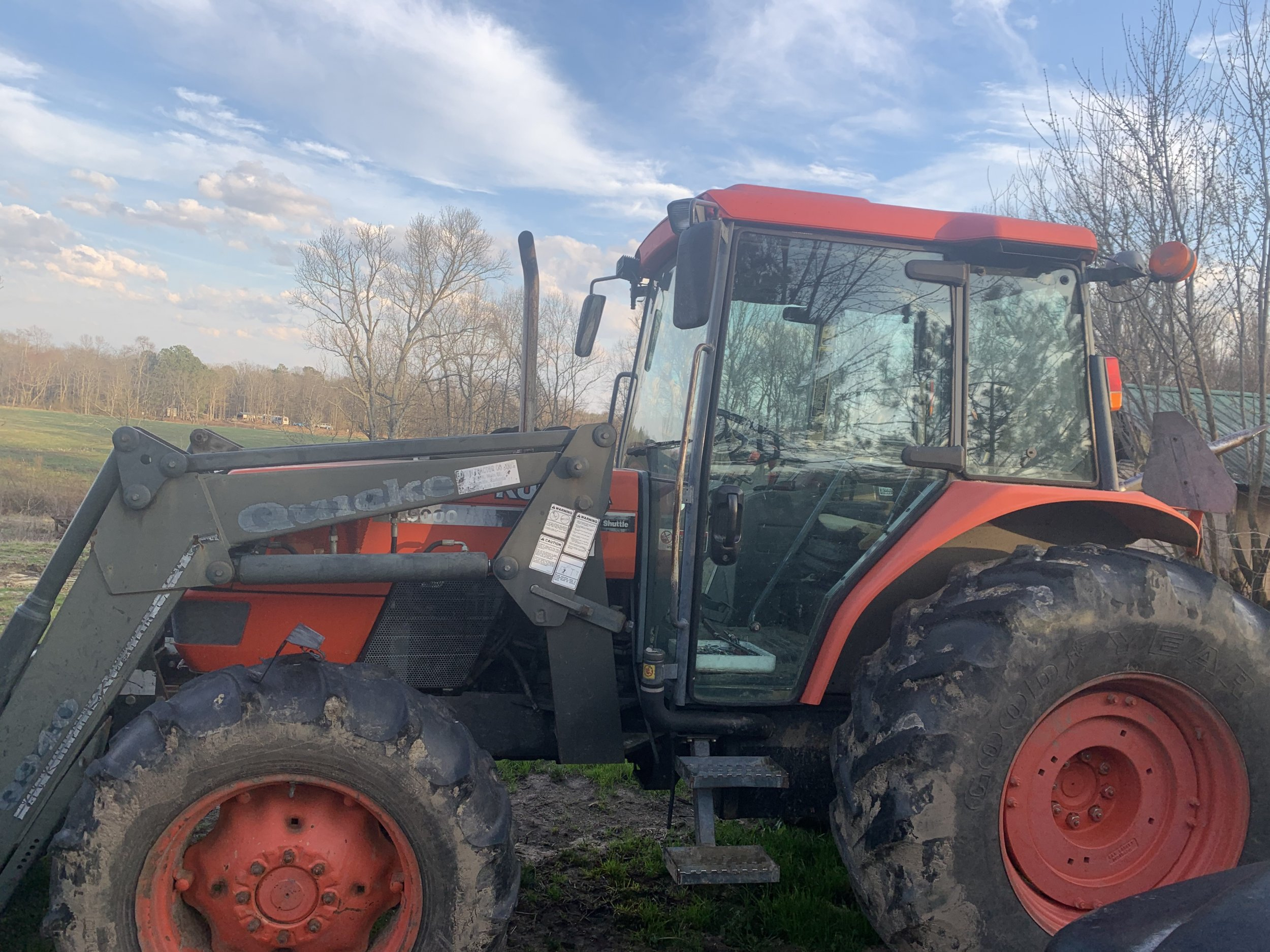

My tractor is a Hydraulic Shuttle cab tractor. It has the Quicke Q940 loader. The loader arms actually cover the frame rails where serial number is. From what I have read, it’s between 2003 and 2005. The hours are approaching 2000. I bought from an older gentleman that bought it new and used it for doing his own hay. I’m thinking possibly exhaust stack at some point may have been bent. The muffler actually still looks good, but elbow that turns up is broke. After pricing complete muffler, I’m gonna try to repair. From what I can tell it’s mechanically good. He kept oil and filters changed himself. I was happy to see air filters looked good. I’m a heavy truck mechanic by trade. I know first hand what happens when an air filter comes apart on a diesel. It has original tires on the rear. They are ready for replacement. Inside cab is reasonably clean with exception of seat bottom. It needs a little TLC. Paint is faded. I would love to paint it. I actually was looking for a 50 to 75hp 4 wd with loader. A buddy has a M6800 he bought new. He said you better buy this or you will forever regret it. Thanks for all the replies. I am still trying to figure out what I’ve bought and what I need to do to it. I just ordered a Service Manual. He the Twins look Great!

Not overly impressed with any loader but the OEM Kubota actually. Far as tires go, you better be sitting down when you price them, I just replaced the front and rears on my open station and it was just north of 5 grand. I replaced both the front and rear because the 'lead-lag' ratio on a FWA tractor is critical and you mess that up, you'll have driveline issues.
I don't care who owned it or what they changed (fluids or filters), I'd change EVERYTHING again to establish a a maintenance baseline for myself. Never seen ANY air filter come apart on any diesel but I've seen them clogged up. I own a Class 8 tractor and grain trailer (International Eagle conventional with a 3406 and 13 speed with a Timpte hopper bottom).
Both mine are faded, don't attempt to paint it as the orange color is in the plastic fenders. You could paint the hood and front guard but that is about it. 'Mary Kay Pink' is what all Kubota's eventually become. Enjoy it..
2000 hours is nothing on a VTE engine if maintained properly. I'm at 6 on one of mine with zero issues and mine get worked hard.
You could have downloaded a Service Manual and owners manual for free on Kubotabooks. I did, not that I need it as I have no issues with mine plus I have an excellent dealer close by, they even deliver any filters or stuff I need right to the farm.
I'd wager he bent the stack by moving a round bale in the bucket and it rolled back on the stack. I don't do that, I use a round bale spear.
My open station has the optional and rare down exhaust pipe so no stack on it at all. The down pipe was offered for dairy farmers where overhead clearance was an issue. I prefer it actually.
Does the AC work? If not you can PM me as repairing it and maintaining it is quite involved. I prefer not to get into that on the forum.

Looks like it's hydraulic shuttle from the photos? I'd use Kubota oils and filters only for that.
With the turbo and cab I think straight pipe would be fine.

It's sort of the OEM loader anyways. Loaders like the Alo 940 were sold in Kubota orange with Kubota decals and serial plate in some markets. 900 series were self levelling and 700 non self levelling.
Here's an M940 loader on an M105.
Not really but I won't argue. Kubota makes their own loaders, not Quickie. Least not in my market. Mine were built in Georgia. 105 and an M9 are 2 entirely different units.

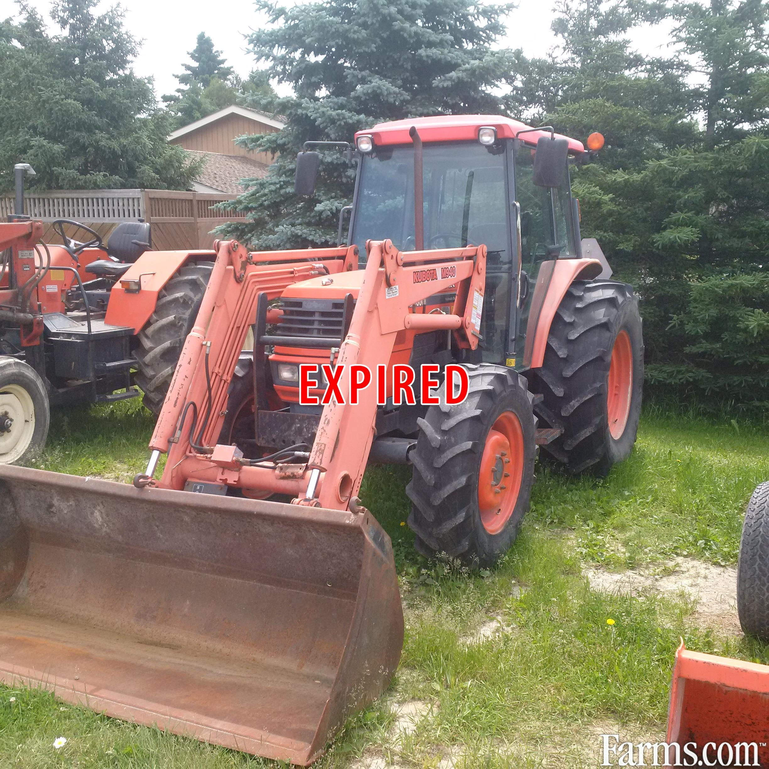

M940 could be found on an M9000, random pic I found. Alo makes OEM loaders for almost every color. (CaseIH, NH, Fendt, Kubota, MF, Valtra etc)
