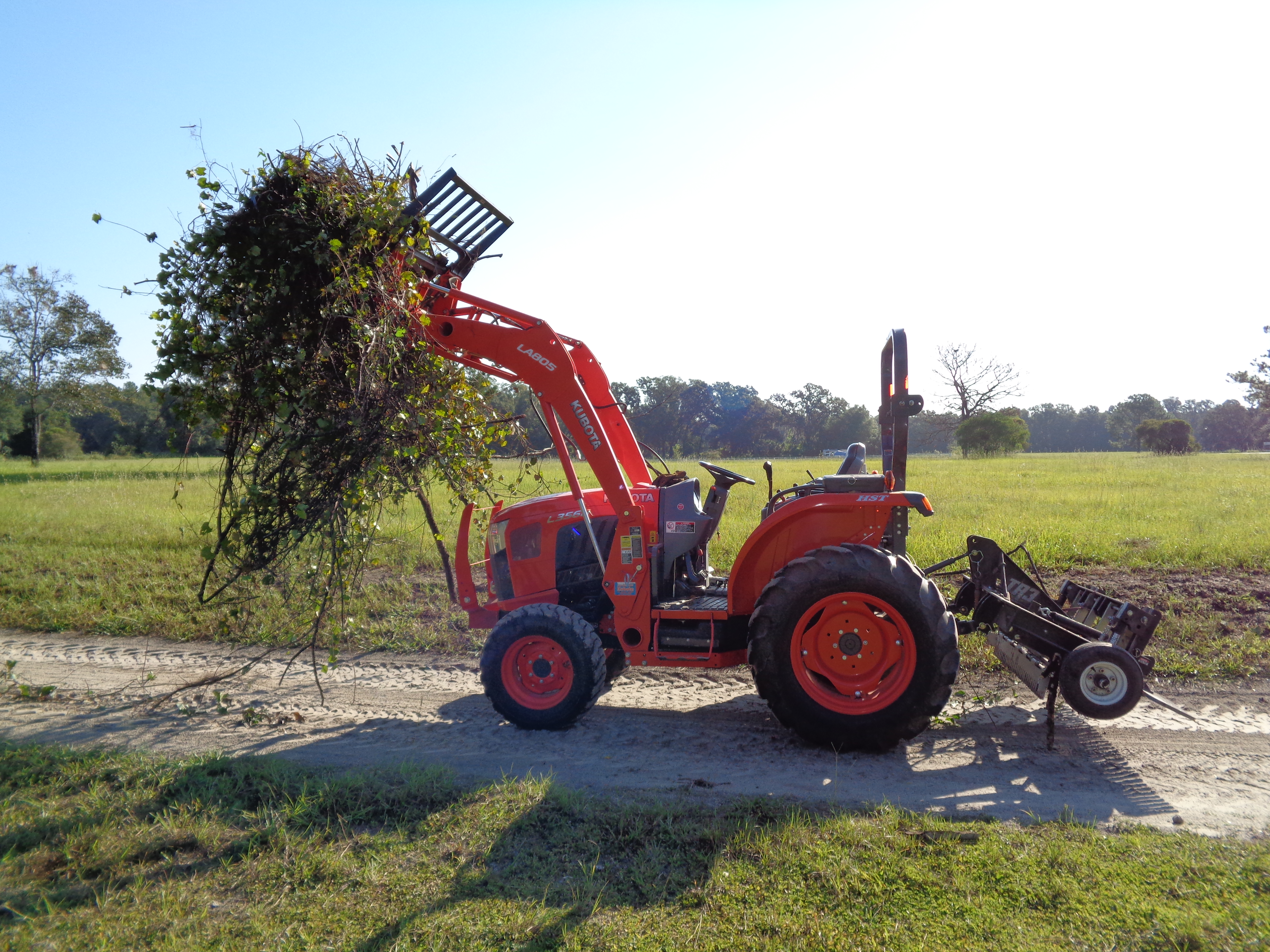

Tractor shoppers usually underestimate the tractor weight and horsepower needed for their applications. You, perhaps, are considering tractors two increments heavier and more powerful than essential. But better a tad heavy than underweight.
VIDEO: Kubota MX Series VS. Kubota M Series - YouTube

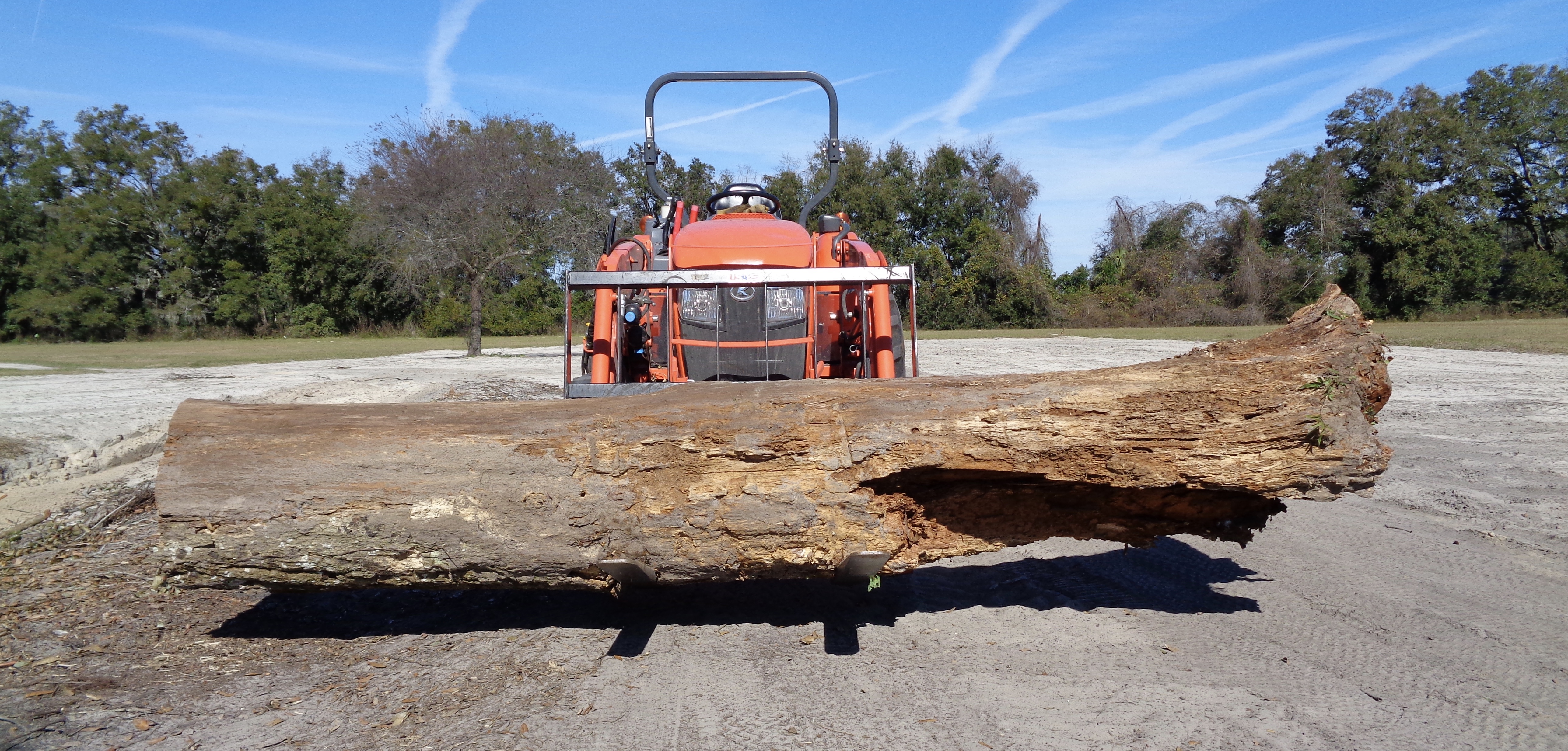

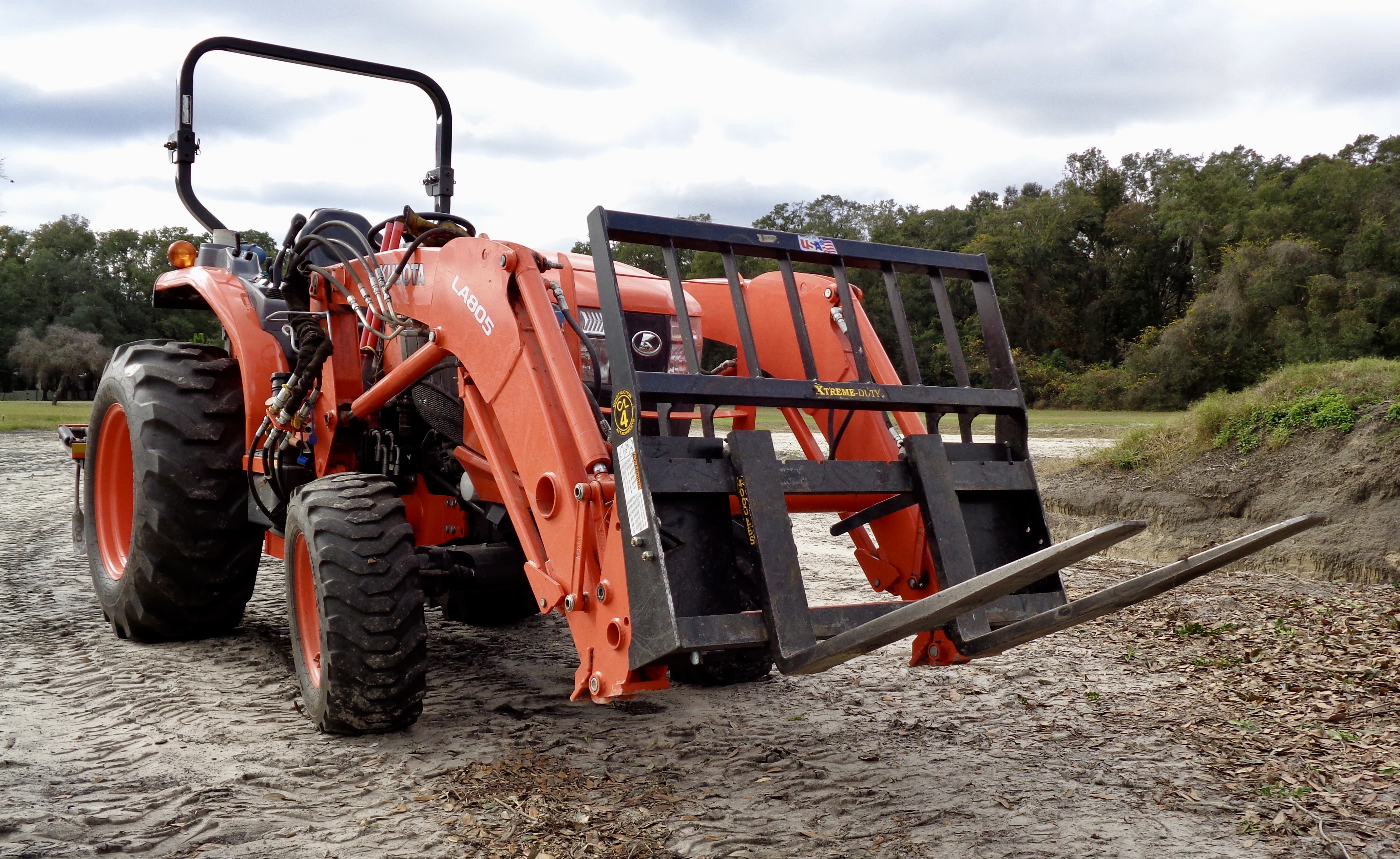

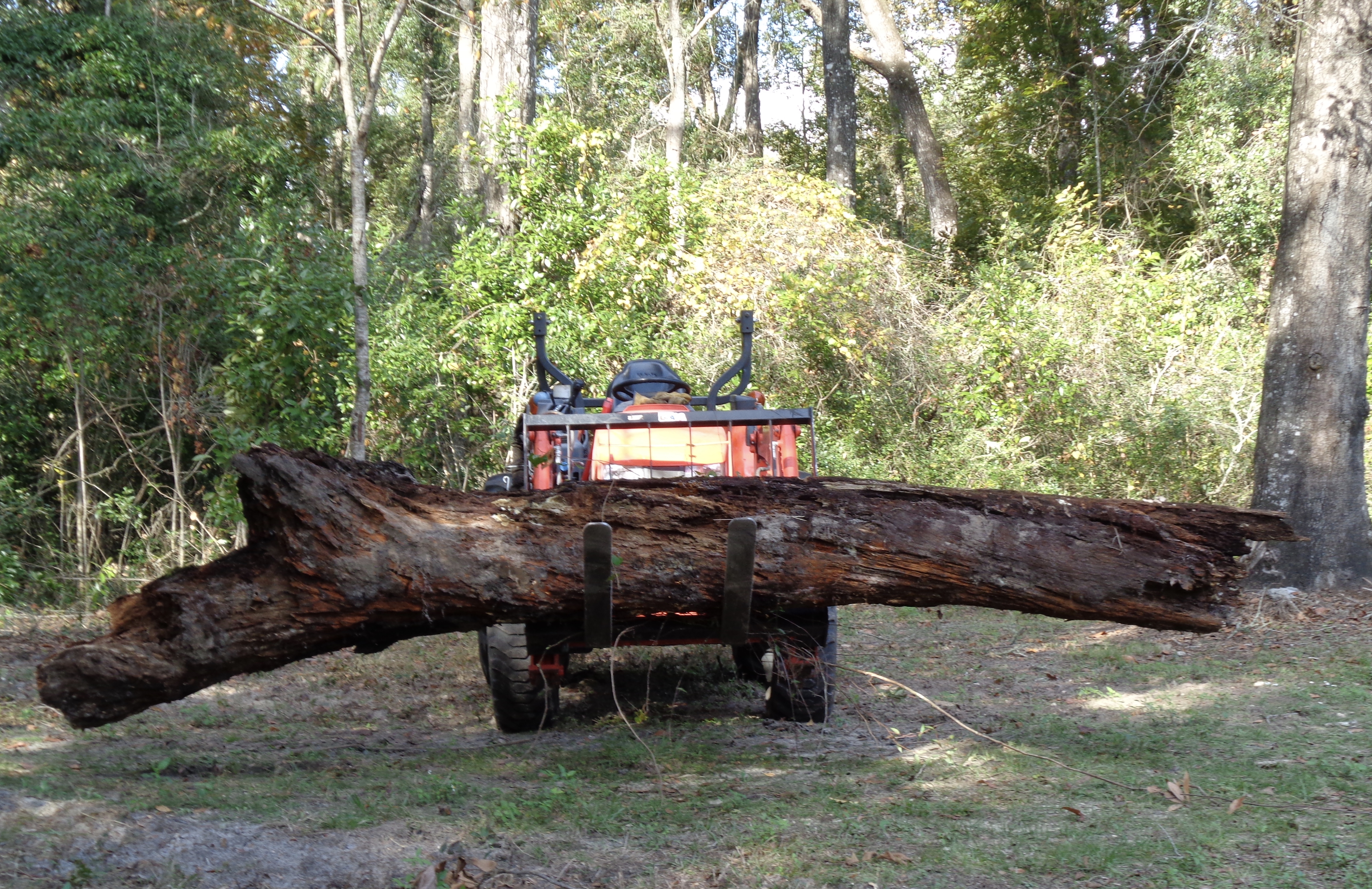

I think a new or used Kubota MX model, 4-WD, 3,800 pounds bare tractor weight, and 54 or more horsepower is ample for your needs. 54-horsepower or more will operate a 72" Bush Hog or rear Snowblower with ample margin. Loader on an MX will lift 2,500 pounds, which should be ample for your applications. With SSQA Pallet Forks you can move tree trunks and brush on the Loader. No 3rd function front remote necessary.
PHOTO #1, #2, #3. #4.
I LIKE TO KEEP EVERYTHING TRACTOR RELATED SIMPLE.
VIDEO: Kubota MX series walk around and features by Messicks. | MX48 MX52 MX58 - YouTube
LINK TO KUBOTA WEB SITE: https://www.kubotausa.com/docs/default-source/brochure-sheets/mx5800.pdf?sfvrsn=1c71be0c_4
Land Pride, 100% owned by Kubota, makes Loader grapples.
LINK TO LAND PRIDE WEB SITE: Grapples | Land Pride
The MX series has been in Kubota's lineup for years. There are plenty out there used. MX series are NOT available with a cab.
Rear hydraulics replace manually adjusted Three Point Hitch fittings. Many feel rear hydraulics are almost essential when operating a rear/angle blade and convenient when drawing a Box Blade. On a snowblower, two pairs of rear remotes allows you to rotate the snow exhaust left to right and direct exhausting snow up or down. I do a lot of tractor work. I have one pair of remotes on the rear.
Rear mowers and rear snowblowers operate off the tractor PTO. Disadvantage: You have to look to the rear regularly. Snowblowers are for DEEP snow. Most use the FEL bucket, a snow push box or a rear/angle blade to move MODERATE snow.
