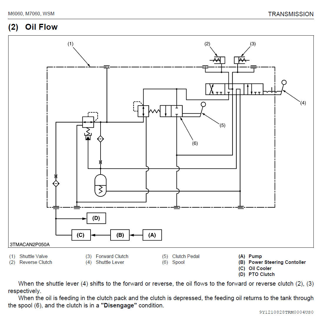

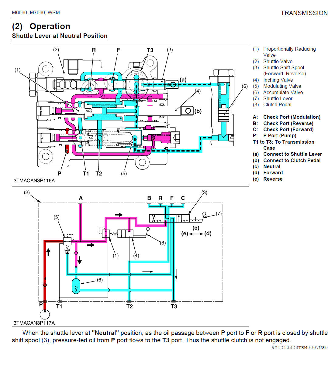

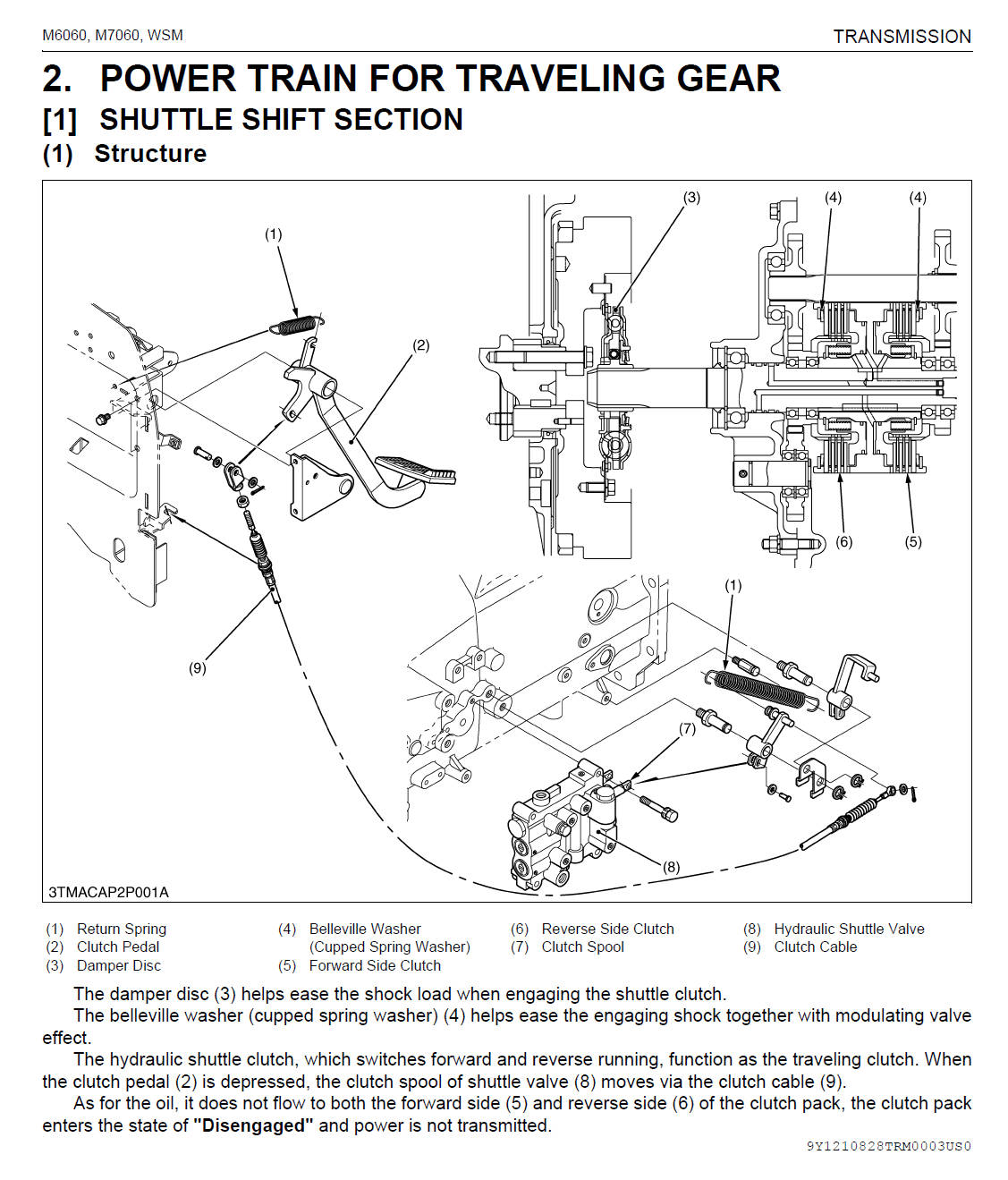

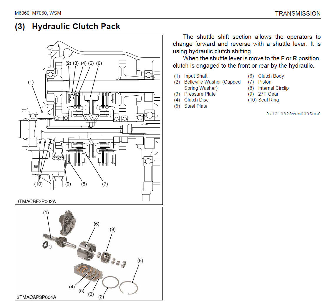

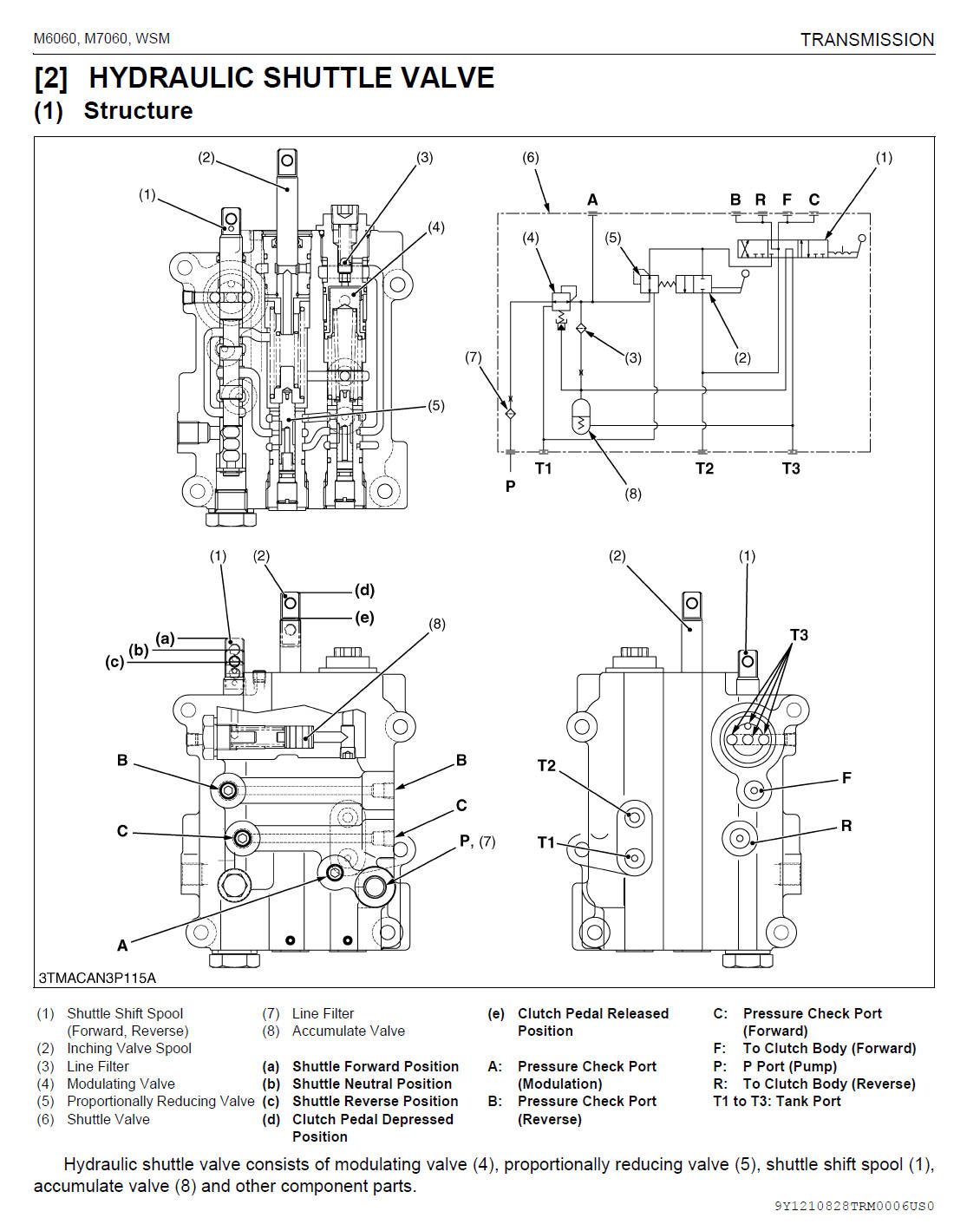

Not using the right oil, or old oil not warmed up.
Pretty sold system not to hard to diagnose
WSM MANUAL 2019

Only thing not called out in the diagrams is the static pressure adjustment screw which is on the front of the valve (facing away from the main gearcase. It's bullet proof system but there will always be a lag in lockup because it's a hydraulic oil actuated clutch system. Consequently, when it's frigid outside lockup will be slower than when it's 90 out, but then when I plow snow with my M's I always warm them up in the barn before moving them (high idle) while I have a cup of coffee and my hot oatmeal.
I would not run anything else except a hydraulic shuttle and at 6K and 2500K respectively on my units, with zero issues, I'd say they are very reliable.
