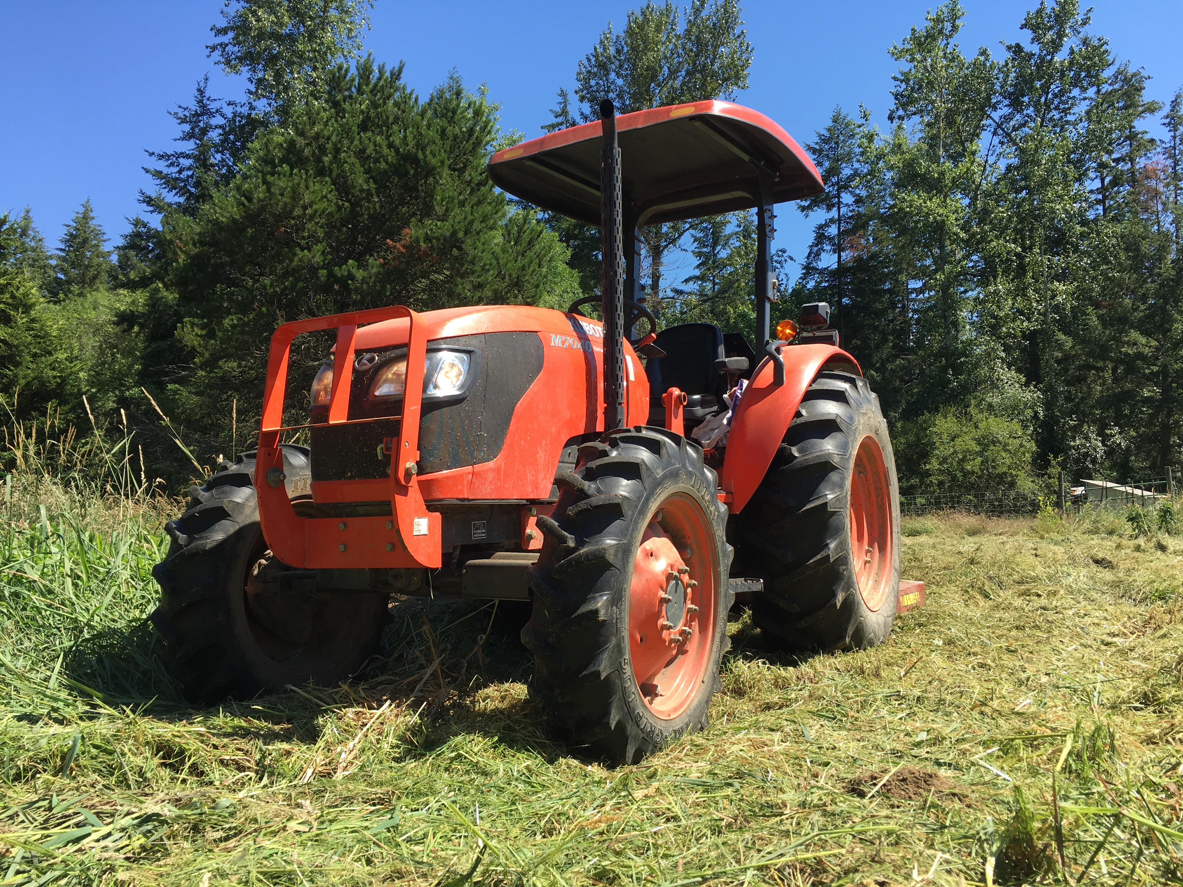

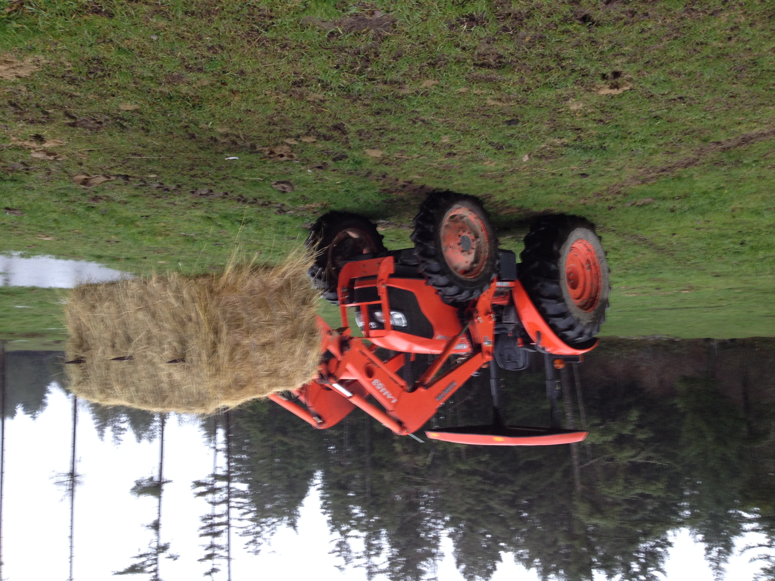

My father has a Kubota M7040 and increasing has to use if after dark. This is mainly for putting out large round bales but also some occasional dirt work and other general farm chores. The tractor is an open station but has a Kubota fiberglass canopy. The canopy has two approximately 1" square tubes running forward from the ROPS supporting it which I plan to use to mount the lights. The tractor has one rear work light mounted on the left fender, and from the above linked threads I know there should be a wire under the right fender I can use to power the new lights. I plan to use an inline switch mounted somewhere on the right fender and then run a wire up the ROPS and to the new lights.
I will be doing the majority of the wiring/setup and then shipping the lights and wiring harness to my father for instillation. As a result this will all be done based on pictures and measurements. I know there are several members on here with M7040s and hope you will be able to help with some of my questions. I will take pictures of my progress and the final instillation to hopefully help anyone else looking to add some additional lighting.
Questions:
1. Does anyone have a picture showing the pigtail on the right side of an M7040? I assume I will need a short length of wire to run from the pigtail to my switch before running from the switch to the lights.
2. Does the ROPS have holes near the base and at the top I could run the wire though, or will the wire need to run along the outside of the ROPS?
3. I am working on getting measurements for the width of the ROPS and the length of the support bars, but if someone has a similar canopy and knows these measurements that would be very helpful.

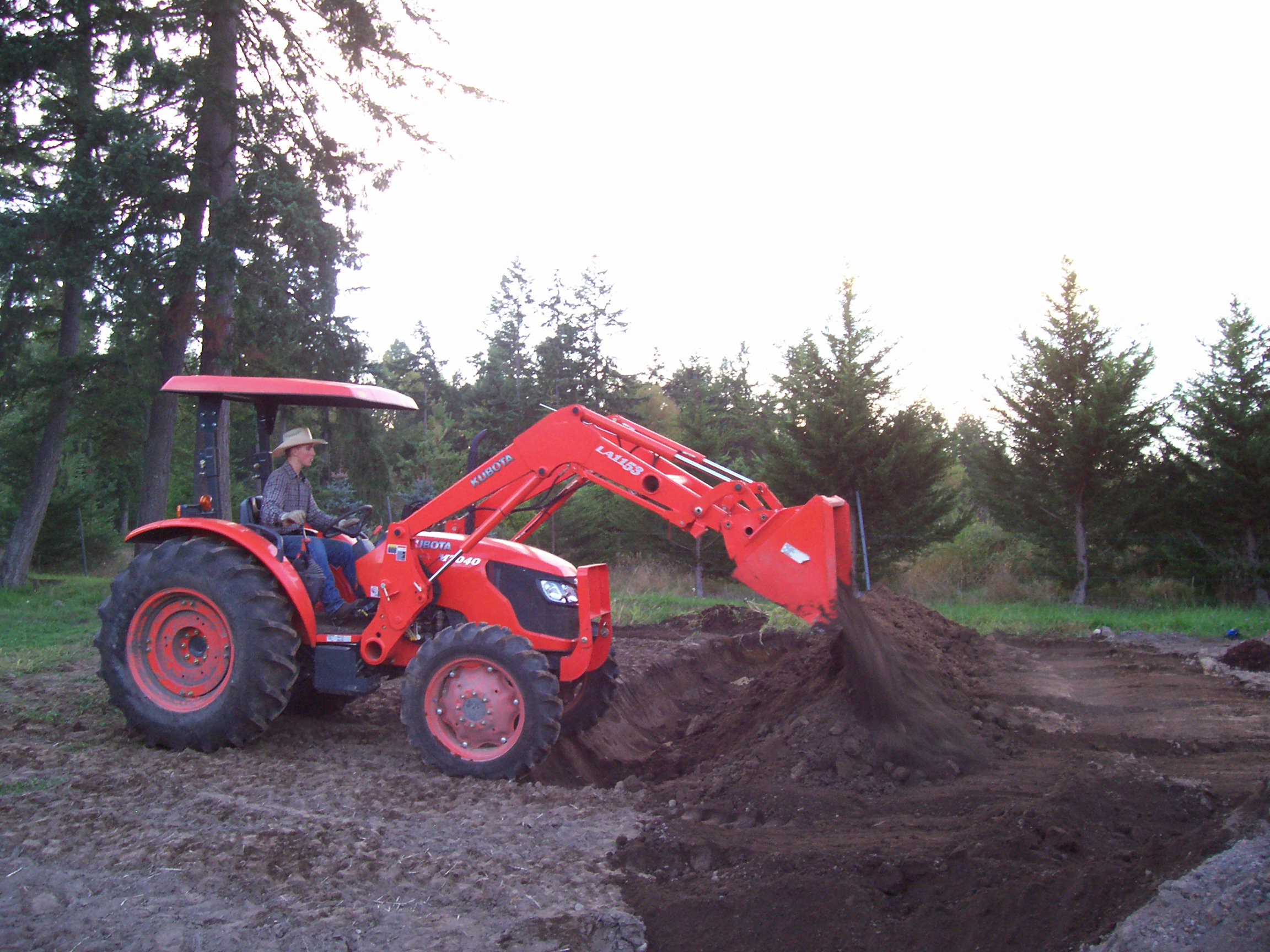

Attached are a couple general picture of the tractor and a picture showing the canopy and support bars. I will update with pictures as I go and then of the final instillation. EDIT: I cannot get the picture with the large square bale to upload right-side up... This picture was taken right before placing the bale in a feeder - the bales are carried lower when traveling.

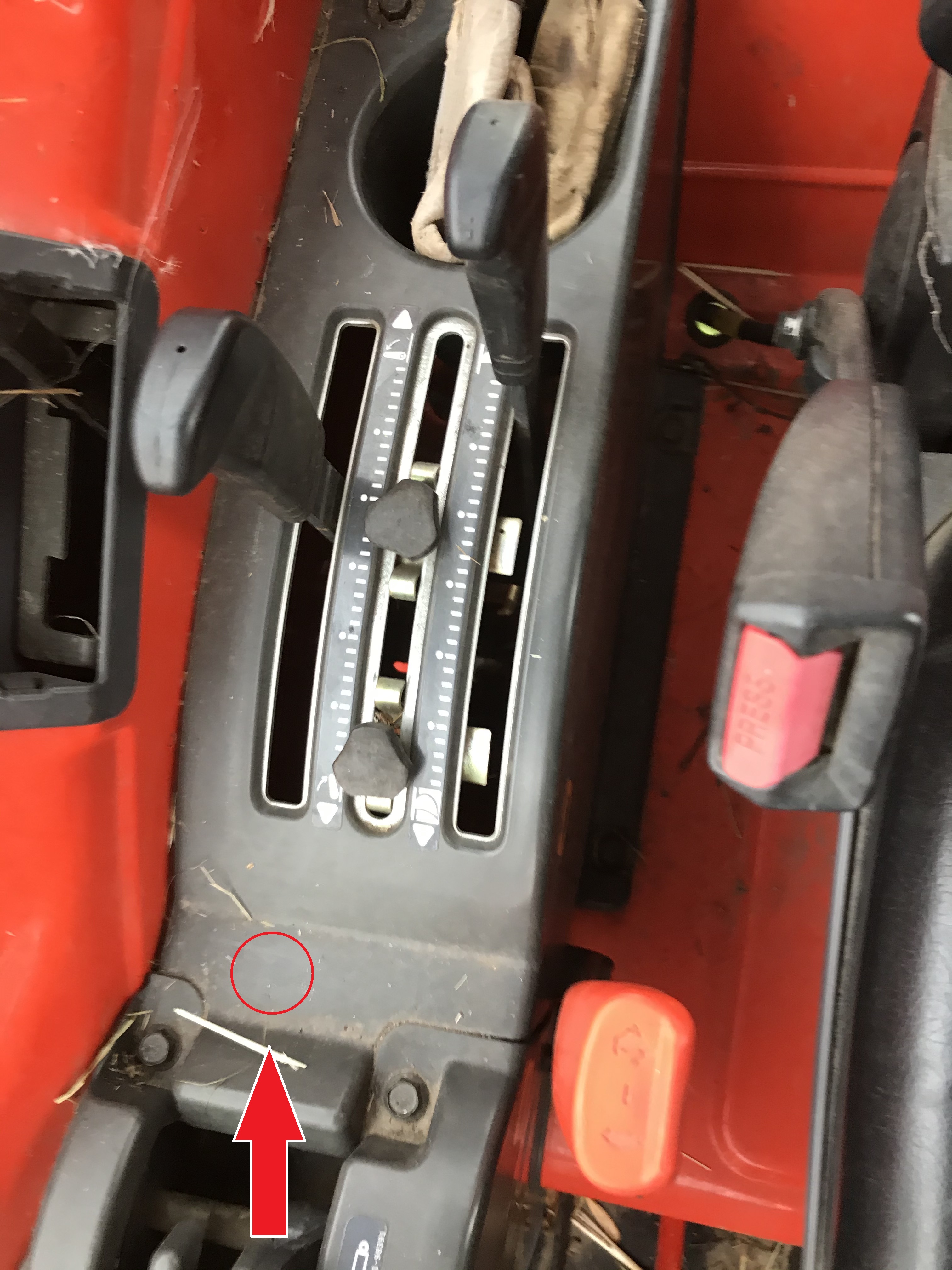

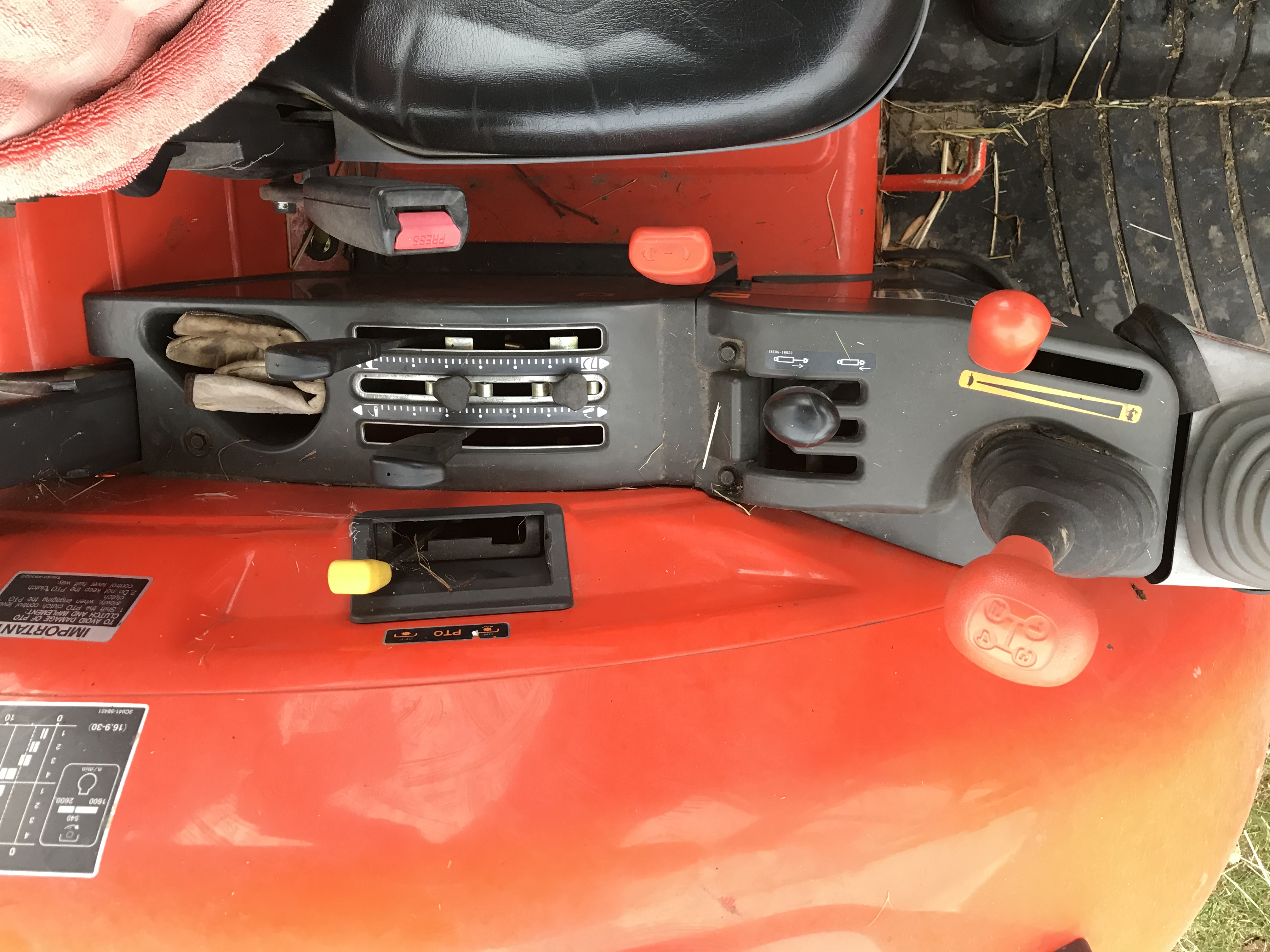

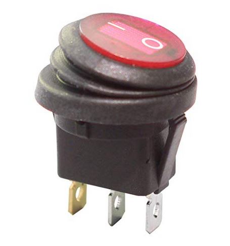

I plan to use a round 12VDC switch rated at 20amps like the one pictured (20mm mounting hole, snap-in design). Attached are two pictures of the controls and fender on the right side of the tractor. The second picture shows my tentative planned location for the light switch. I believe the switch would be reasonably protected in this location, the wires will be clear of both the 3-point hitch and the rear remote controls, and installation should be easy.
Any downsides to this spot or suggestions for a better switch mounting location?

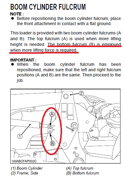

My comment has nothing to do with your question and if you already know about this feature on your loader great.
I notice you are using the boom cylinder fulcrum position "A" which is for greater lift height but will lift less weight.

Dave,
You are correct about the boom position we are using. The primary use for the tractor is handling round bales and using pallet forks to access a storage loft, both applications where we utilize its maximum lift height. On a couple occasions when doing serious dirt work or moving a 3,000 lbs pallet of wood pellets we switched to the power position but generally keep it set for height.

I run my FEL on the height position all the time. Reduces stress on the loader frame.

Any input on my proposed switch location? Your M9540 is pretty similar and also an open station model.

Looks like a good location to me. Hopefully the switch is an "all weather" switch so water won't hurt it?
/ Kubota M7040 LED Worklight Addition #8
Correct, it is "waterproof" and marketed for boating, so whatever rain gets on it should be fine.

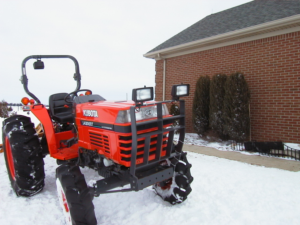

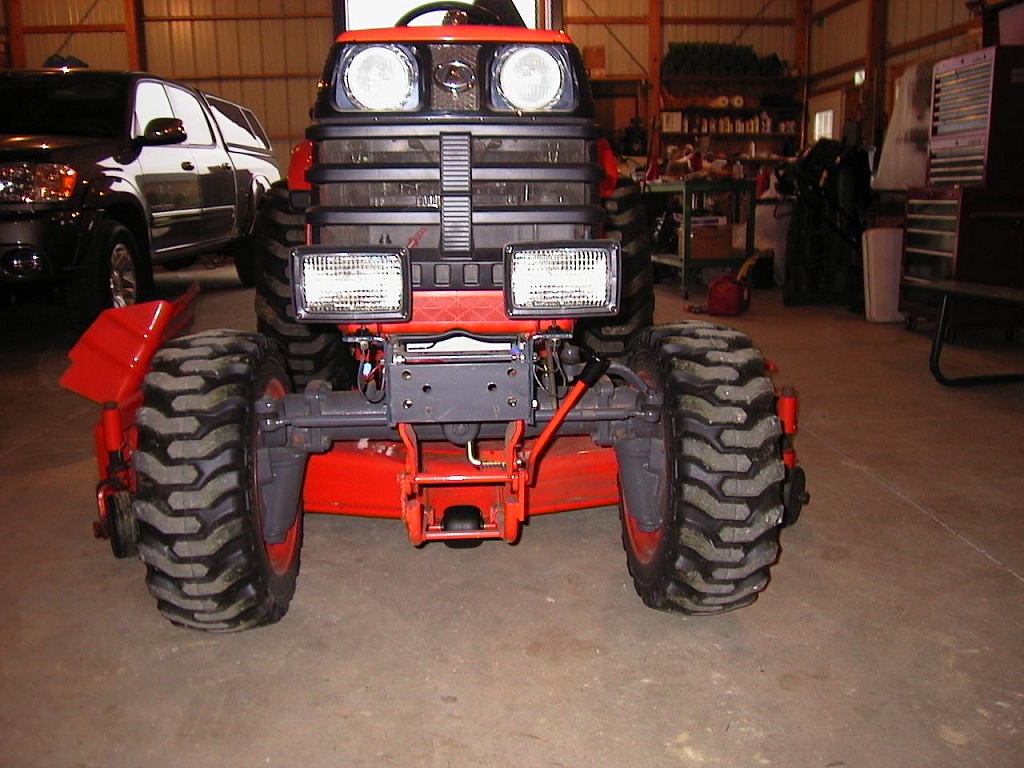

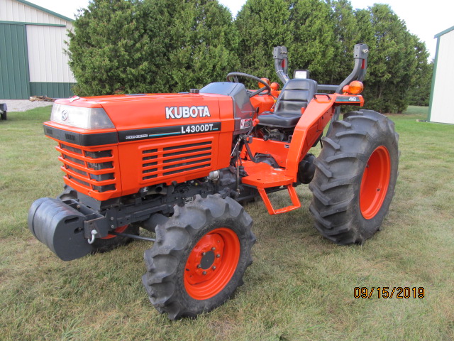

For your consideration here's how I mounted some lights. I ran what I recall as one wire up to the light with a switch in the light and the ground there. You can see the switch in each of the lights on the top. This seemed like the easiest way to me. Just an FYI. Here are the pics.
Let me ask if you are running LED lights?

Six, what year is your 4300??? She's a Queen!!!!
/ Kubota M7040 LED Worklight Addition #15
That's an older photo. Here is a recent one and it still looks almost as nice.
It's in great condition but I think I'm going to sell it and replace with a cab model. It's a planter tractor, in that I pull a six ft Brillion seeder with it. Long days make a cab a better idea. If you see a 40ish HP Kubota or Deere for sale with a cab and in exc condition that is 2013 or older, let me know.

That's a beautiful older Kubota. Still has many, many hours life left. Someone is going to get a great tractor.
View attachment 632275 . .View attachment 632276
sixdogs,
Those are some very clean light installs, very nice!
And yes, I am using LED lights. The ones I have would be very hard to directly add a switch - I'll look up the details and post them below.

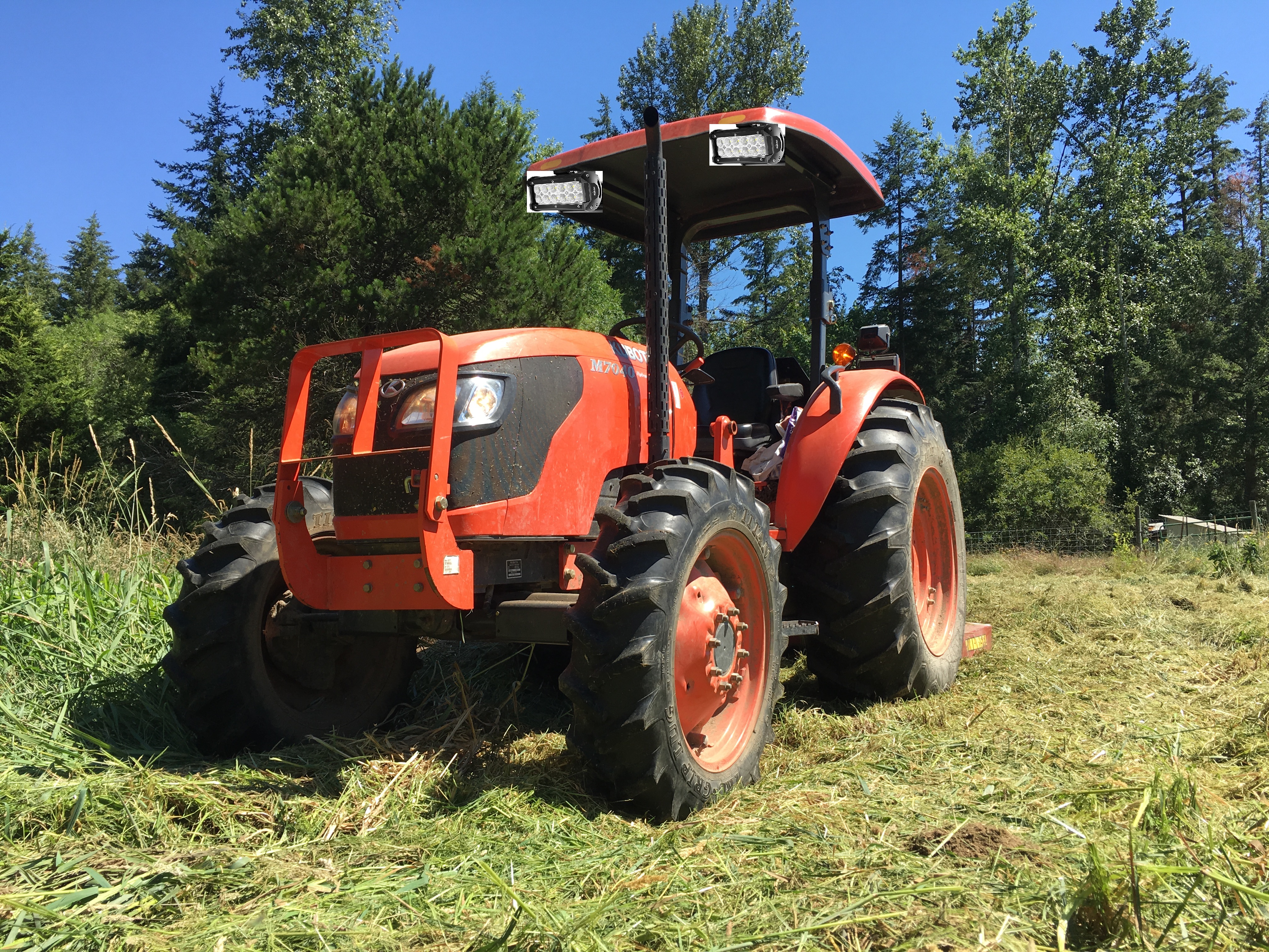

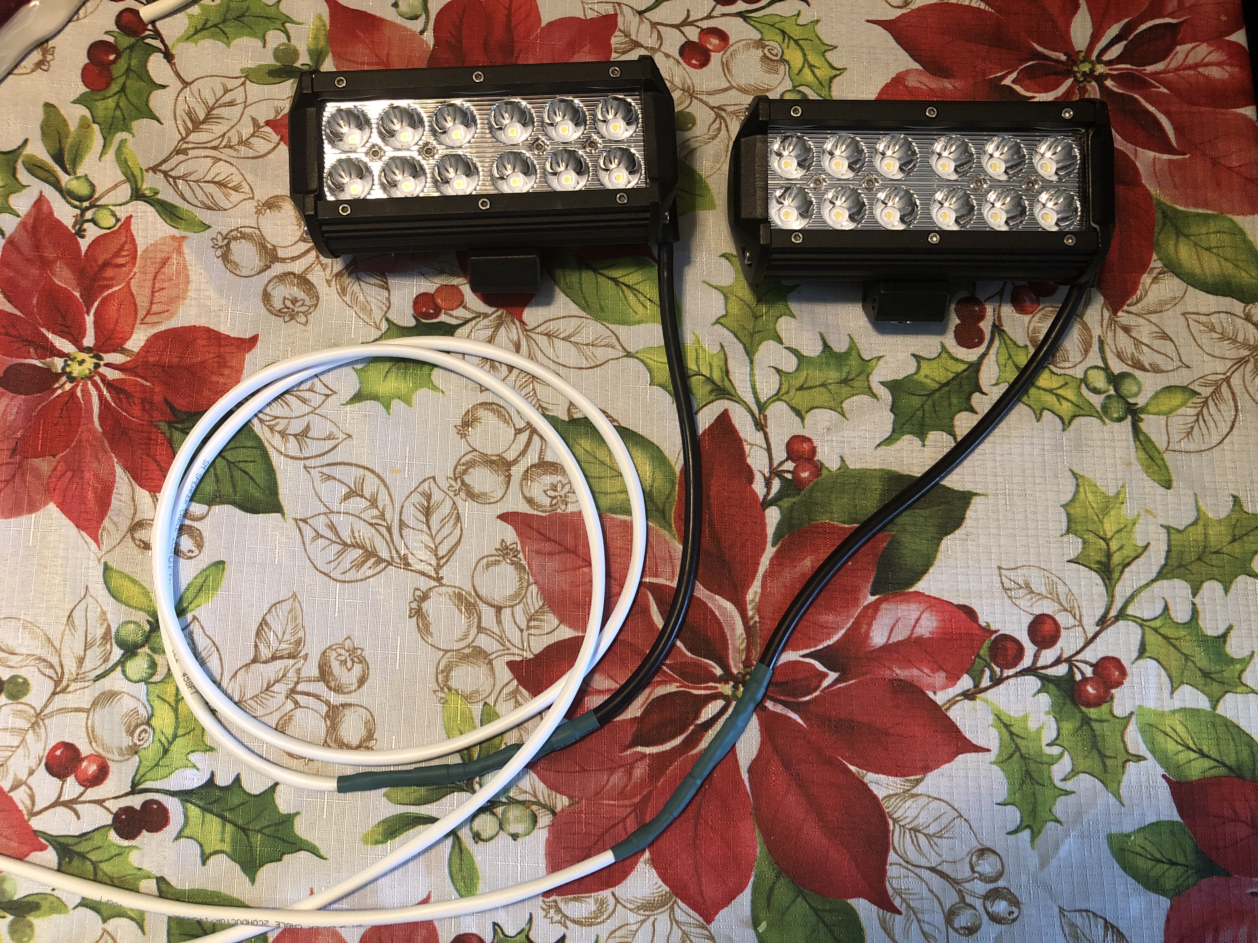

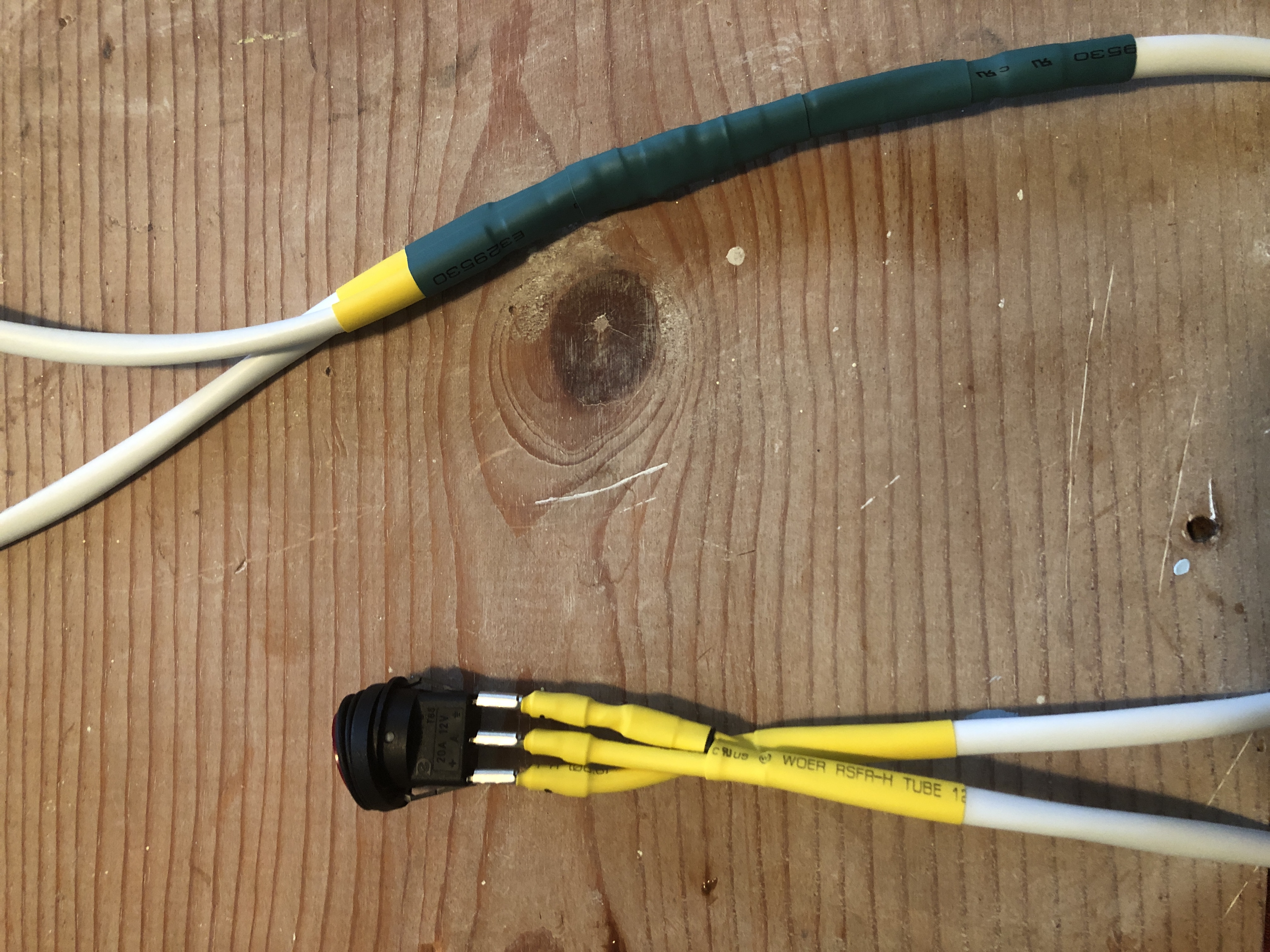

I got the lights all wired up and shipped off to my father. Sometime after Christmas I should get an update on how the installation goes and hopefully some in-use pictures.
For the lights I used inexpensive LEDs from Amazon. They are in the 6 to 7 inch size and advertised as 36W each with good reviews. Attached is an image of the lights with my wiring attached. Also included is a picture of the switch which also shows the split from a single wire running up the ROPS to two wires to run out to the front of the canopy, one for each light. I left about 36 inches of wire on the power side of the switch to attached to the tractor pigtail and ground. All the wiring is 14 gauge stranded I already had from previous projects.
Let me know if anyone has questions, and I'll update with finished pictures once I get them.
