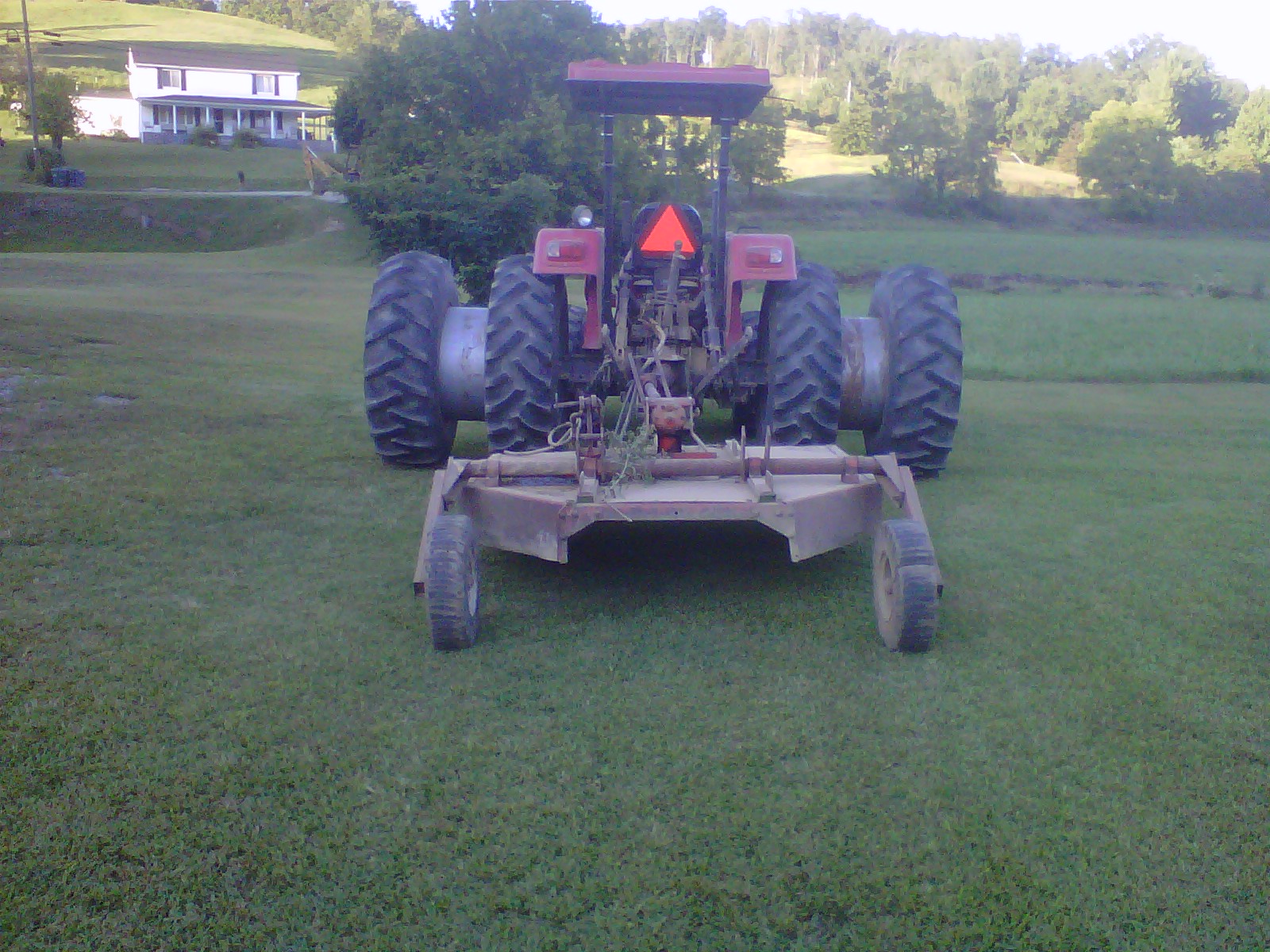

yeah its a wide setup, a little over 12 feet wide, thats the duals that will be on my 7040 this spring

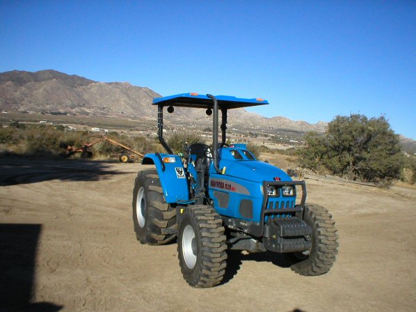

Thats a good looking setup Mtnview, I have to say, I like the blue Mahindra, never saw a blue one before
Thanks, to the best of my knowledge, it is the only one. They are even aware of it at Mahindra corporate. :laughing: One of these days when I get tired of the red on my 3215, I'll paint it also. ;)

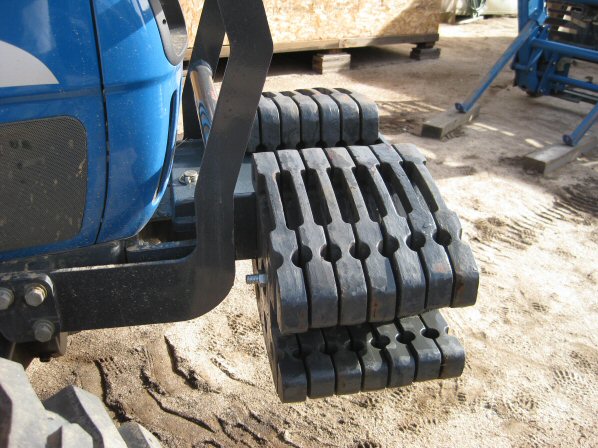

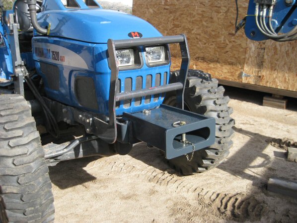

I built a weight bracket for the front of my M9540 and can carry 650lbs of weights. I never brush cut with the loader on. Too much bulk.
Here's some pics of my bracket and weights. The weights are from a White tractor. Yes,,,,,, I've painted the weights since I took these pics.... ;)
