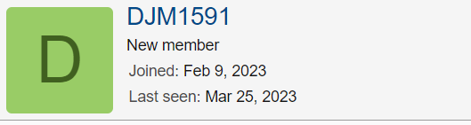

It appears DJM1591 hasn't been on this forum since March 25, 2023
