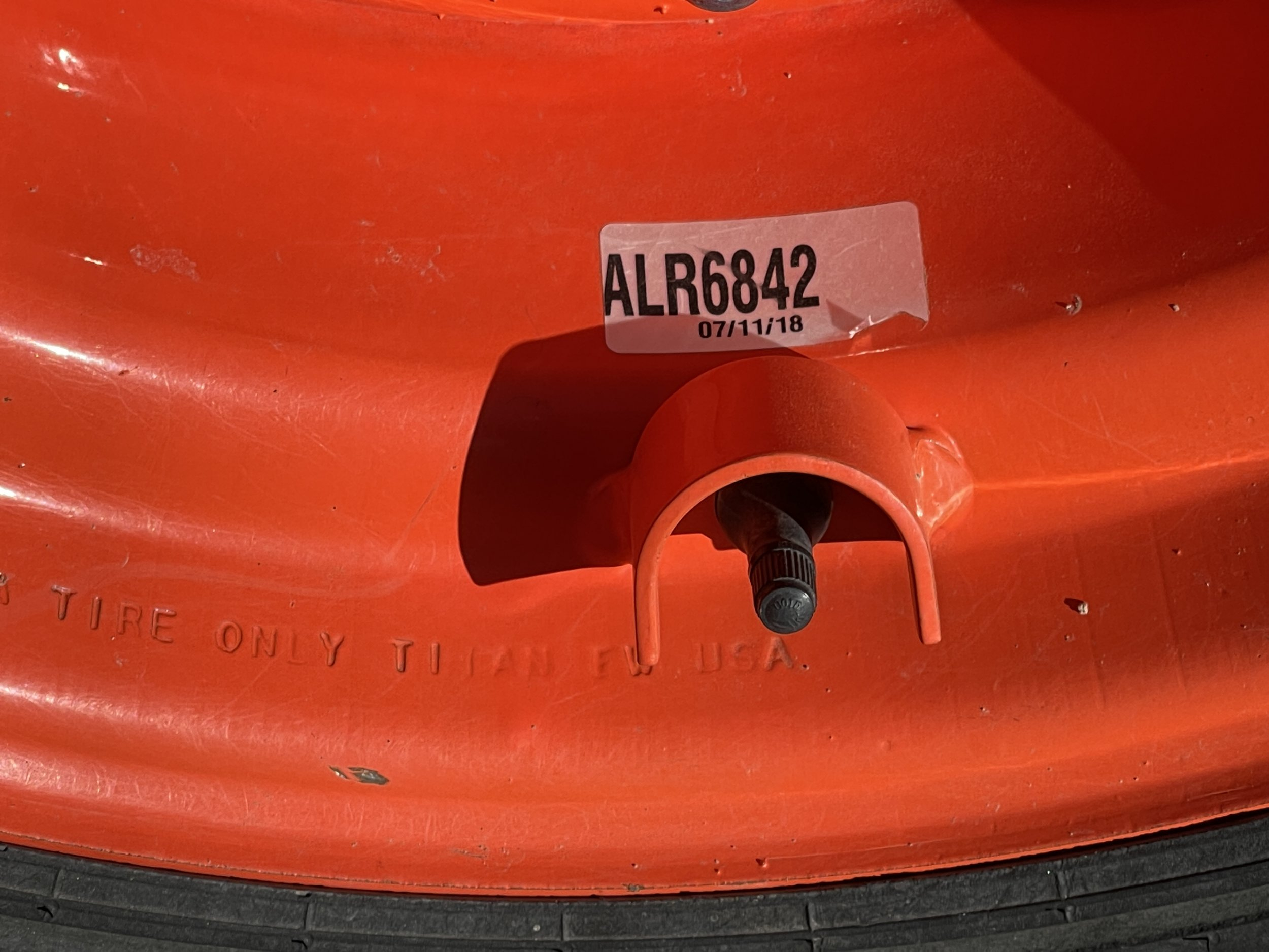

There are metal protectors for the valve stem on the rim. But when you don't notice that the tire is flat (easy to do because the sidewalls are real stiff and the tire doesn't look flat even when there's no air in it), the bead unseats and pulls the inside end of the valve stem inside the tire. I'm a slow learner, and it's done it twice now. I'm gonna take a chance and order these.
Would be nice if they weren't "half assed" pardon the pun.. LOL... I'd rather have to buy a straight air nozzle and know they were fully protected than this half round protection leaving the exterior facing surface wide open for damage... I'm sure it helps reduce risk but why Kubota, why only half.... it could have been so much better.

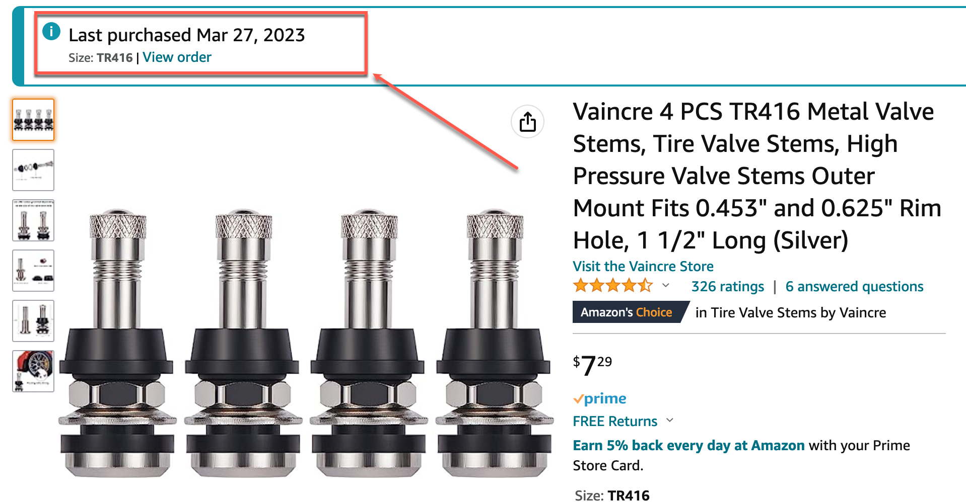

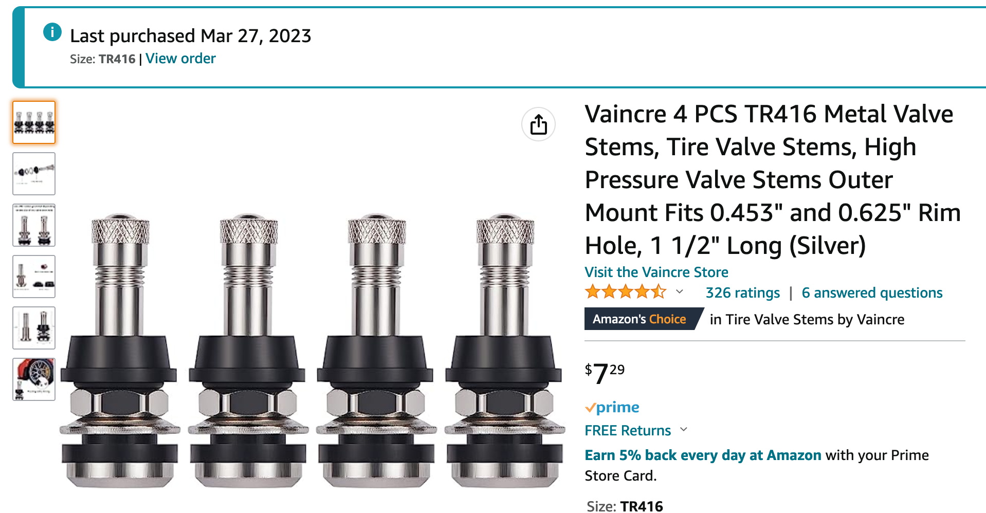

Most of the reviews I've read on these things (including the ones I just ordered) complain that the "rubber" sealing washers fail prematurely. I plan to install these with plenty of silicon seal in hopes they'll last longer. Worst comes to worst, though, with a four pack there will be two spares.

Went to use the tractor yesterday and noticed that the left front tire had leaked down again, though not as much as last time. Decided now was as good a time as any to figure out why, and a spray of soapy water confirmed that the replacement NAPA valve stem had a very slow leak where it sealed into the rim. I had those metal stems still sitting on the bench, so I pulled the wheel, used the FEL to break the bead and hold it down out of the way, and installed the new stem with a healthy dose of Three Bond sealant to keep it air tight. Would have been nice to have some wrench flats on the valve stem to keep it from turning while the nut was tightened, but had to make do with a pair of needle nose Vice Grips. Something to keep in mind if you're shopping for replacement valve stems.
