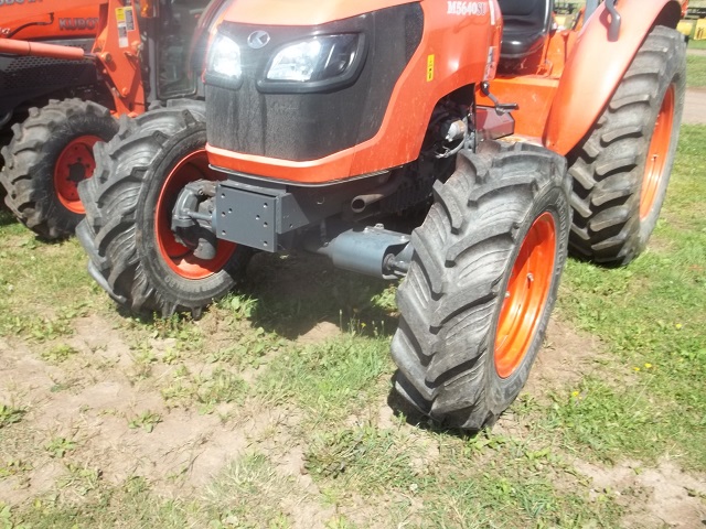

Went out and took a look at it today. Tractor and box blade (Woods BSM84). I didn't see any issues and liked it.

It looks nice Gordon. It would be a great tractor for you.
/ Kubota M5640SUD ???? #17
Looks sharp, single remote and radio. SSQA and QA loader. Bucket looks like it's right off a skidsteer.

It is. He put it on just so I could test it. The actual bucket is at another location and has not been used. He had a pair of forks with a thumb on it. So there is a 3rd function diverter too.
