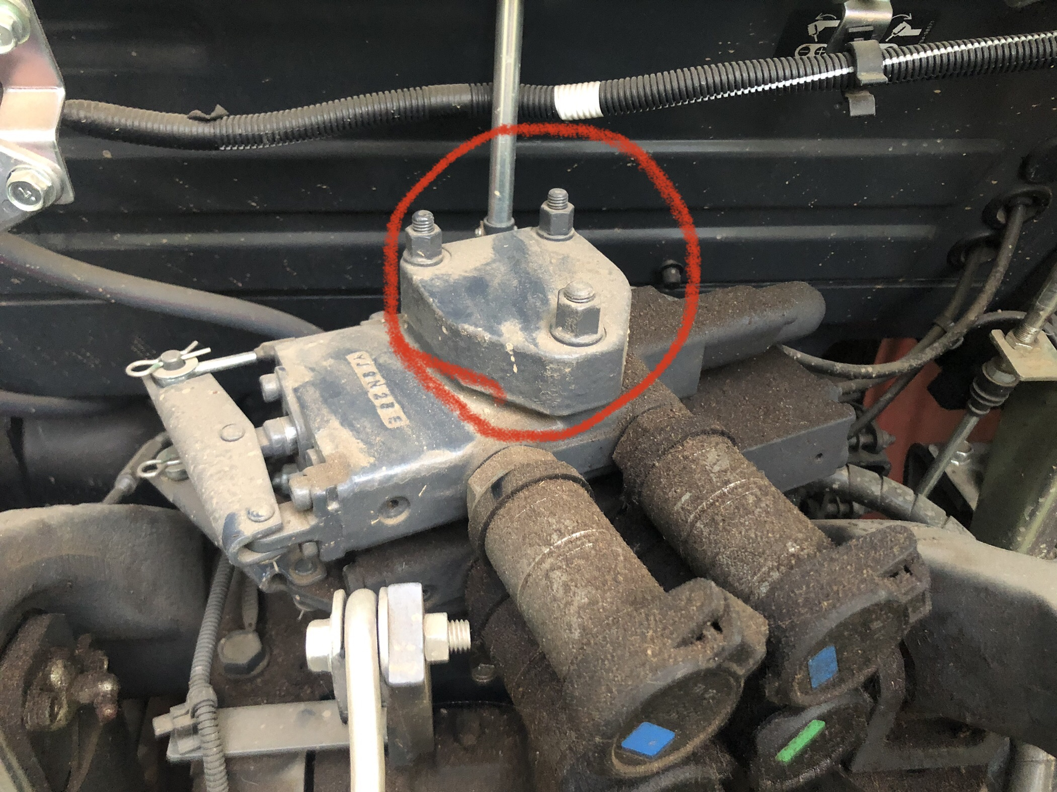

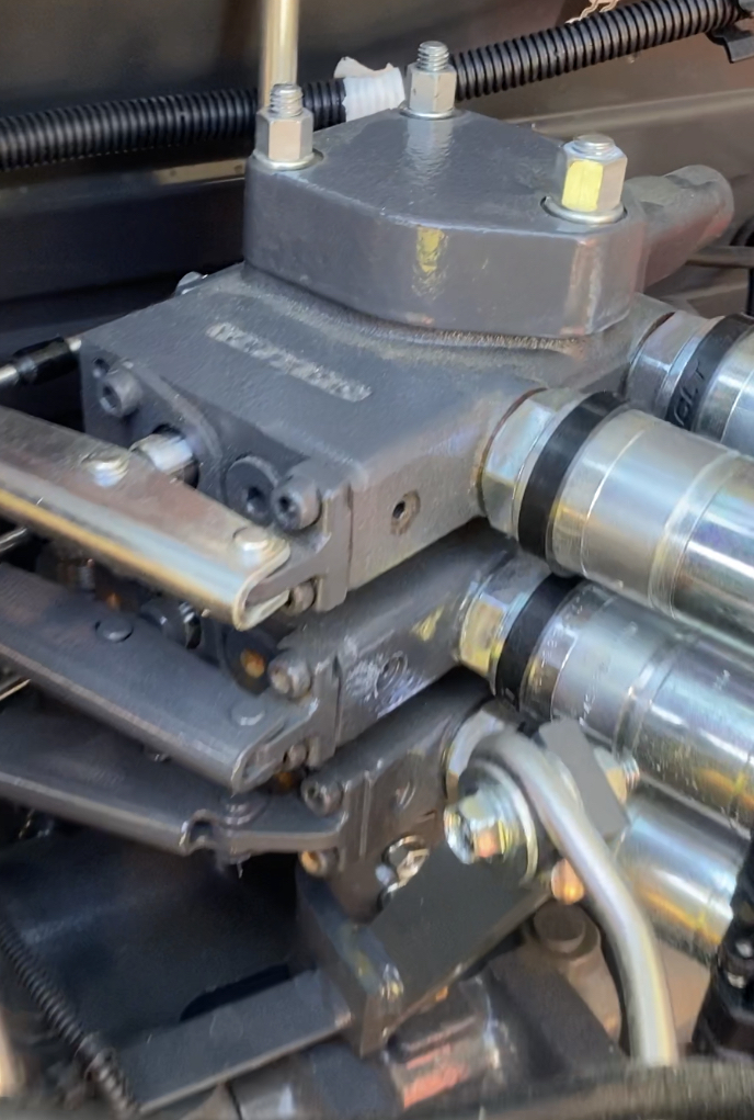

Had mine running for a little over an hour doing chores this evening and didn’t use the remotes so figured I’d see how mine felt. Does yours have the same block on top?
I’m pretty sure that’s what allows the flow to transit from one side down the other. It wasn’t too hot to touch but was unpleasantly warm. The top valve wasn’t hot but was warmer than the bottom which felt only slightly warmer than anything else back there. I think that’s just normal operation. I know when I use the remotes and need to swap implements/hoses they are warm enough I wear gloves for more than just protection against hydro pressure leaks. I didn’t feel anything that seemed to be moving/vibrating but it’s on a running tractor so not the easiest thing to feel for.
Yes same block on top. Just three valves, which should not change anything unless there is something up with the valve that the dealer installed? I haven’t put an infrared thermometer on it yet when hot, but am gonna get one to do so next trip out. I have multiple tractors and the trans fluid temp has never felt this hot on the valve body, trans casing, pump, hoses, etc. in any of the others. It is HOT….I agree with the logic of fluid passing through and the feeling of what I am calling a vibration for lack of a better way to explain fluid passing through or reverberations?? I just don’t get the noise and the temperatures. I truly appreciate you taking the time and value your input!

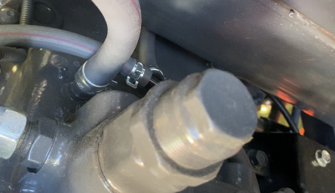

The other protruding item I’m wondering about in the pic below is located just in front of the remote stack? I am guessing it is a relief valve of some kind? Maybe? Not sure but also located in that vicinity of the strong noise and feeling? Like you say hard to pinpoint noise with running tractor..

The other protruding item I’m wondering about in the pic below is located just in front of the remote stack? I am guessing it is a relief valve of some kind? Maybe? Not sure but also located in that vicinity of the strong noise and feeling? Like you say hard to pinpoint noise with running tractor..View attachment 745414

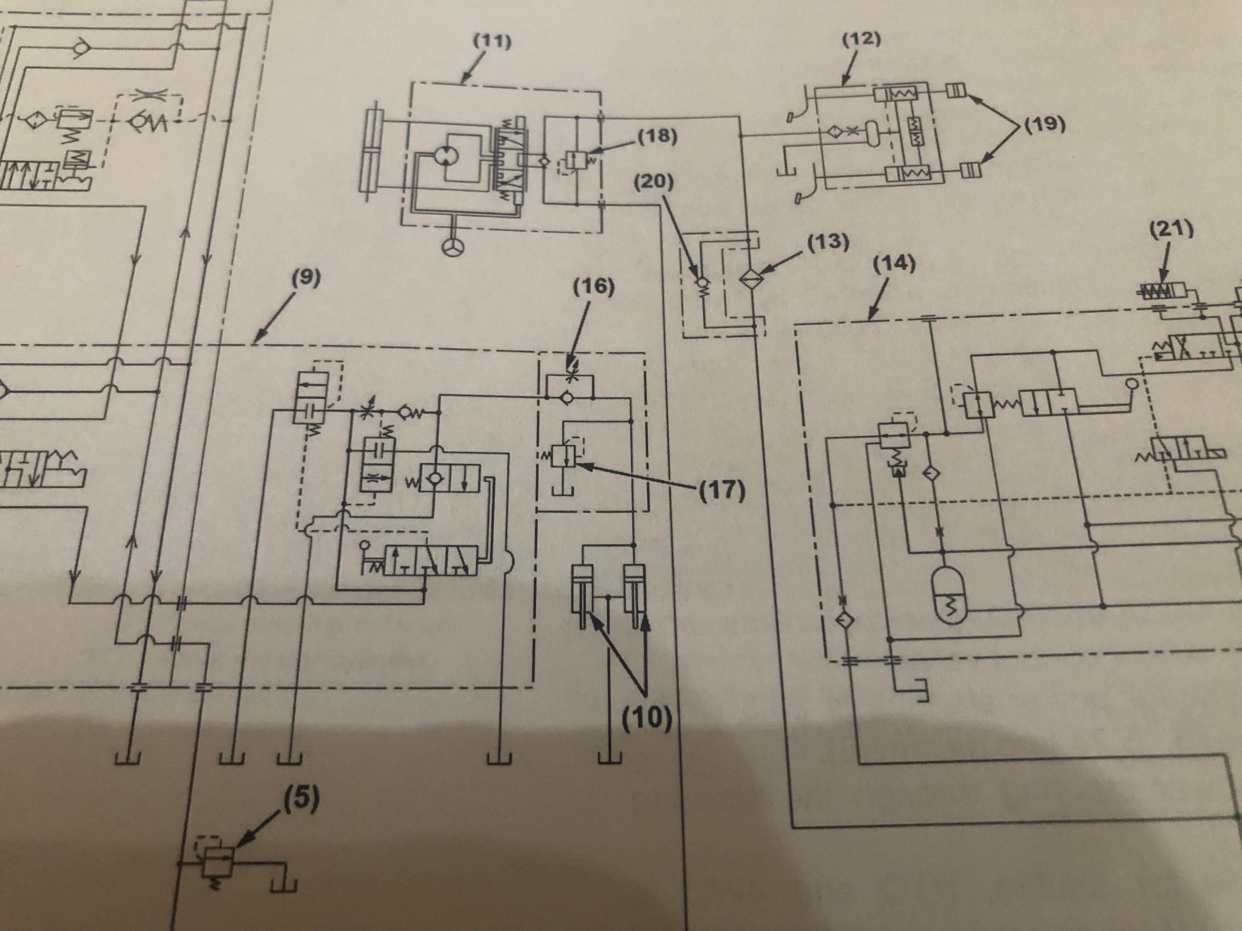

It just looks like a relief valve in the schematic? Item 17 is the safety valve, remotes are item 10, lowering speed adjusting valve item 16. It’s higher pressure than the primary relief valve, maybe it’s there for shock loads on the remotes or to smooth the shock loads?
