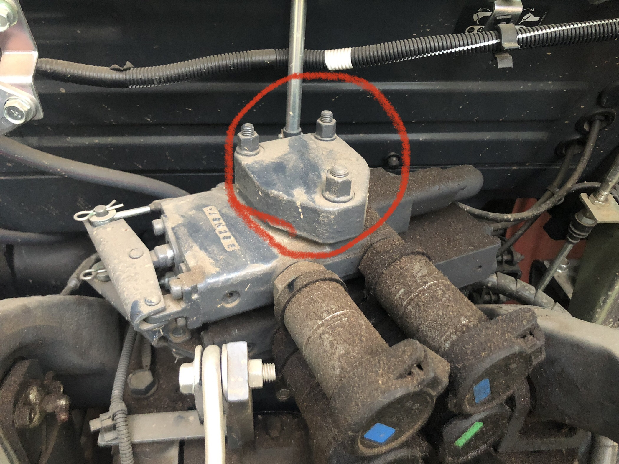

I would have to agree on the bypass valve idea. To me, mine sounds like a valve going into relief? Albeit a loud relief. I also had the dealer add a third remote valve on my rear remotes and when the tractor is making that noise that top(third) valve body is definitely super hot…can’t leave your finger on it at all, and the valve feels like the source(kind of vibrating if you will)? There is also what appears to be a protruding bypass valve looking item right in front of those rear remote valves and it vibrates there too?
maybe sea2summit can shed some light on that?
That seems odd, what type of valve? Self canceling? I thought they stacked so wouldn’t that be flowing past all of them? I’ll pull the manual out tomorrow and see what it shows.

Yes on the self canceling and yes they are stacked, I was thinking the feeling could be transferring from close by but the top valve on the stack is the one that is feeling like it is different from the others. Stronger vibration like fluid passing through at all times but, just not sure about it? There is also what looks like a relief of some sort on the top of trans immediately in front of that stack that feels the same?
Had mine running for a little over an hour doing chores this evening and didn’t use the remotes so figured I’d see how mine felt. Does yours have the same block on top?
I’m pretty sure that’s what allows the flow to transit from one side down the other. It wasn’t too hot to touch but was unpleasantly warm. The top valve wasn’t hot but was warmer than the bottom which felt only slightly warmer than anything else back there. I think that’s just normal operation. I know when I use the remotes and need to swap implements/hoses they are warm enough I wear gloves for more than just protection against hydro pressure leaks. I didn’t feel anything that seemed to be moving/vibrating but it’s on a running tractor so not the easiest thing to feel for.
