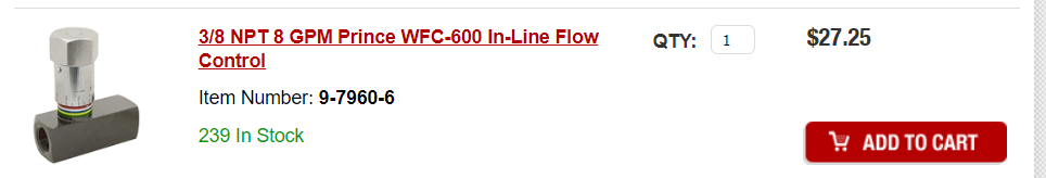

I had FEL boom lowering control problem on my Kubota M4900 several yrs back. Boom lowered to abruptly when handling 1000# rd bales. I installed and adjustable flow control valve similar to valve in photo in boom hyd circuit & that solved my control problem.
