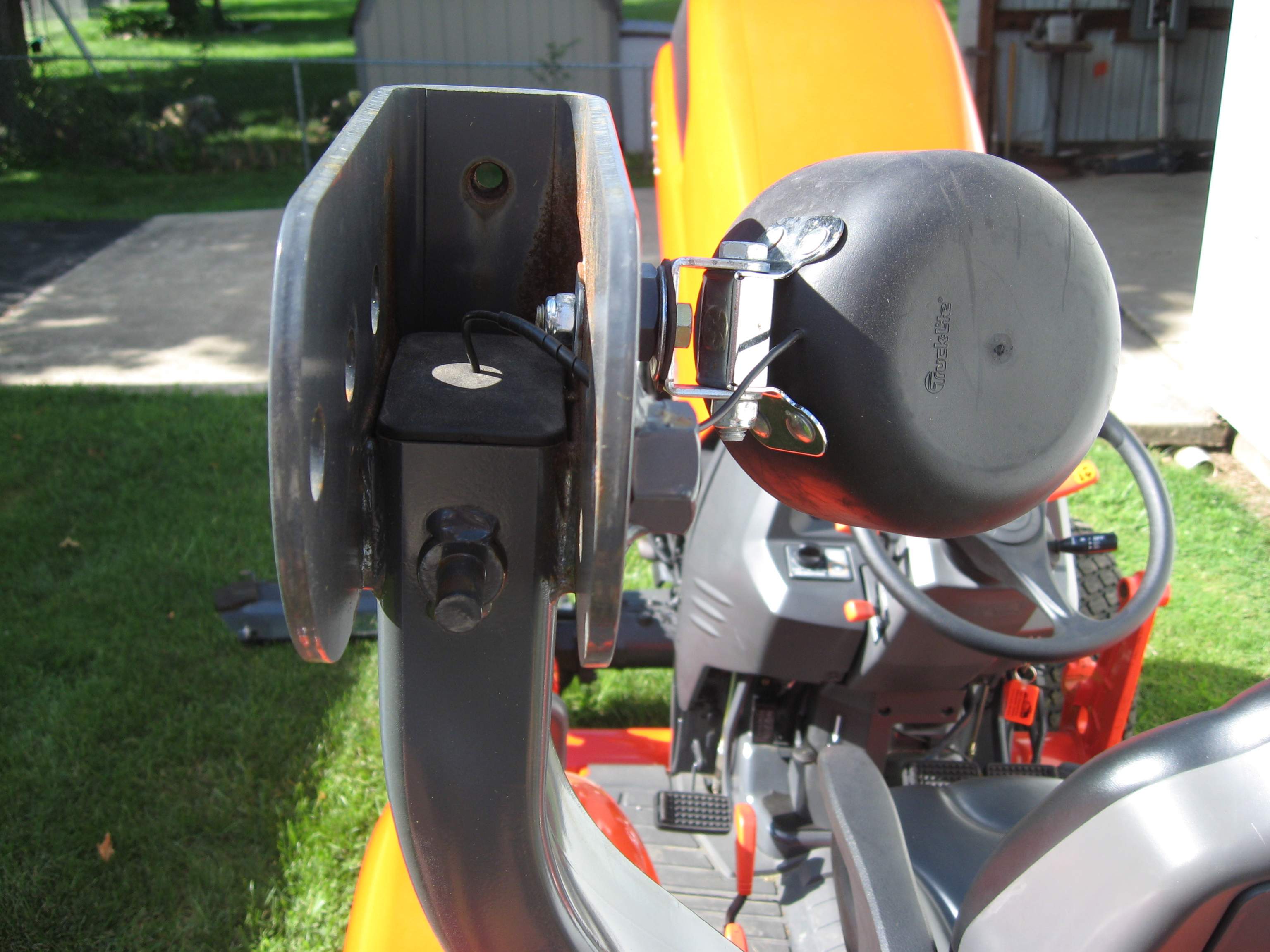

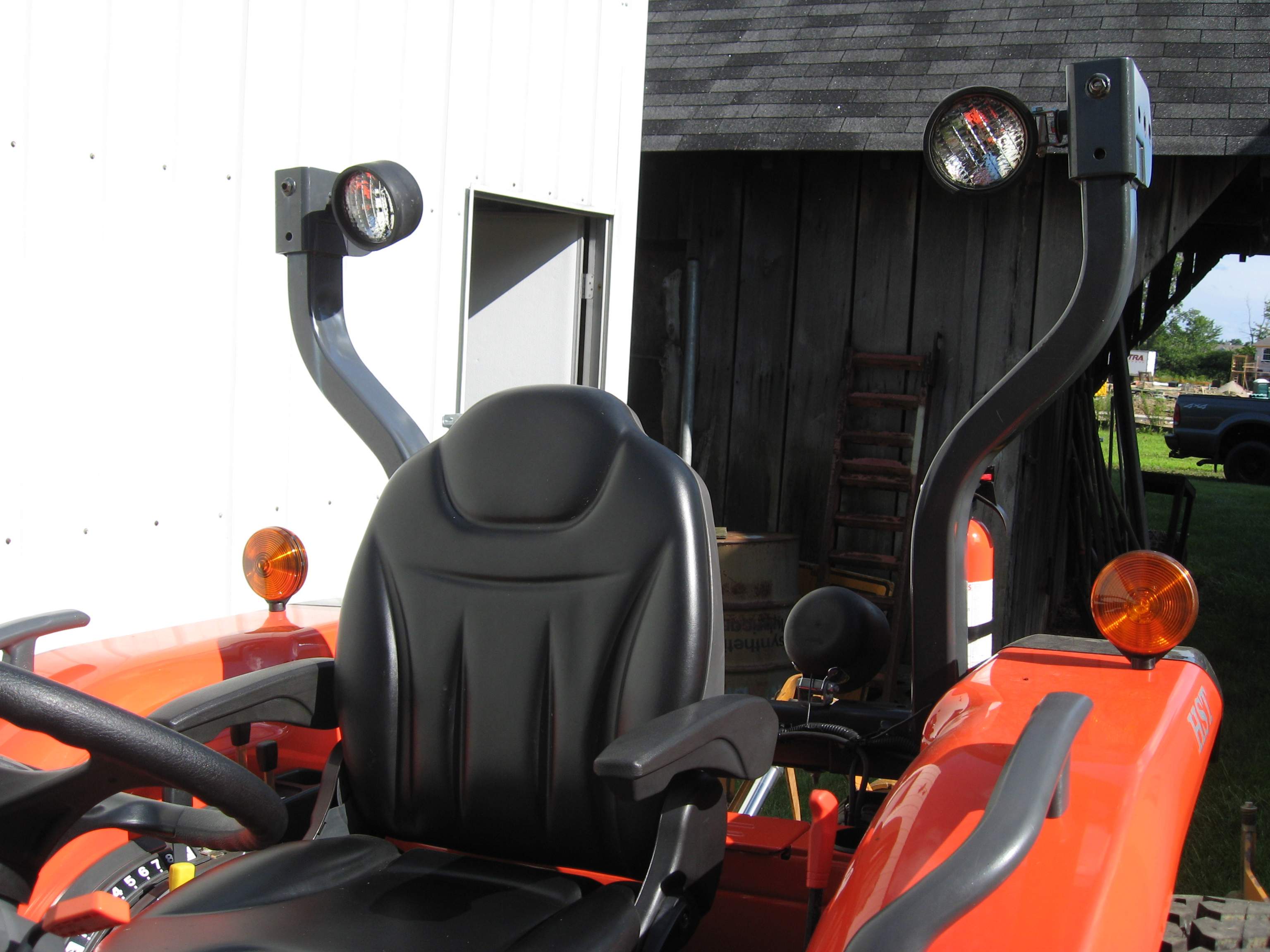

I have a M6800. I added two forward facing LED spots and two rear spacing LED floods. I researched this extensively on TBN and saw many ways do do this. I made brackets and installed them under the roll bar so they were protected from overhead limbs. I bought two factory Kubota switches that are lighted and cut out my dash and installed them. These are push button, one for rear and one for front. They are independent of the factory switches and are able to be turned on even without the tractor on. I wired them with the frequently used wiring diagram on TBN using relays. It took some time but they work great and look factory. I will post some pictures Monday if you are interested. This was not a cheap way as the switches and lights were expensive, but it works great and looks good. Do a search on work lights and you will see lots of info. In a previous thread "another worklight installation" by hcjtractor, I posted pictures of my install (except switches) I don't know how to link it or transfer these pictures, but you can easily find it.
/ Kubota lights #8

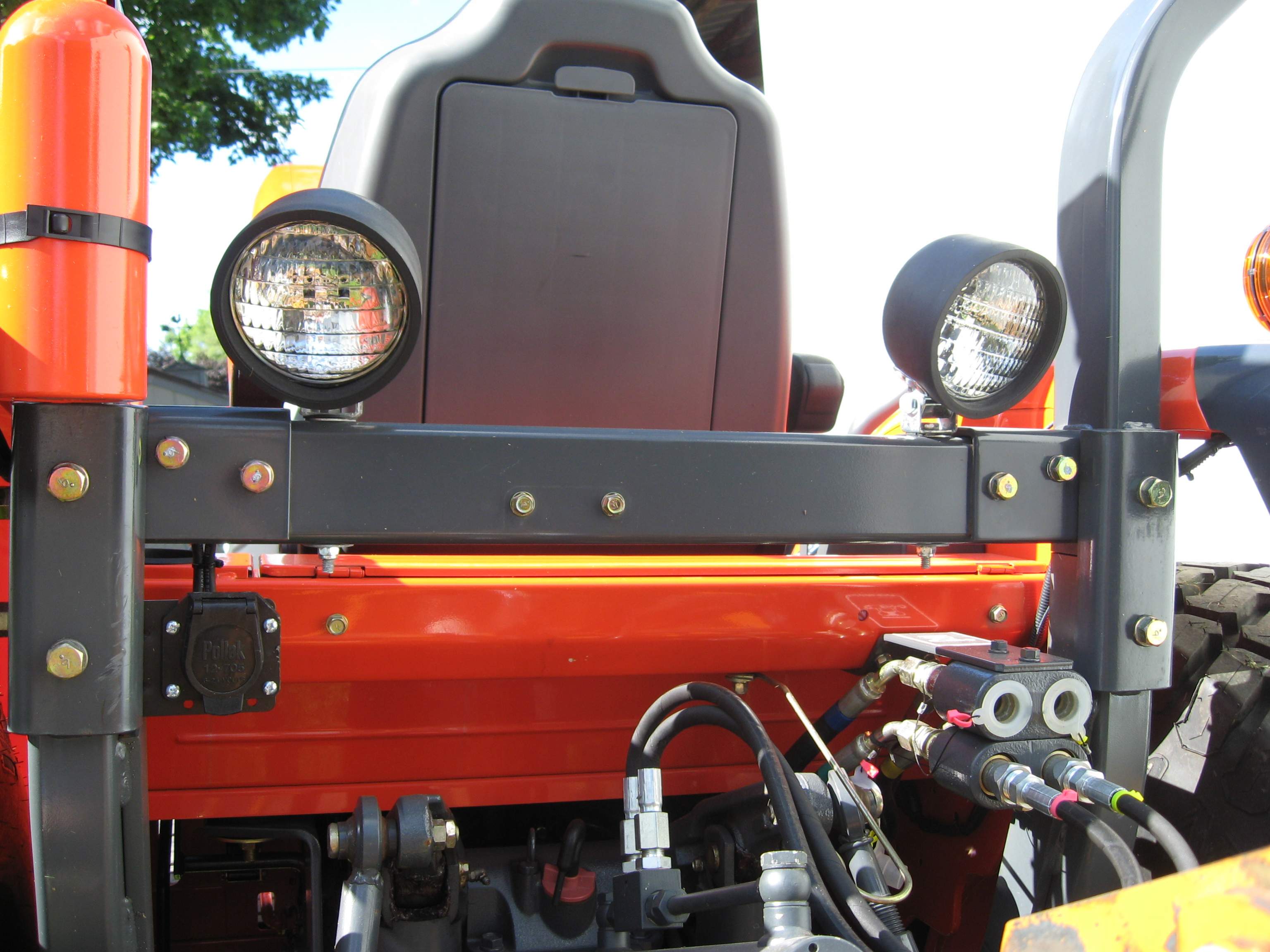

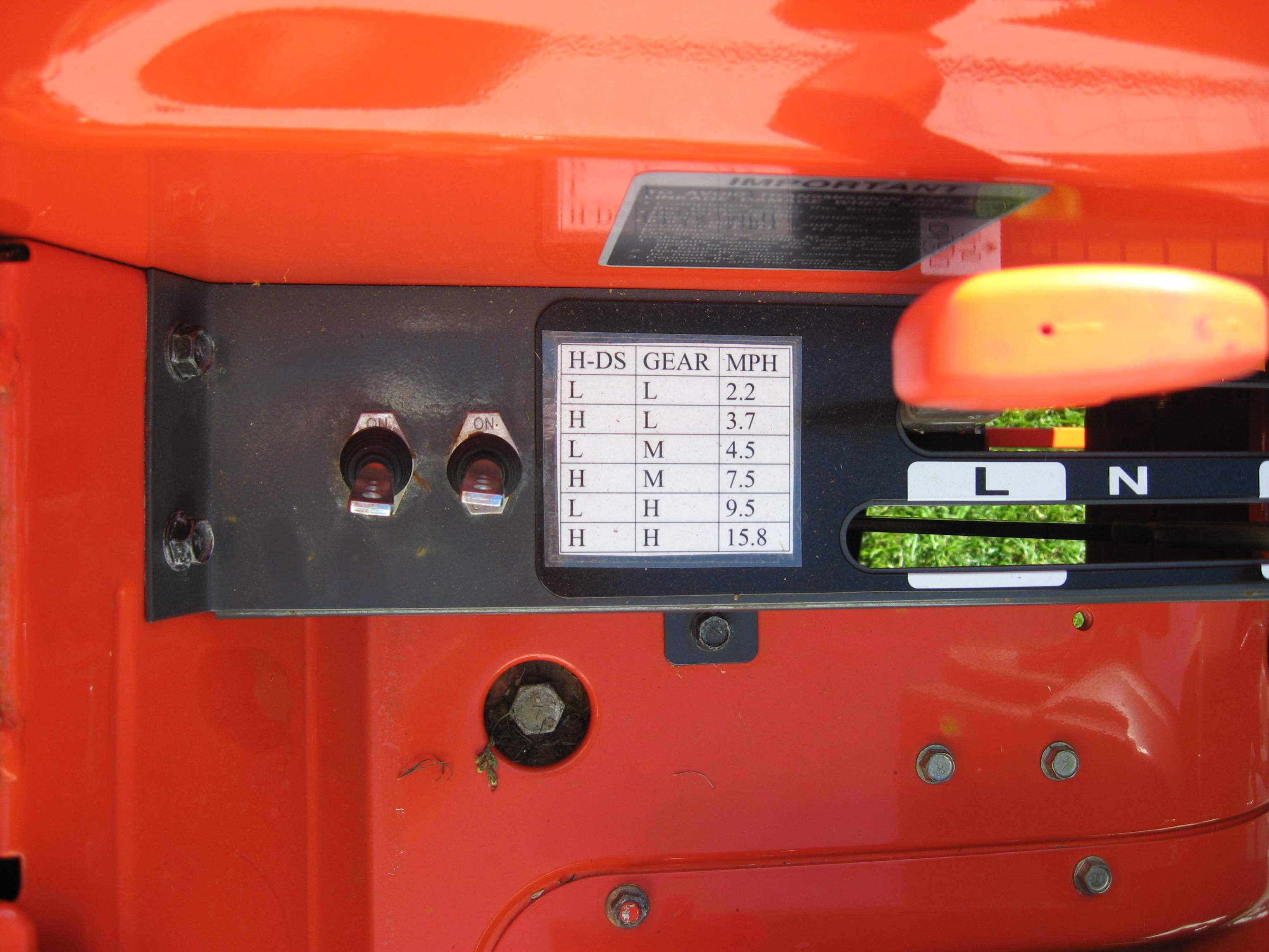

Different tractors, but the idea is the same. Philip.
