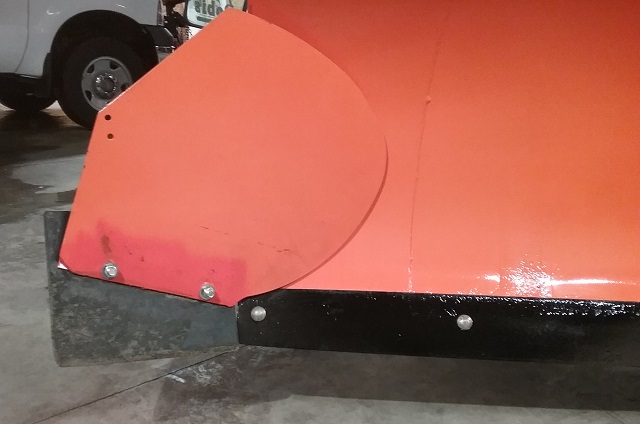

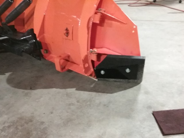

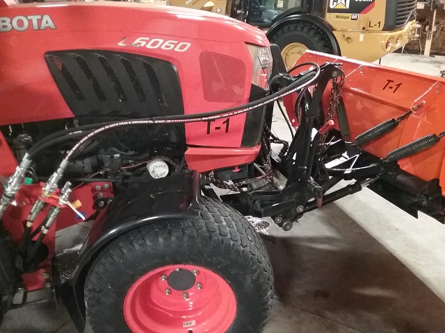

So, as previously mentioned the electric over hydraulic plow setup was a bit slow. Since I had the tractor back at the shop to do some maintainence i decided to try converting the hydraulics to run off the loader circuit. The lift works good, although its a bit too fast even when being very gentle on the loader stick so ive got some flow control valves ordered. Unfortunately, the angle will not work off the loader circuit because the curl down function actually applies pressure in both directions. Good thing ive got the 3rd function, but its way way way too fast and would probably tear itself apart or toss me in to a parked car so thats also getting a flow control valve as well. Once those come in and i get them installed i'll do an update.
Next, I flipped the cutting edge over since it was about 1/2" taller on the other side and is wearing way faster than my wing rubbers because its a really thin blade and got looking at the way the wings are designed. Ive used addon wings on a several plows and ive never really been happy with them. They are better than having no wings but compared to the wings on something like a Speed Wing or a Wide-Out, theyre pretty bad. The rubber edges end up angling back over time and ive had lots of problems with more snow trailing off then there should be. Initially I was just going to cut some plates to re-enforce the rubber to stiffen it up a bit but even then the rubber edge was angled back. Looking back at a picture from when i first put it together, they always angled back as you can see here.
So, I added a plate to the back side of the wing to relocate the rubber behind and change its angle to be closer to that of the cutting edge. Im really happy with how smooth the profile and transition to the wing is now compared to how it was. Im not too sure that the normal rubber will do exactly what i want but if not i can try double stacking them or adding a sheet of HDPE or UHMW since i dont have to worry about thickness like when it was mounted in front. Once i have a chance to try it out i'll make an update and try to get some better pictures since it doesnt seem like the shop has enough light for my phones camera.

The hydraulic chute rotator motor on my front mount blower uses what looks like a crossover relief valve with an exhaust line that goes back to the transmission to overcome the curl function restriction. You might want to look into a crossover relief valve to protect your hydraulics (if you don't have one) in case you hit something with the edge of your plow. I'm not an expert so I don't know how well they work with single acting cylinders (I would think it would work fine).

Thats good to know about about the rotator motor module. Thanks for that. I guess it only makes sense that they'd need a solution for that type of application. I'll definitely look in to it. Using the third function isnt a bad way to go but i'd have it on the stick if given a choice. I forgot to mension the relief valve situation. Ive got a call in to a buddy that maybe can get me one for cheap or free off of an old municipality plow truck with central hydraulics and im waiting to hear back on that. if not, i'll have to pick one up. Im certainly no expert with hydraulics either so im not completely sure what i can get away with.

Hydraulics on the curl are suppose to be 4 stage. Right is regen dump (full pressure to both lines, doesnt move a pair of single acting cylinders) but all the way right should be power dump (full pressure to 1, the other to tank).
I hear you on to fast o the 3rd function though. I need a restrictor on my SSQA plow angle circuit.

Thanks for letting me know about that. I'll have to try that out tomorrow. I dont specifically remember moving the stick all the way to the right but its possible that I didnt. My assumption was that with equal pressure on both the rod end and flat end of the dump cylinders, the rod end will lose because of its decreased surface area and thats all the power they'd want to supply for dumping because with full pressure at the flat end it would cause the curl down to be significantly stronger than its curl up. It actually kind of explained why it feels pretty gutless when trying to backdrag. Maybe Ive just needed to push further.

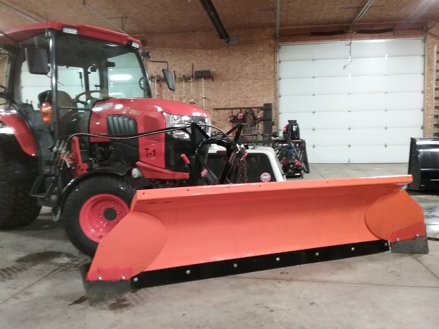

So, we finally got some snow to try out the new setup. We got a total of around 6 inches and i spent about 9 hours clearing it. Somewhat to my surprise, everything worked perfectly. The crossover relief was set at a good pressure out of the box. The flow control valves worked as they should despite being 12 dollar ebay valves and what im the happiest about is that the modification to the wings worked even better than i had hoped. I dont love having to wrench the stick far to the right for the tilt but it didnt bother me enough to switch to the 3rd function. I'll probably give the 3rd function a try for the next snow though.

here's some video of how it functions for anyone interested. Im still not happy with the lack of tilt angle or lift height but that's a result of the plow's design and i really dont want to hack it apart to make changes. Its still a 100% original truck plow that would just need the onboard hydraulic lines hooked up and the lights put back on to be ready for a truck. Im thinking ill be keeping an eye out for a Boss EXT or a Blizzard Power Plow for the next tractor.
