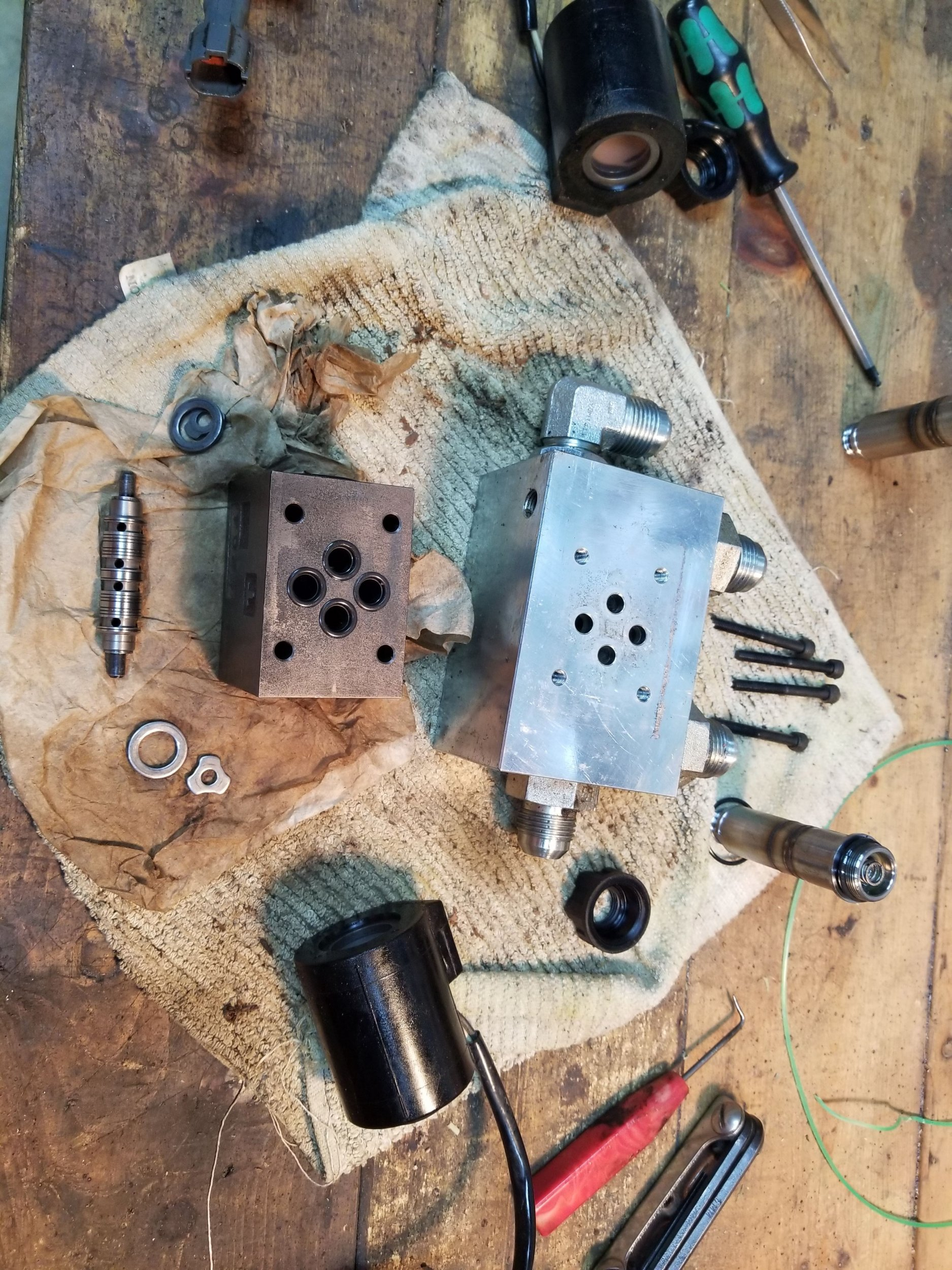

The 3rd function valve messed up again I told myself if it did it again I was replacing it with a new one, but I didn't! While using my hydraulic sickle bar the other day my 3rd function valve stuck on. since it was on I just finished what I was doing but the rest of the tractor hydraulics kept getting more and more sluggish to the point I could not even operate the back hoe. So we loaded up and went home after getting the valve off and torn apart I found two pieces of rubber in the valve spool they look like pieces of a seal. Put it all back together and it works fine. The sickle bar has a diverter valve on it and I am thinking that maybe that valve is having a come apart and that is where the pieces came from since I very seldom use the sickle bar I have plenty of time to take the valve apart. It's amazing how such a small piece of foreign material can shut down a backhoe. 20220716_193445.jpg20220717_080319.jpg20220717_081724.jpg

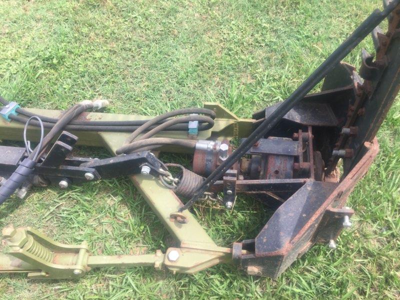

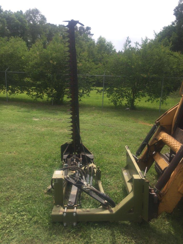

Uh.... hydraulic sickle bar? I've never even seen one of those. Got photos?
rScotty
/ Kubota L45 Valve #5

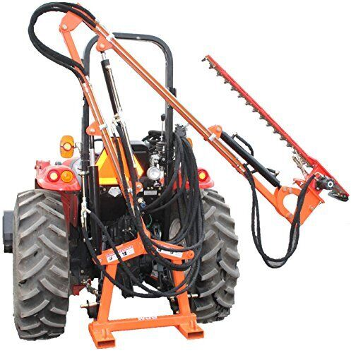

Here is a 3pt boom mounted hydraulic sickle bar for reference. The OP's one is most likely different as it goes on the loader but same principle.

That is a picture of it mounted on a skid steer not on my Kubota

rScotty, I believe it uses the PB port and the trash was not letting the spool go back to center.

The sickle bar was used and no filtration on the bar there is a diverter valve that either goes to the lifting cylinder or the sickle bar motor. when the diverter valve is going to the cylinder I can raise or lower by using the 3rd function buttons on the loader. I don't have a schematic but I believe it all goes through the 3rd function valve. I agree with once the crud makes it to the sump it is there or in the filter and out of harms way.
