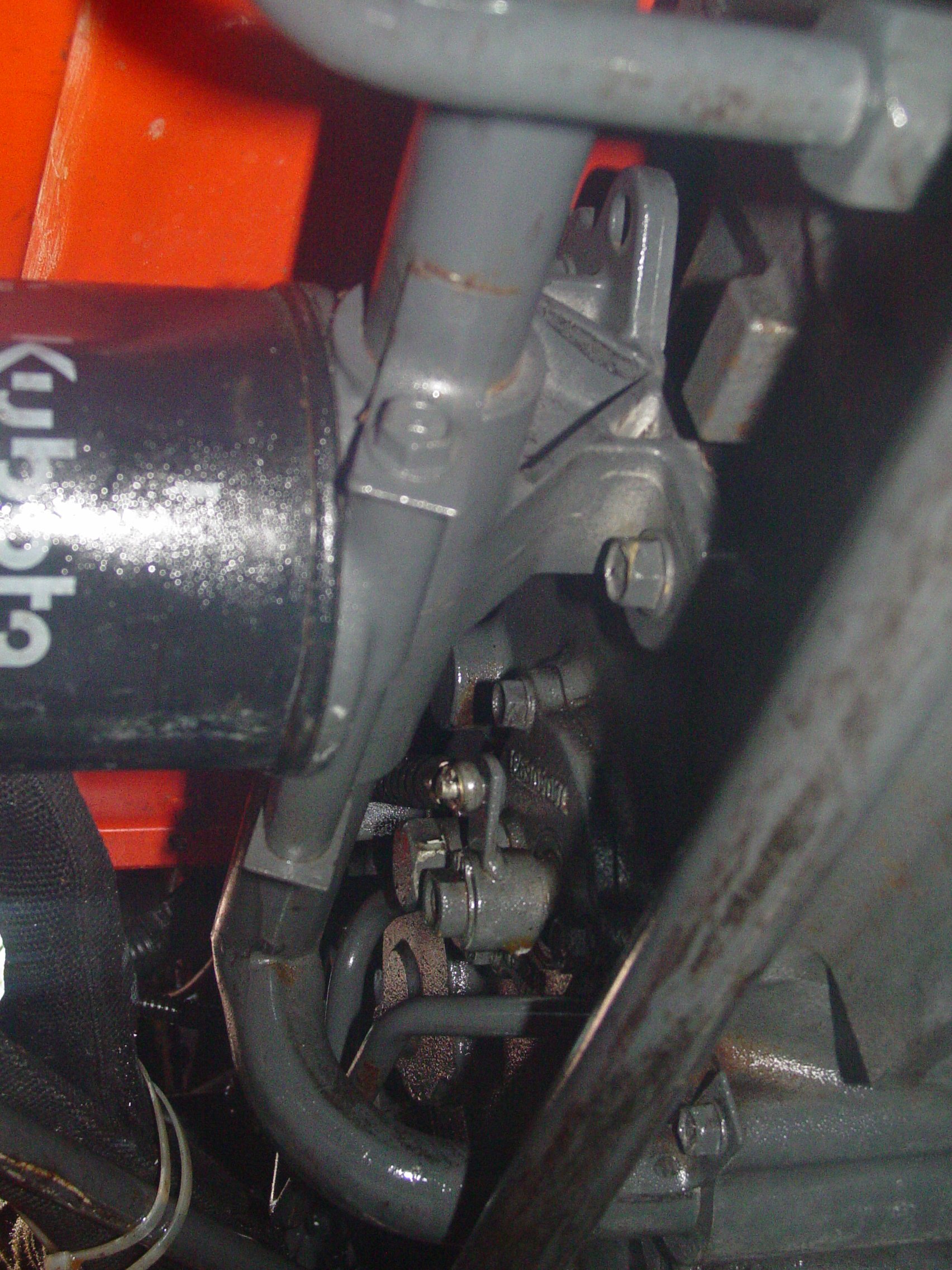

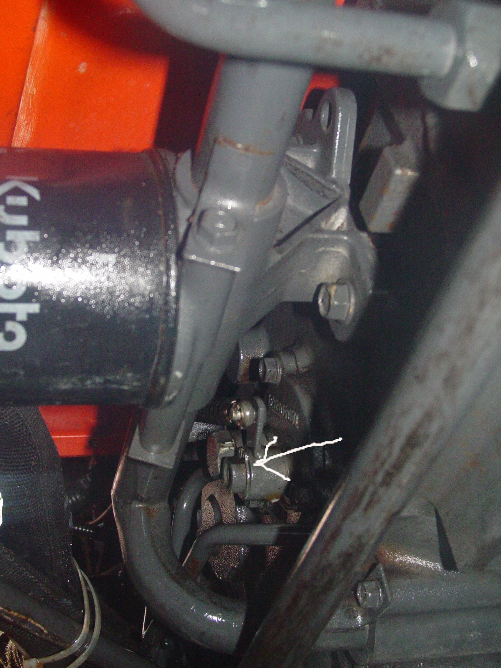

Ok so here is a new post. I was working with tractor clearing. I heard a pop underneath saw smoke...shut down. Hydro fluid flying out under pressure when started. I took a few pictures but it is still hard to see where exactly it is coming from to the untrained eye. I am due for fluid changes almost to the hour in manual. Can anyone tell me where this fluid is pouring out of and what the repair entails. I am not in a rush. Florida weather and hobby/ just starting tree farm.
Cant seem to get picture into this post.:eek: attached?

I can't detect any wet areas to isolate the leak from the picture. Does it leak all the time or just when the hydro or the loader valve is operated.
I'd recommend getting someone else to start the tractor for you if the leak is that bad and maybe constant but if you do be sure they know how to operate it.
It does look like weeds or some thing has worked over the lower line a bit but it all looked dry.

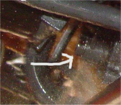

Art, if you look close at the very bottom of the picture, just left of center, you can see oil spraying out of something.

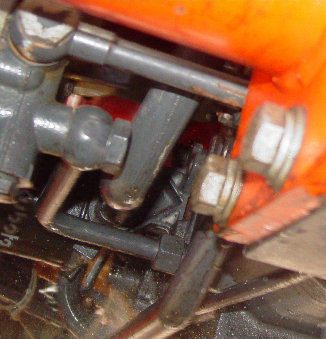

It only sprays out when started. I cannot get a much better picture as the spray would hit camera. I do have a couple of other shots will try to post.

Here is the closest pix I can get.

Hmmm, I can't quite tell from the pix. Maybe one of the "banjo" bolts on a pressure line to/from the filter? Try looking over the parts drawings in the Kubota parts manuals. I think they're still available for free download from several sources. Try tractorsmart.com.

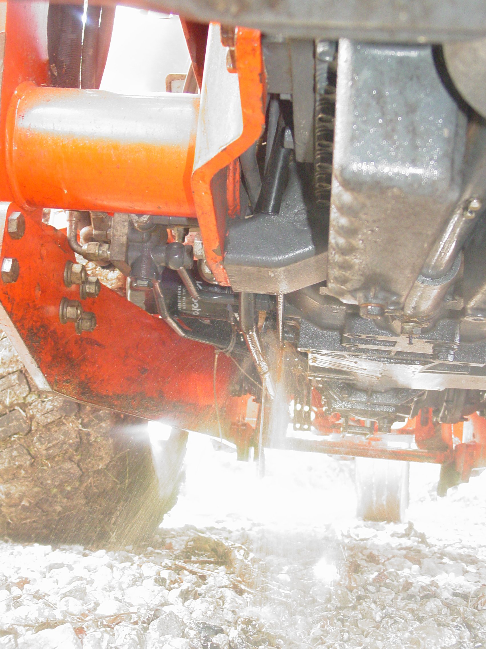

Thanks for that diagram. It looks like the diagram is of the line that has the filter built into it. Looking at the picture High pressure spray leak seems to be coming from seal plate on side of transmission? I will attach another photo.
Do you perhaps have a diagram of this? I gave my information to request manual to the source you suggested...thank you for the help.

Ron, it looks like there is oil higher up? Then the leak is possibly on the top? You might find that the line might have a flaw so check it closely.

Hopefully you don't inject any hyd fluid into your body and get gangrene.
You may have burst the o-ring on the HST filter. That fluid is at 2-300 psi as it comes out of the precharge pump, thru the filter then into the HST.
I have blown that filter 3 times, but typically only when it was cold. Like -10F or lower. There is a bypass on that circuit, but the thick cold fluid can't get out the bypass fast enough and plewy!
Only a new filter fixed it for me.
