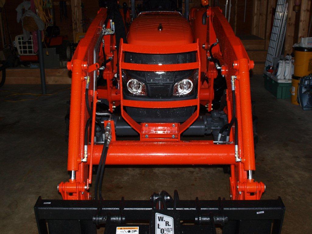

The tractor is still at the dealership so I don't have photos just yet. I did look it over and it does look very professional. Mostly steel lines 90% or so and the couplers are mounted on the boom close to the bucket :thumbsup:

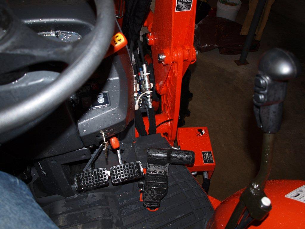

Here's the Kubota 3rd function valve & connections on my L4240. The dealer installed it before delivery last year. It works great, no problems so far.
What's the white button on the lever? I thought someone had said it was a second valve. Is that box with the "no step" on the side of your tractor for the quick disconnects?
/ Kubota L4240 Factory 3rd function Kit #11
The white button turns the two joystick buttons (and the front hydraulics) on and off. The box on the side is for the valve. Metal lines run to the front of the loader where the disconnects are located. I have this setup on my tractor and its nice (but expensive).

I like the Kubota steel lines on the FEL. Is it just a kit that comes with all the parts or do they break down on the parts needed? I would love to see a list of all the parts.
/ Kubota L4240 Factory 3rd function Kit #15
I looked at my installation manual for the third function....I would bet that it comes in kit form.Being an old retired pipefitter that has done some tube bending;I wouldn't think they would expect every tractor mechanic to be proficient in tube bending.It is quite a process,the rear tire has to be removed and the FEL supports(on one side),about six hours labor.

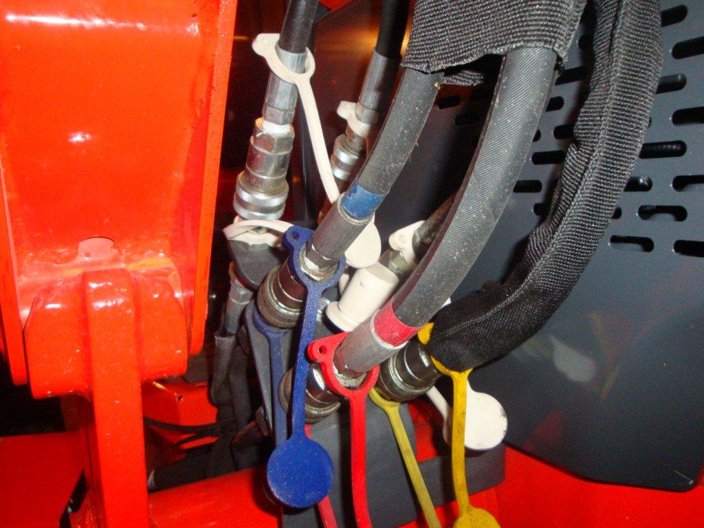

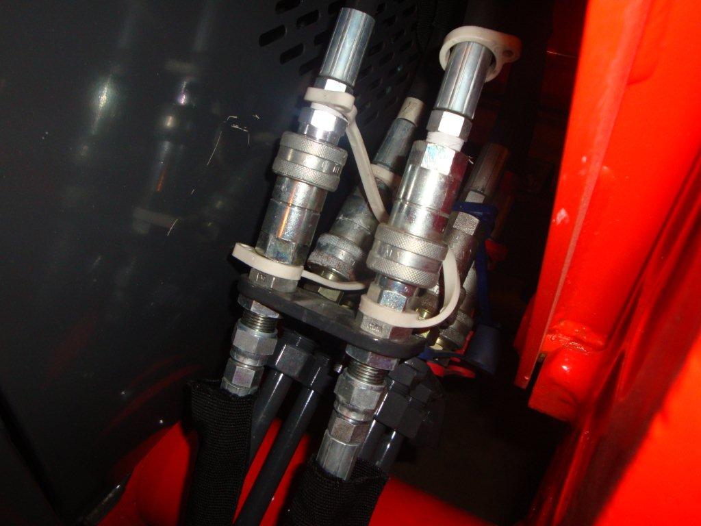

I think JimP answered but there is also another pair of disconnects over the FEL disconnects to allow loader removal. They are the top ones with the white dust caps.
