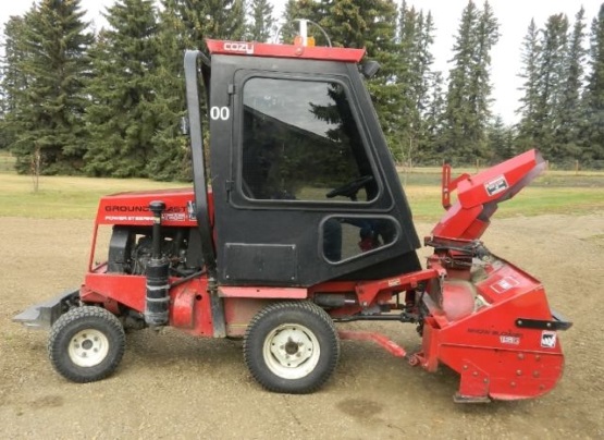

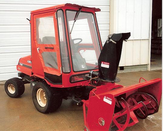

How about a 4WD front deck mower with a snow blower?

I think he is looking for a machine to do sidewalks that can be safely ran on the road with a fast road gear.
   / Kubota L4060 or L4760 narrow setup for sidewalks front attachment info needed #13
Yep, but he hasn't found one.
These would have to be trailered, but would probably clear driveways and parking lots as fast as a wider rear mount blower.
