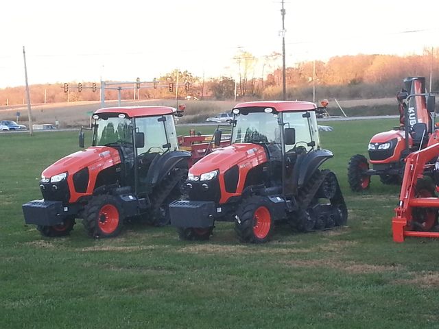

I'm not sure if the M narrow have a loader joystick, i don't think they do. It would not be real hard to add front hydraulics.
I snapped a pick of a couple at a dealer a few weeks ago. These had tracks on the rear.

A small V blade would be nice on a M narrow for sidewalks.
