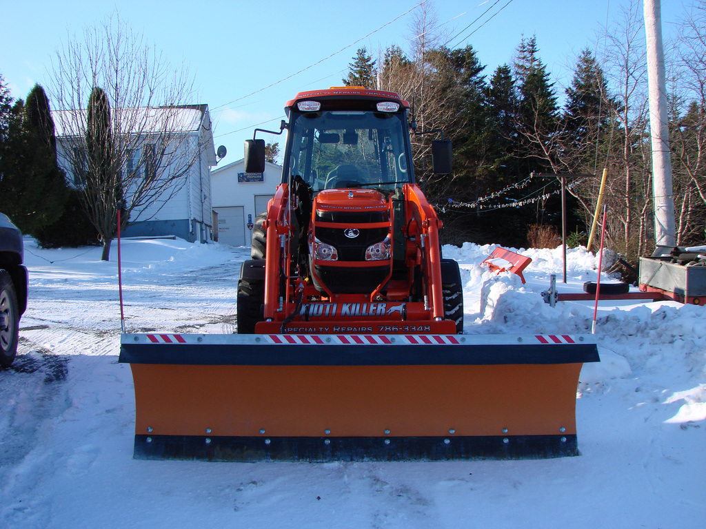

Mike I'm sure what ever you end up buying you'll be happy with it. I have a new Grand L4240 Cab model and just love the thing. I'm using mine exclusively for snow clearing but I'm sure it would handle just about anything you can throw at it on a small farm. I really like the HST and even like the Throttle control more so for my plowing. I have the R4 industrial tires and there not loaded. I don't use chains and for my work I don't need them. When it comes to the hydrostatic transmission, there being used basically on all types of equipment these days and most of the real big stuff with very few problems and that in it's self was one of the deciding factors for me buying my tractor. Good luck with your purchase. Paul
Here's a little video of mine:
YouTube - Specialty Repairs 2008 Kubota
