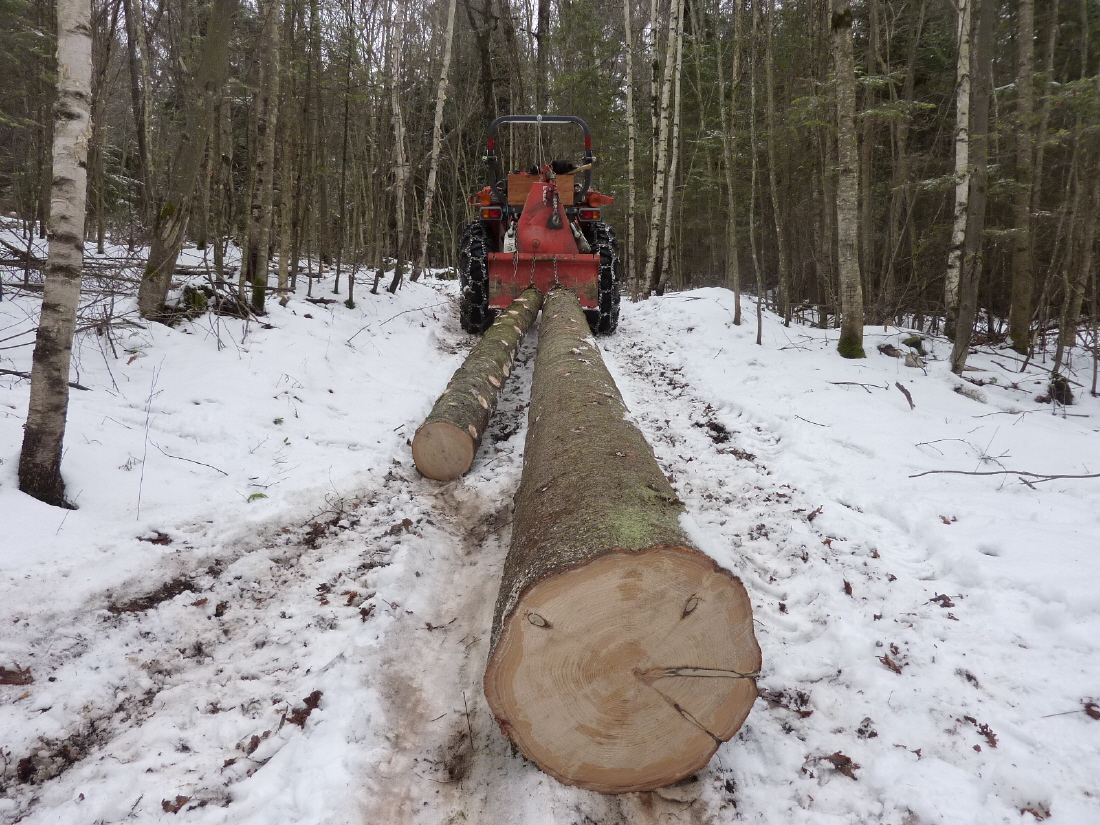

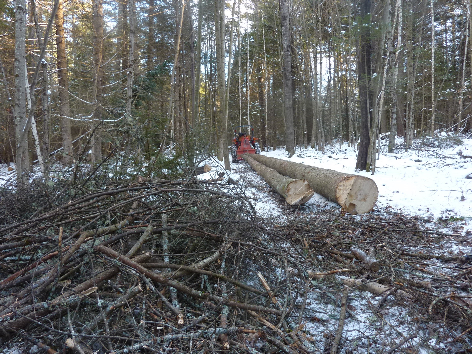

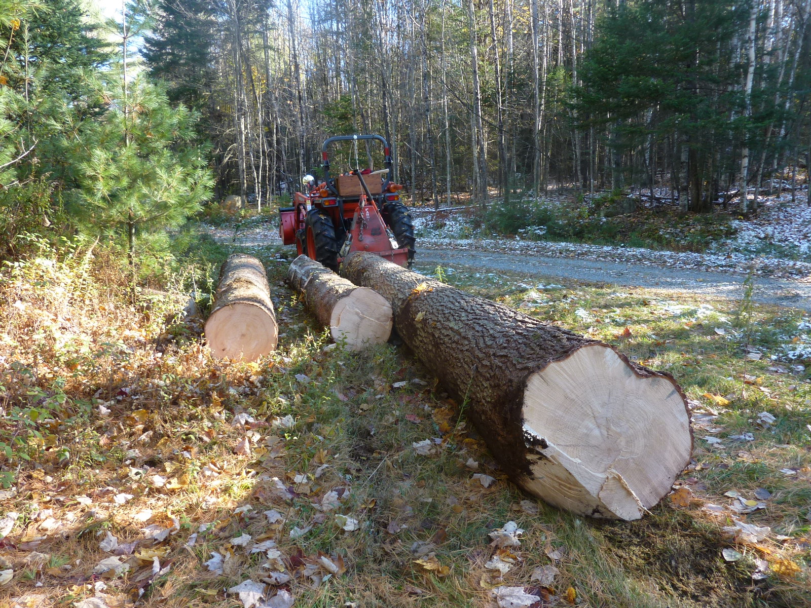

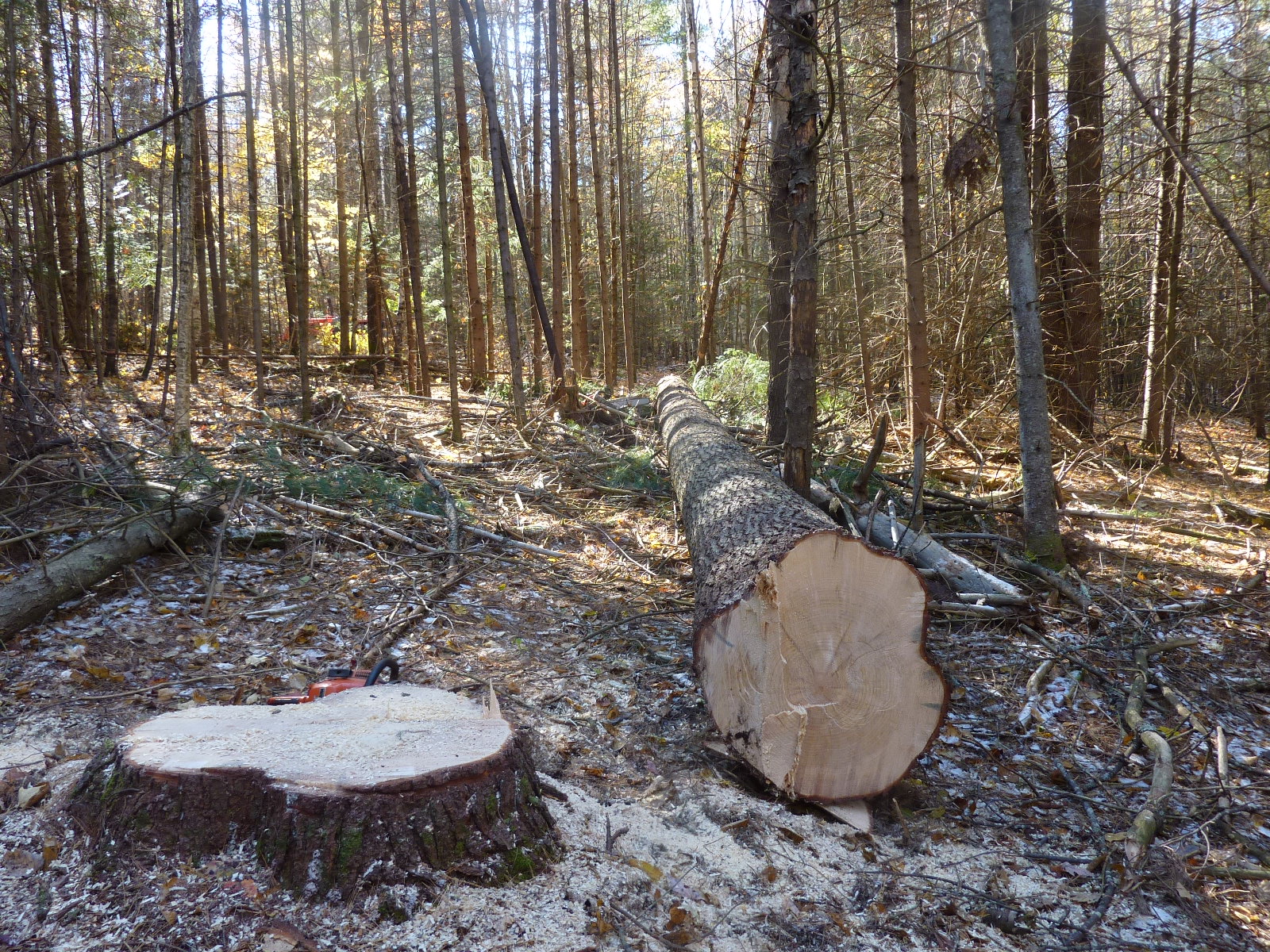

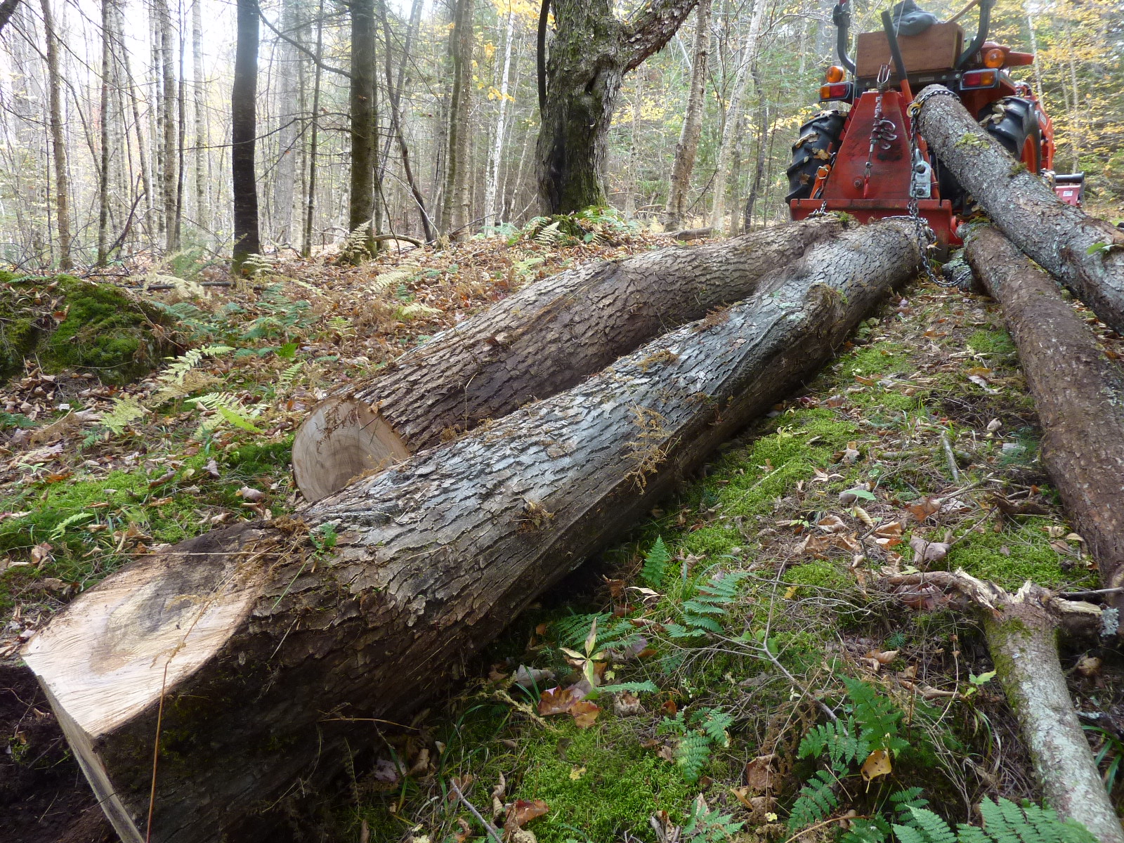

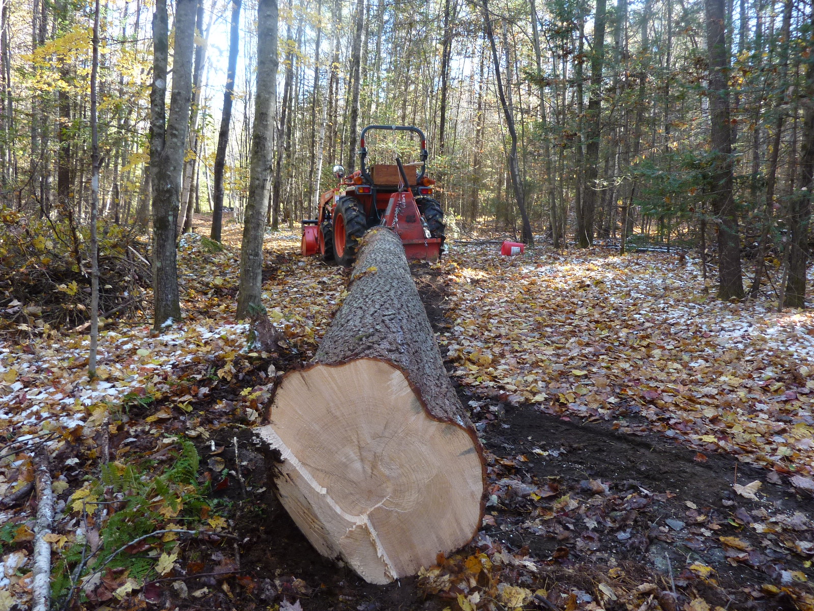

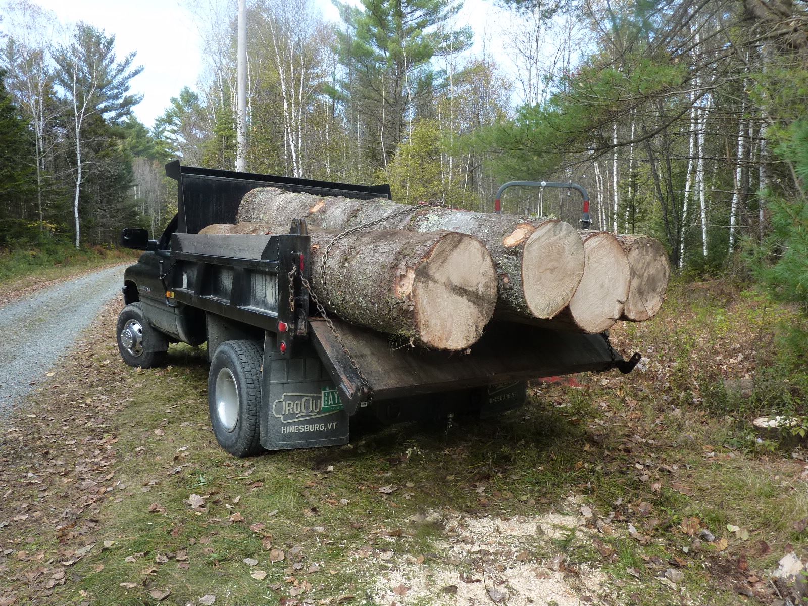

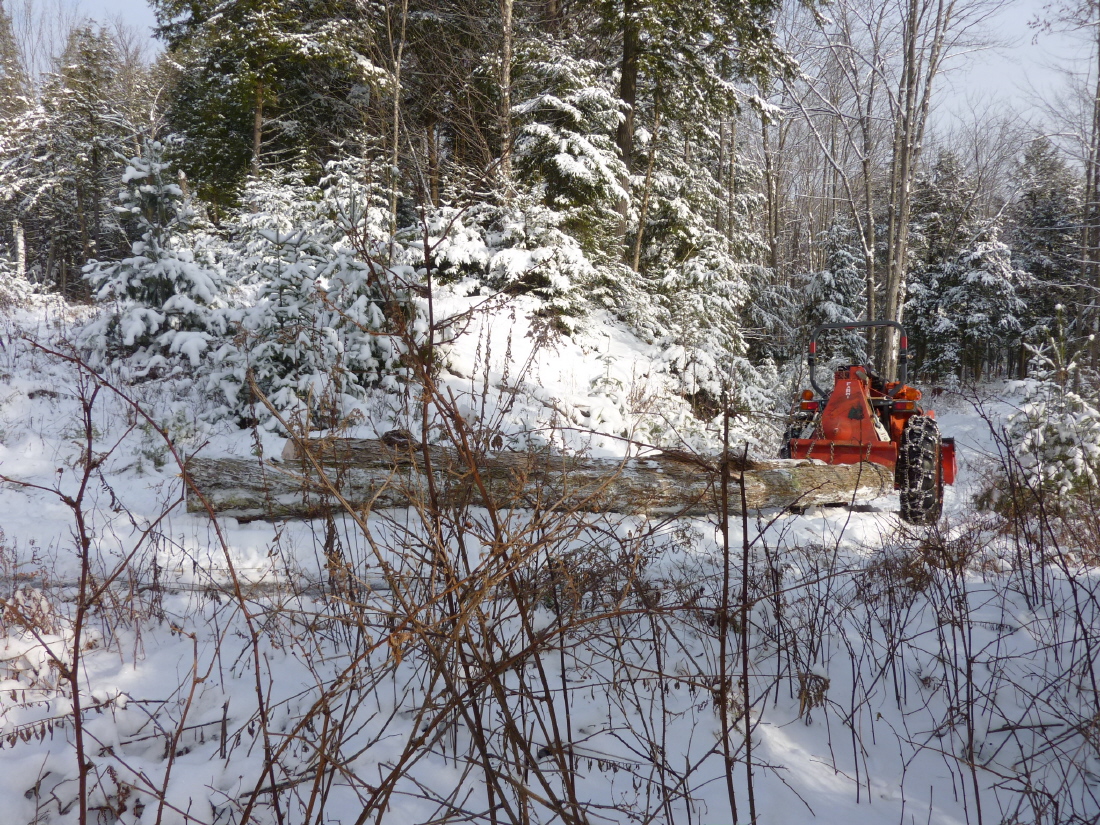

You have not told us how big your wood is. Is it 30" diameter hard maple or oak for saw logs or much smaller/lighter wood. It makes all the difference in weather your tractor is to small. To give you an example my tractor is about the same size as yours. Slightly less hp but heavy for it's size at 5000 lbs. Weight is your friend in the woods. I handle wood like this day in and day out.
Now here is some wood that I can or did handle but it is really to big for my tractor. If I was going to work this size wood all the time I would need a bigger tractor.
A to heavy trailer is definitely more dangerous in my opinion.

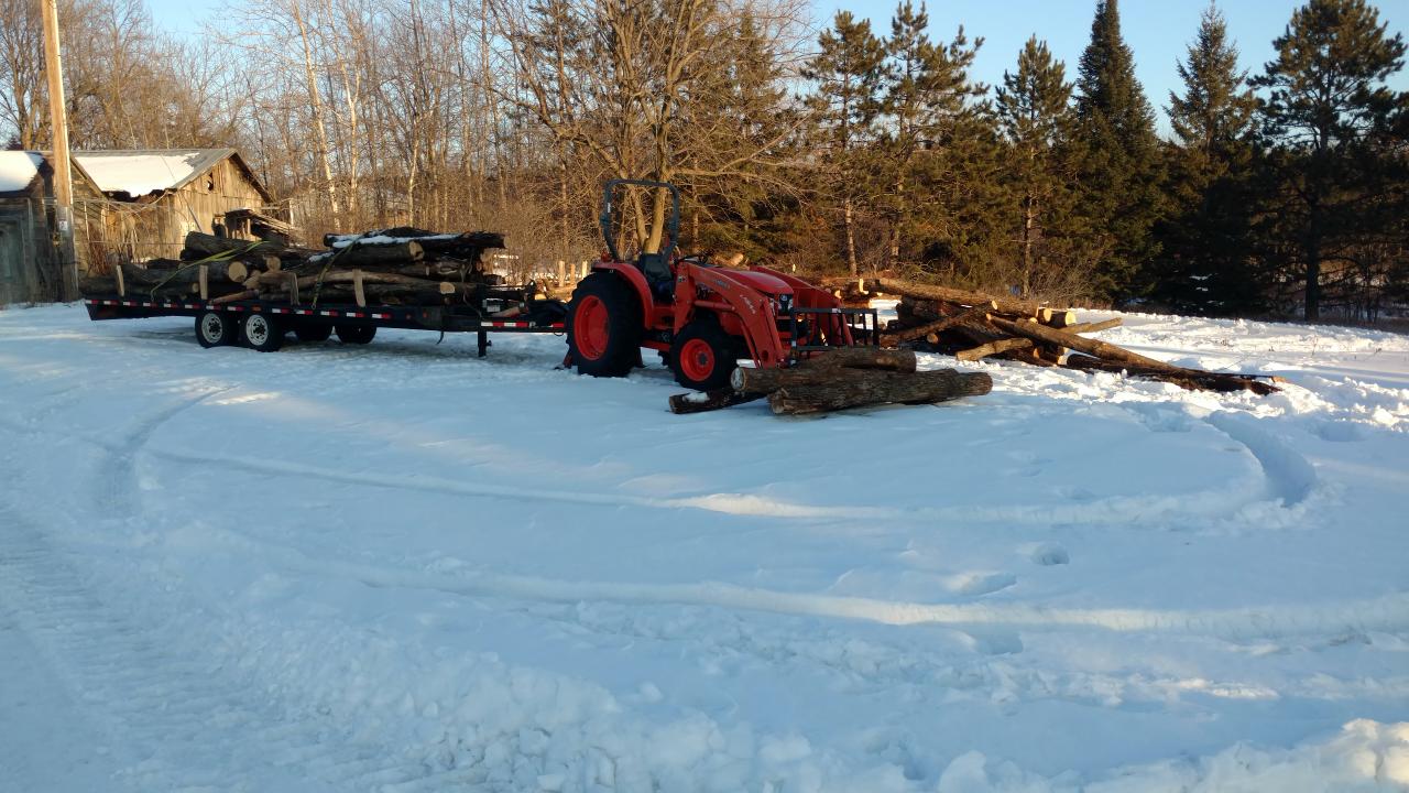

On the topic of using one tractor to load and then pull a trailer, I moved about 9 cords this winter that way. I have a 22' deckover trailer that i pulled down the road with my Kubota. I mounted a receiver hitch to my farmi 351. When I got to my destination, I chocked the wheels, then lowered the winch so the jack hit the ground. Then I loaded the trailer, and backed the ball under the hitch. Lift the winch, pull the chocks, and you're ready to go. Never had to mess with the jack. Did have to load the trailer carefully, though. rps20170410_065300.jpg

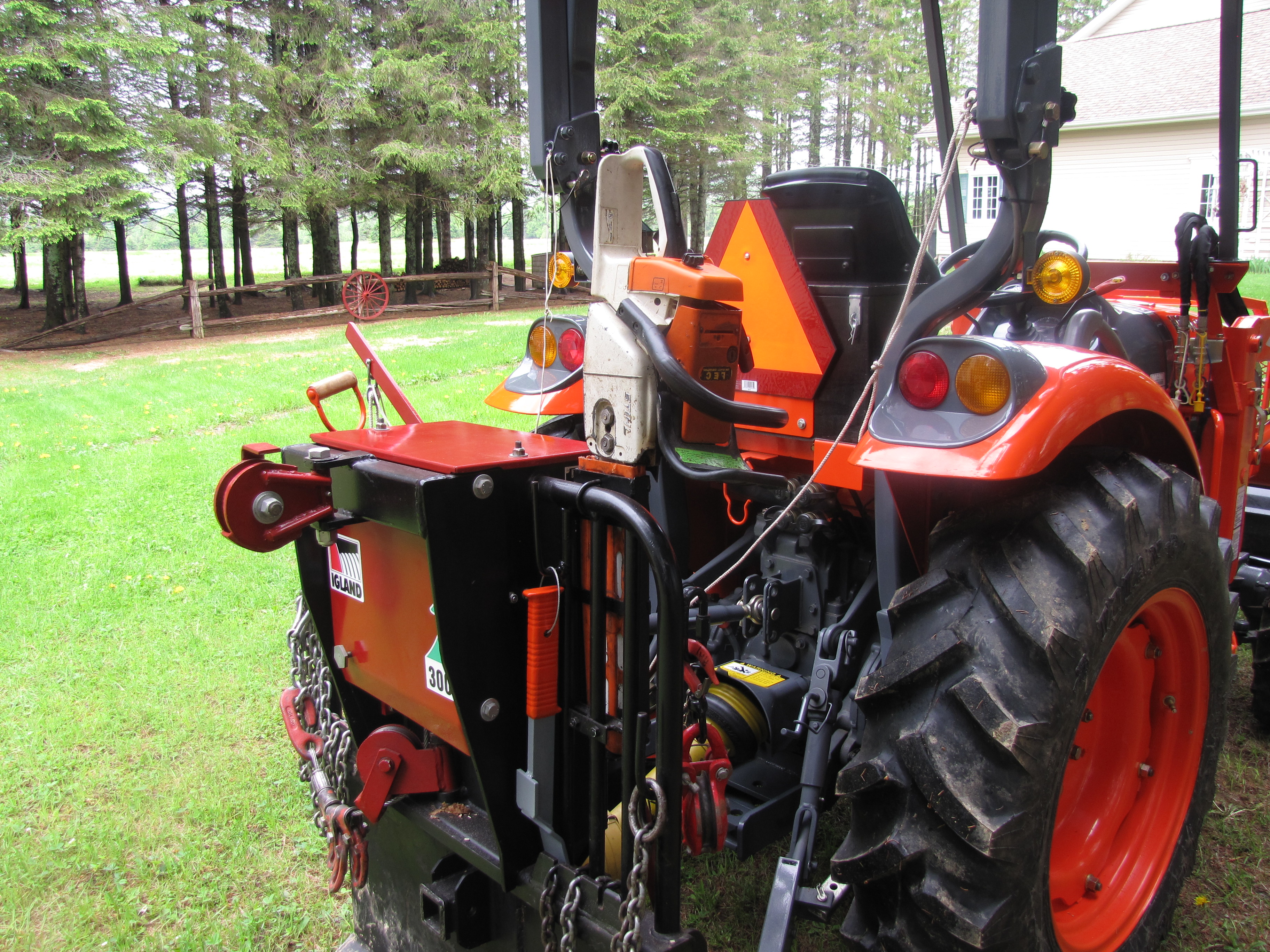

And if I go with a winch, which of the Farmi 290 and 351 fits the best my L3800 ?
I had an opportunity for a used 351 but the guy decided to keep it, so I would go for a new one, so better buy the best fit. Any accessories to buy at the same time ?

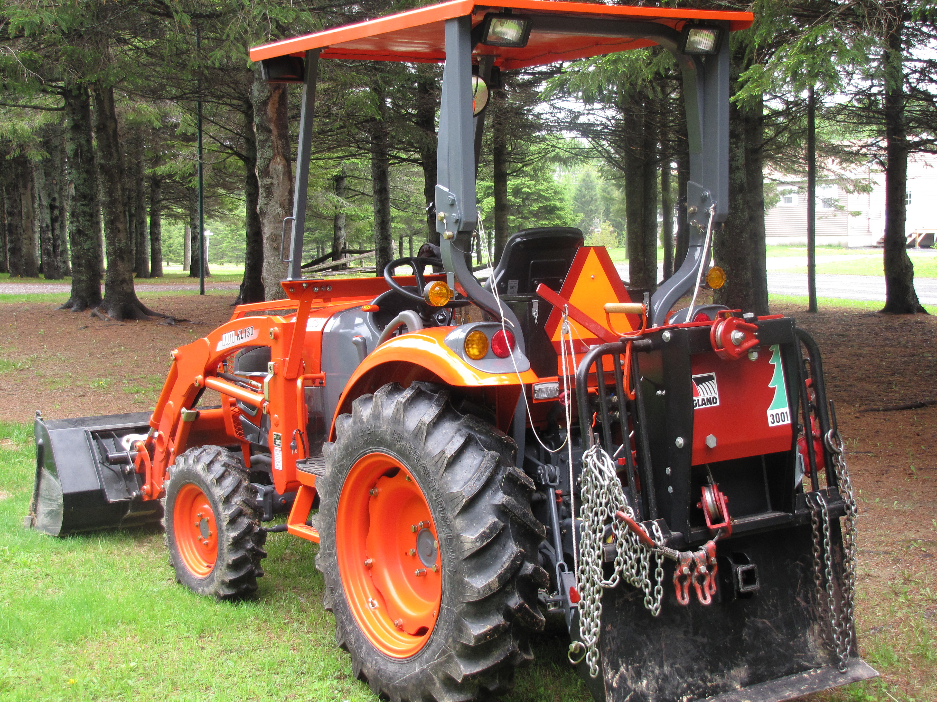

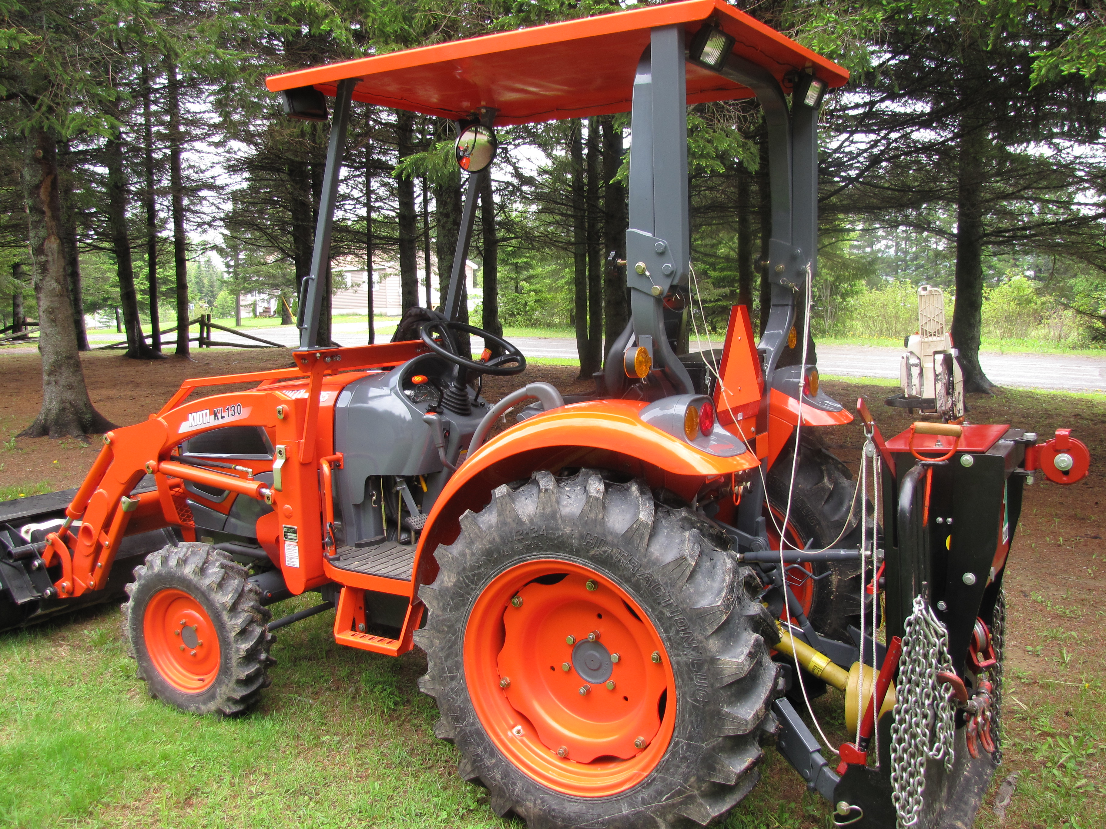

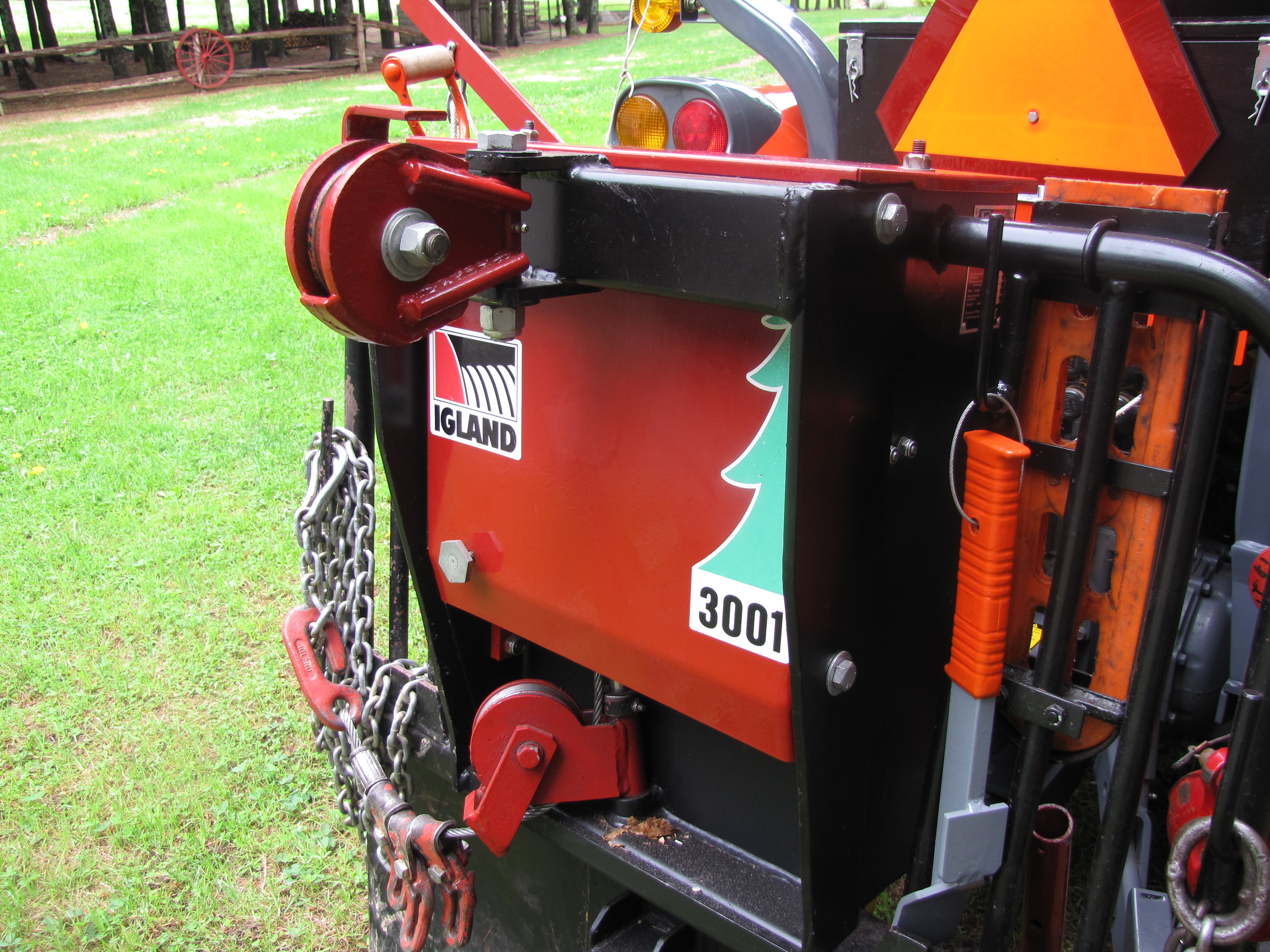

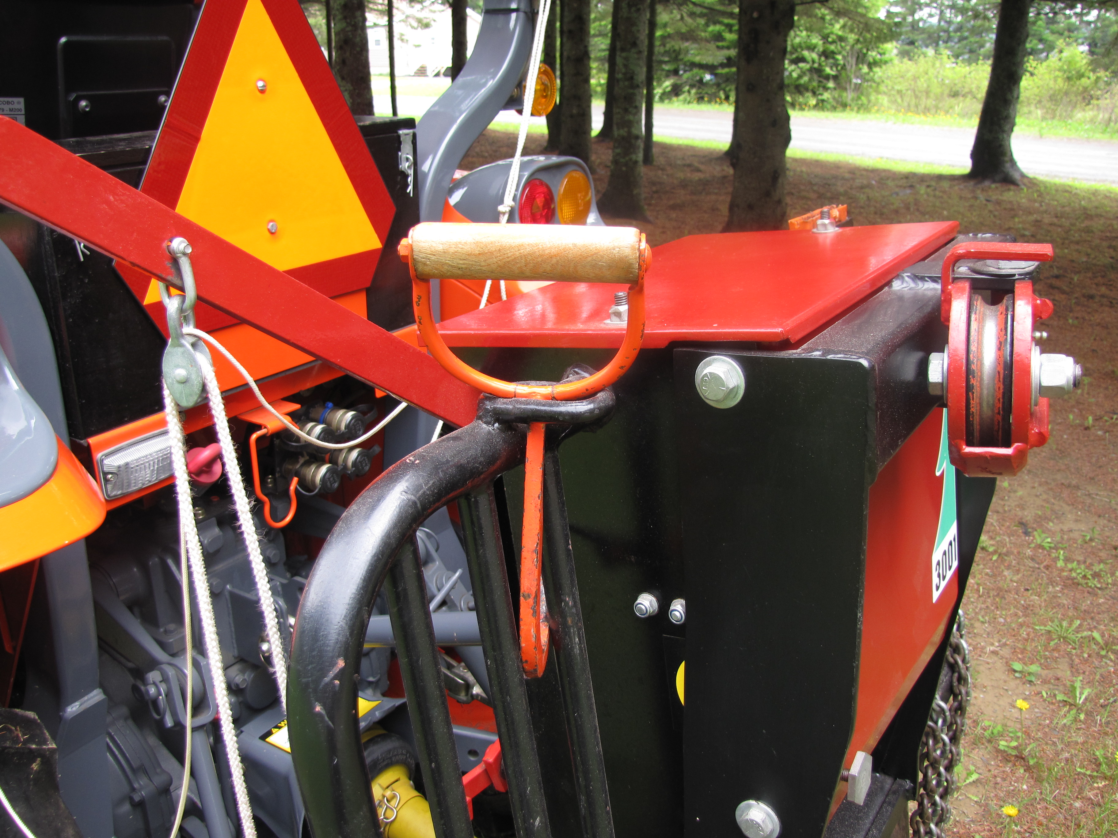

Hi neighbour i have a Kioti CK35 and 3001 Igland winch and work pretty good. I have about the same size of tree on my wood lot . Igland winch is very simple to work with and easy to replace cable and pulling pads if needed. Do some little modification on it like a chain saw holder , trailer hitch, top pulley and if you buy a winch make sure you made you a self release pulley or buy one work very well and save you some precious time and step.... Now for your log loader and trailer am looking for one right now have a lot of guys around here who have that kind of set up for there sugar house and they love it..... do you check metavic and woody company in Quebec very nice log loader and trailer...:thumbsup::thumbsup:
