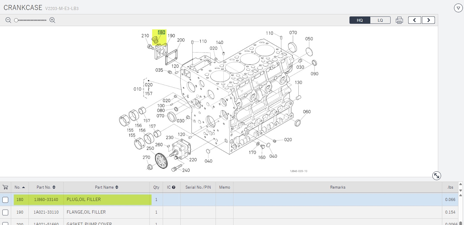

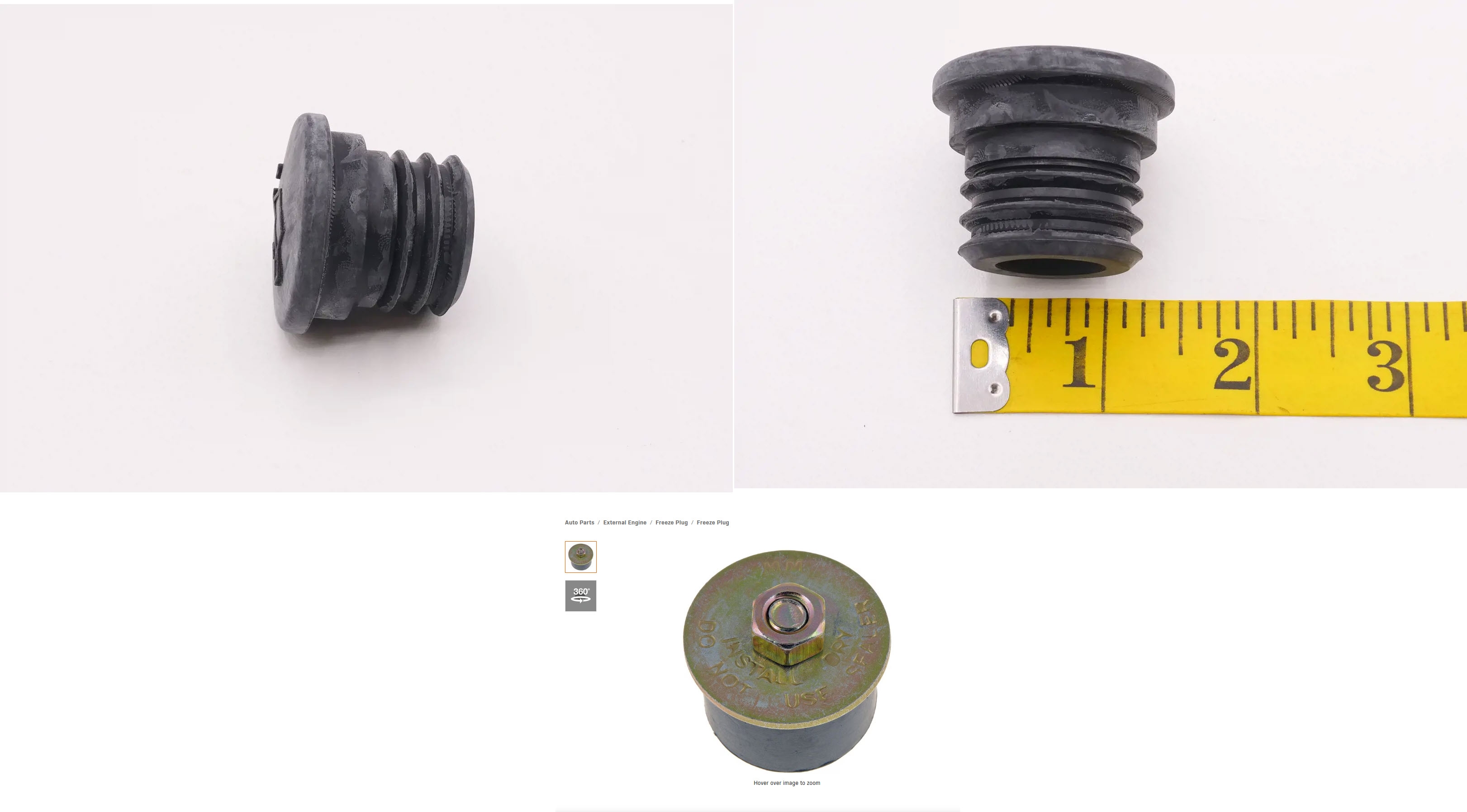

What in heck is a "rubber oil plug?"
this annoying piece of nonsense. Took me days to find it on the diagram. Ordered the wrong thing at least once.
It is just force fit -- those are rubber/plastic ribs on the thing and they get old and then it pops out or falls out as the OP mentioned. Newer models have a proper, threaded oil cap but not these older models.
This is from an L4600 Hydrostat.
1-1/8" expandable "freeze plug" worked nicely. Supposed to be good up to 200 degrees.
