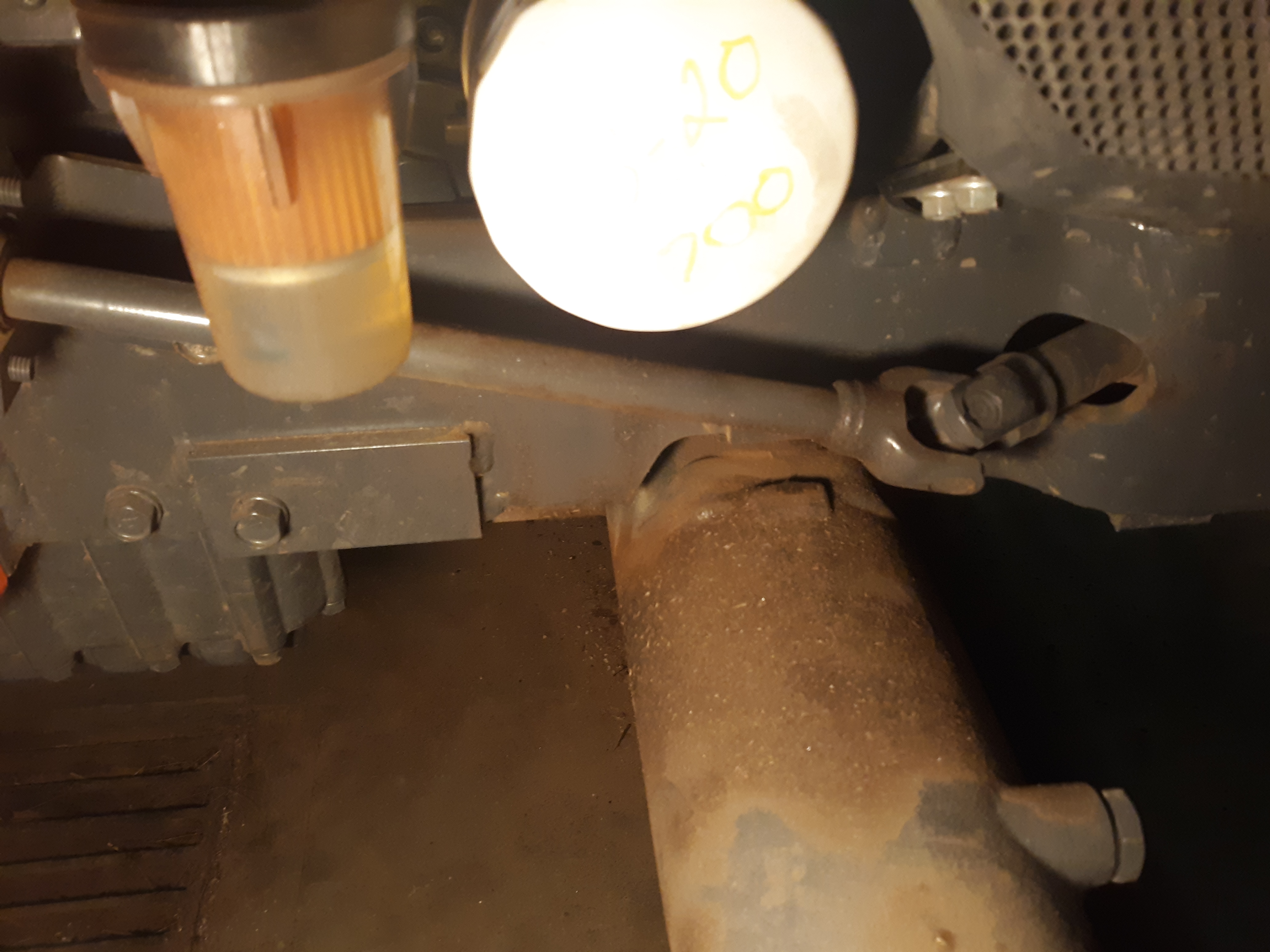

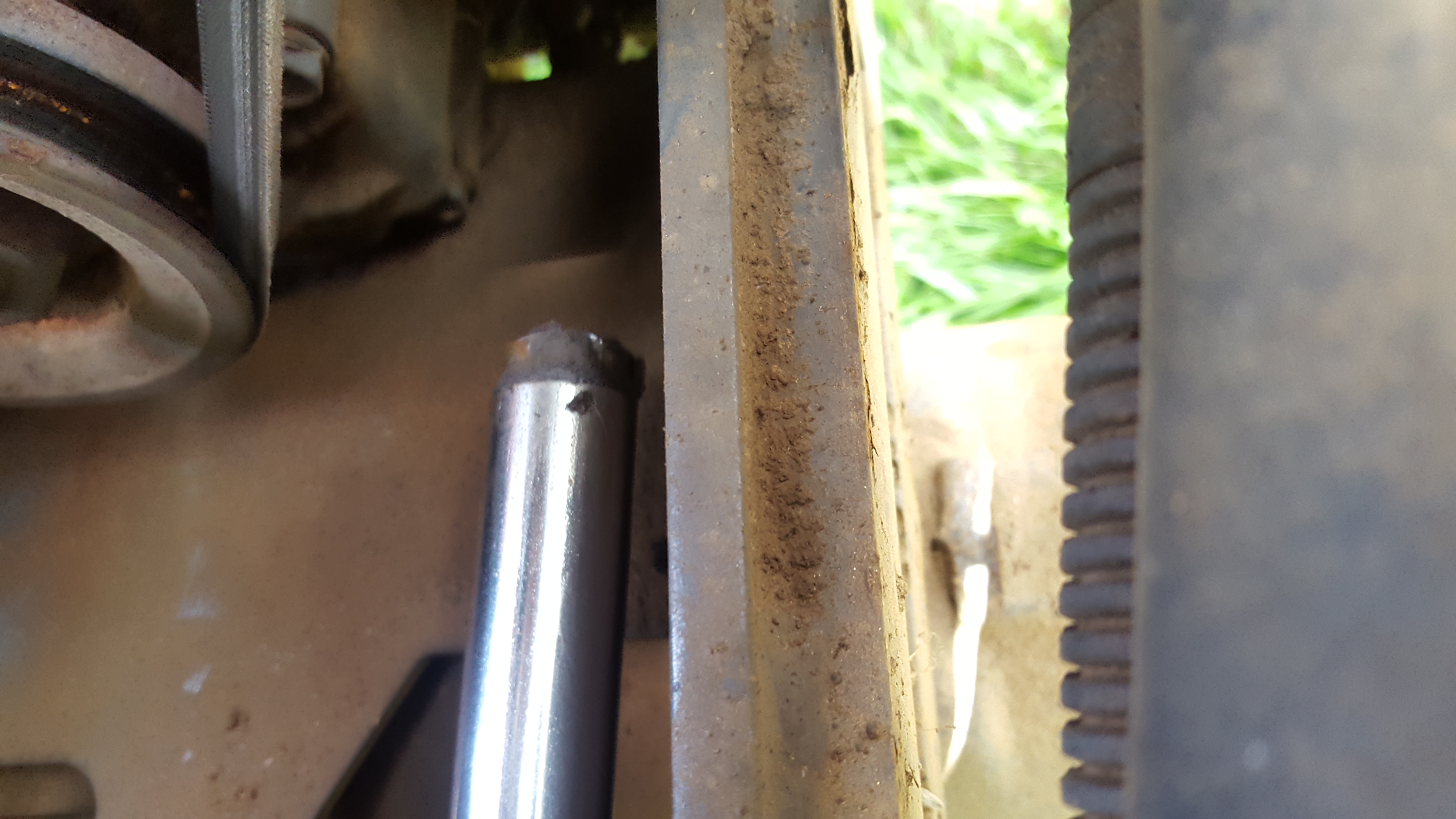

I had just scooped up some dirt and was backing up. I heard a klunk and the steering quit altogether. I can turn the steering wheel freely but the wheels don't move. I couldn't find any hydraulic lines disconnected. All the other hydraulic functions work fine. Nothing at all is leaking that I can see anyway. I have no idea where to even start looking. It's mowing season and I'm in trouble. Thanks in advance for any advice!

My l3800 has a shaft that runs down the right side of the tractor near the engine to the front check that out........
/ Kubota L3600 Steering Quit #3
If you heard a clunk that sounds mechanical. Did something in the steering linkage fall apart?
Don't see anything at all down the right side.

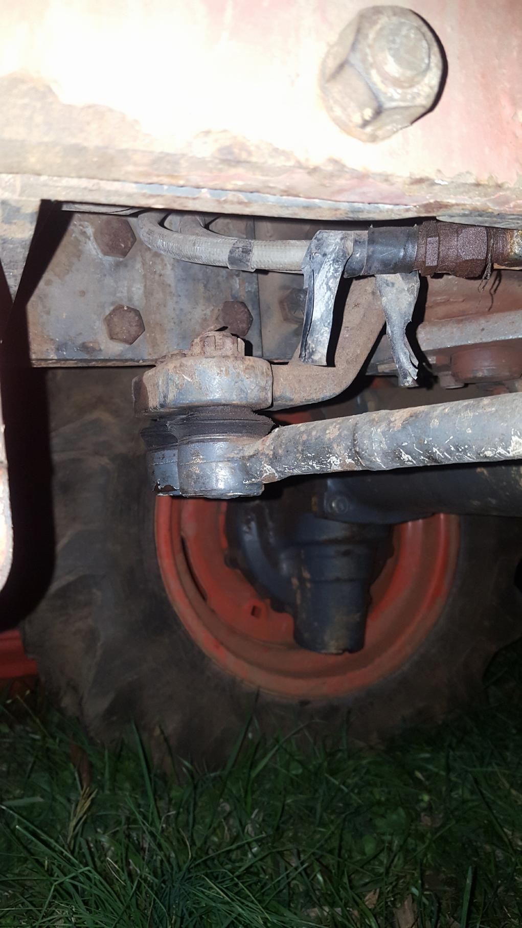

Well I can't see anything amiss. I hate to sound dumb (but I'm so good at it) but the steering shaft disappears down under and I don't see anything where it links to the front wheels, at least visibly. I mean I'm sure it does some how. Of course I can see the rods attached directly to the wheels and they are fine.View attachment 649205

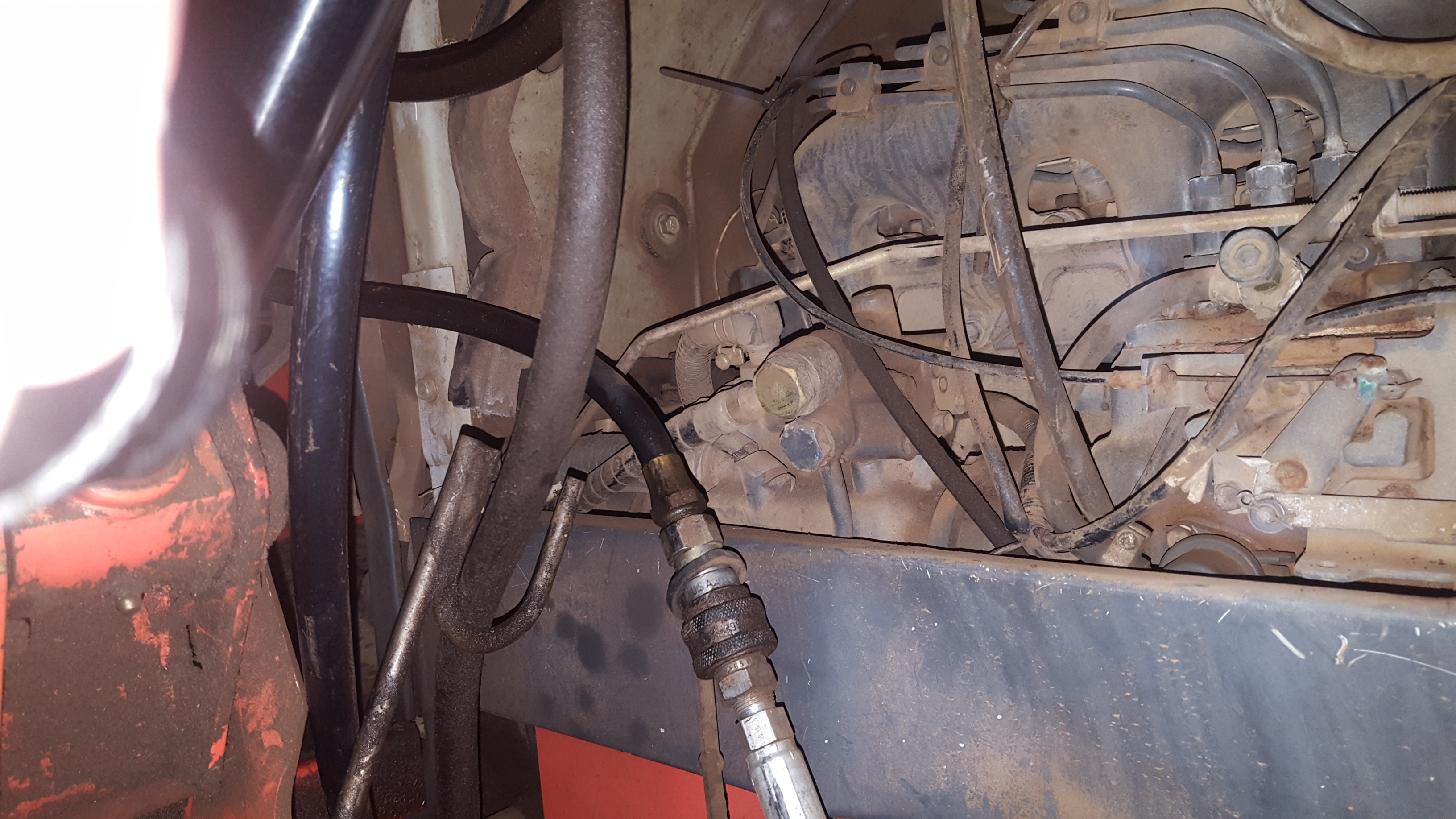

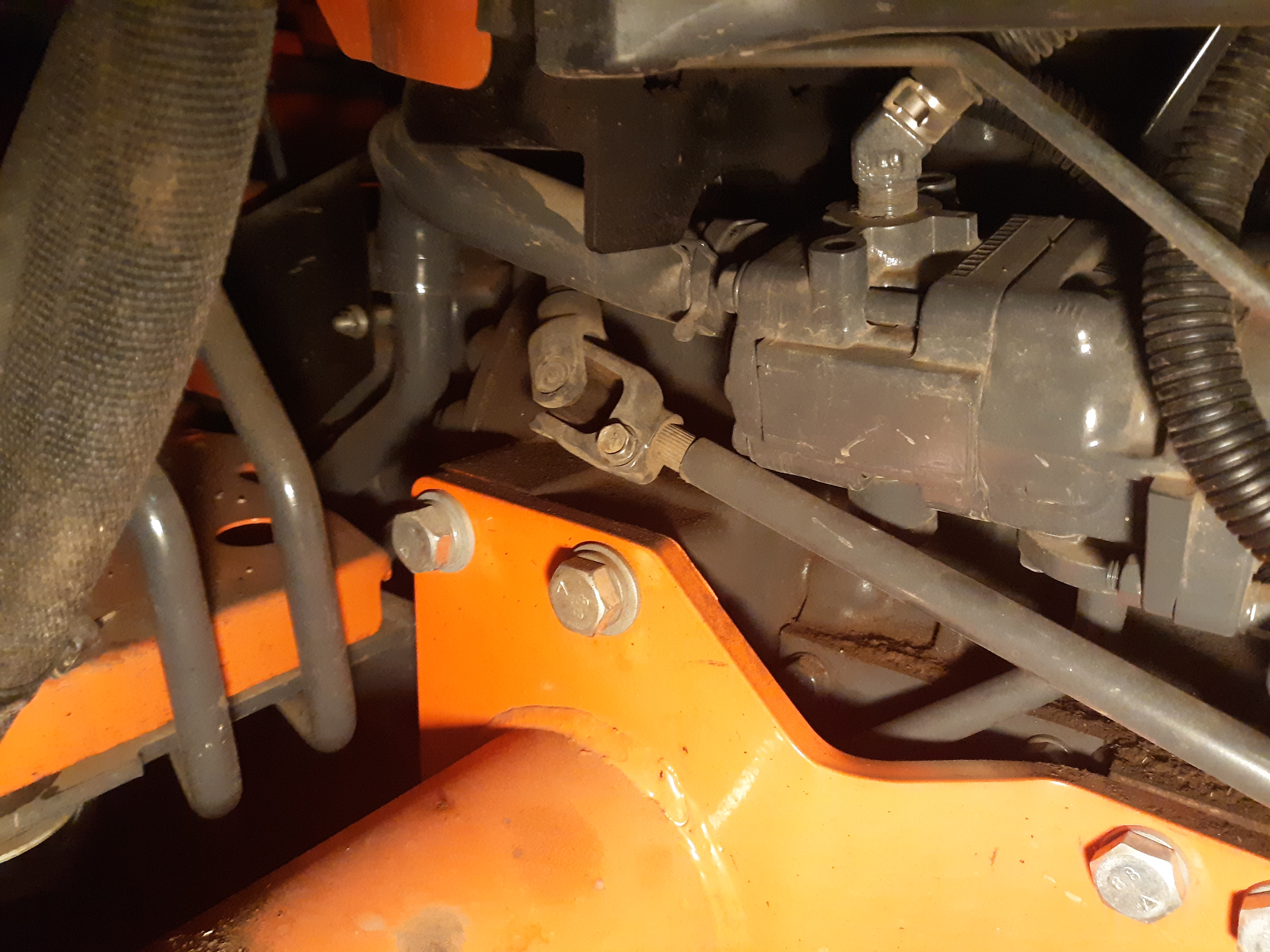

Front axle , front under...
#11

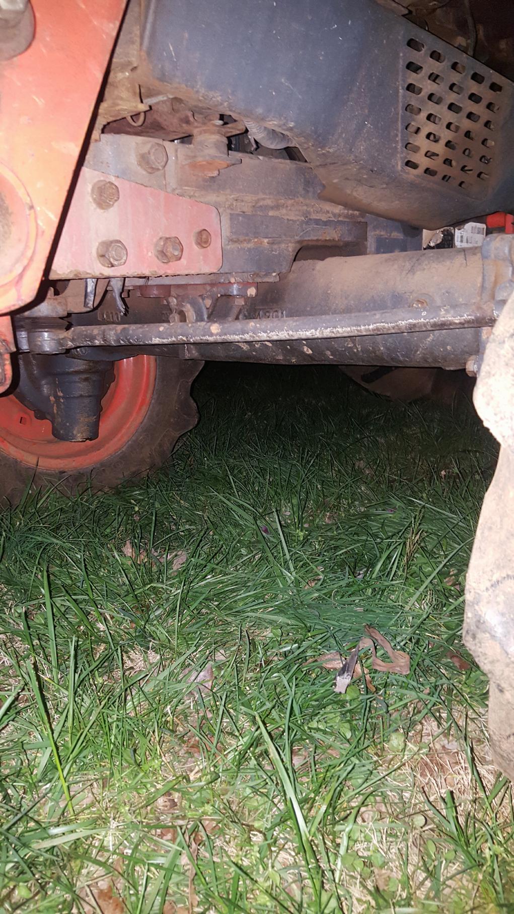

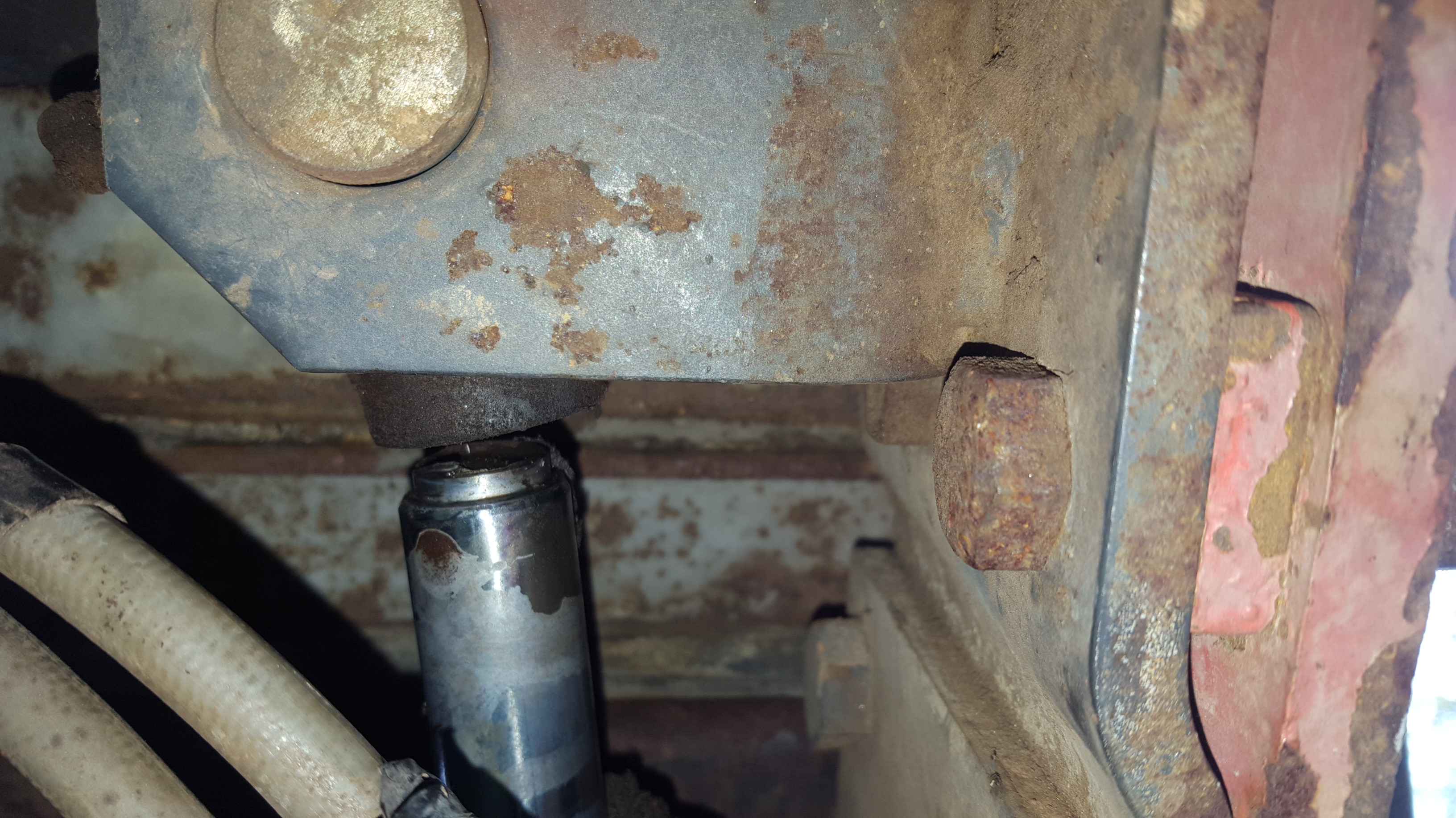

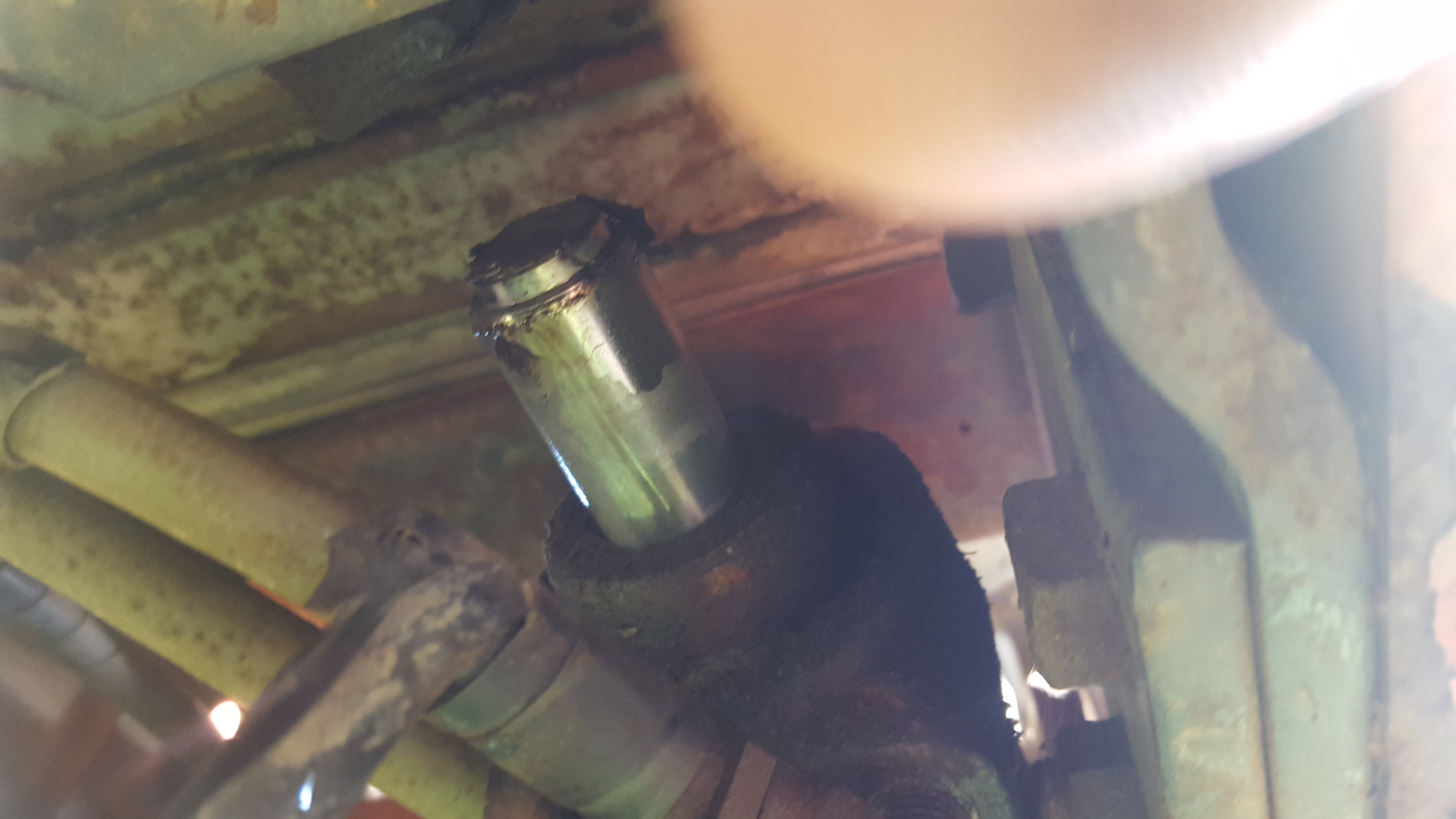

Sorry for the delay. I did the best I could in the dark. The first two are in the very front. The last one is behind and below the radiator. The piston is parallel to the ground. I believe this is what controls the steering but I'm not certain.

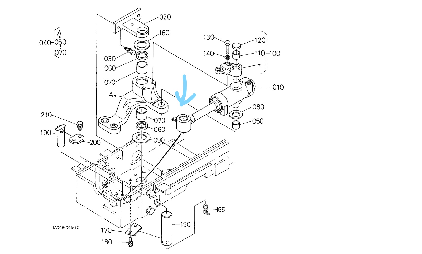

Look at this and see if any parts are off under the tractor ...l3600 parts.jpg
#13
Look at this and see if any parts are off under the tractor ...View attachment 649268
Well that was a big help. The piston in the pic has disconnected from the exact part you pointed the arrow to! Not sure how it connects or what broke. Going back out to look now. Any advice is appreciated.
/ Kubota L3600 Steering Quit #15
Parts 180,170,150 bolts and a plate the pin should come out........

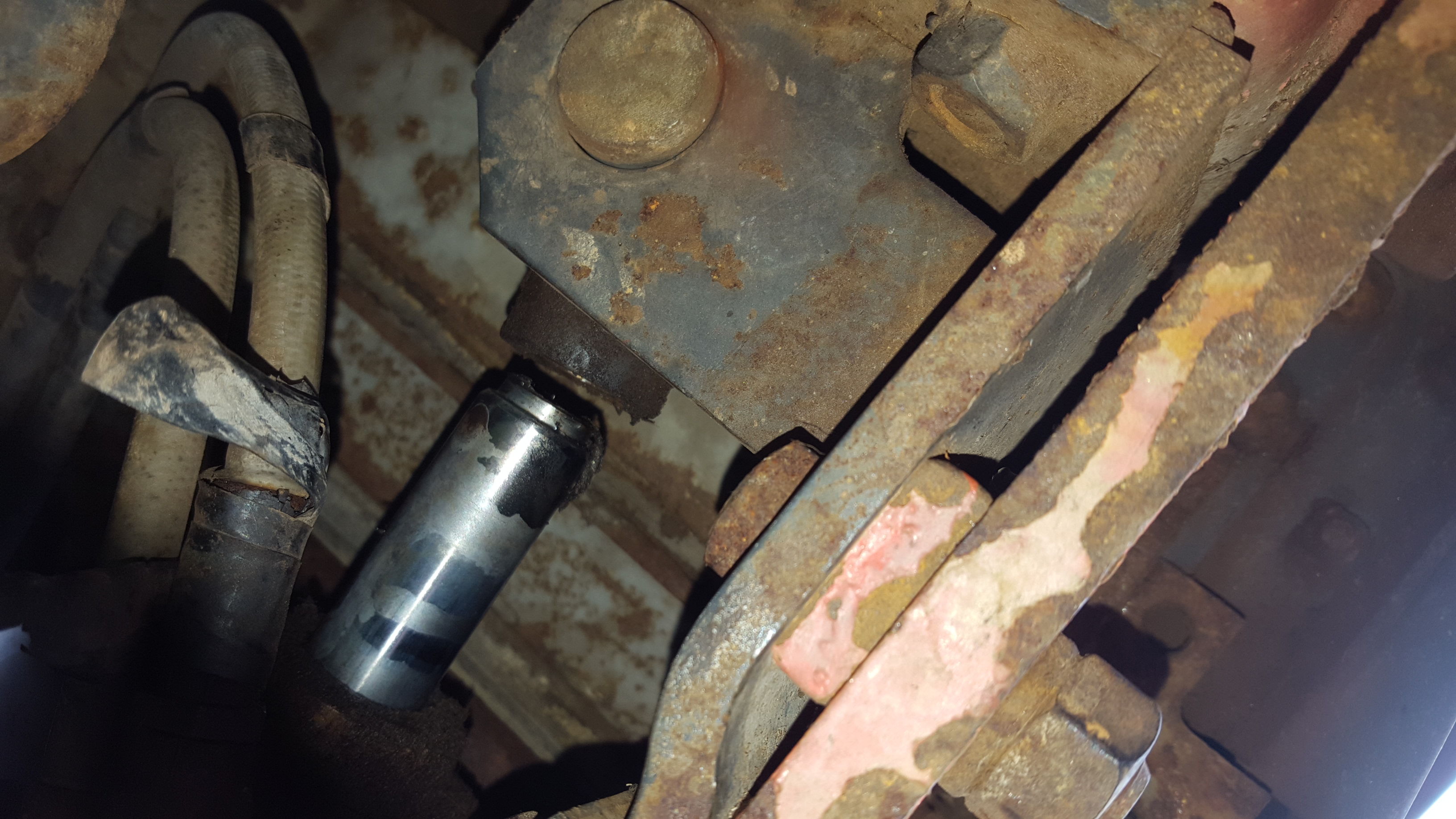

I'm not seeing 170 or 180. Here's a couple snaps of what I'm seeing. I appreciate your help!
/ Kubota L3600 Steering Quit #18
Sorry 190 , 210 200, from the top......
/ Kubota L3600 Steering Quit #19

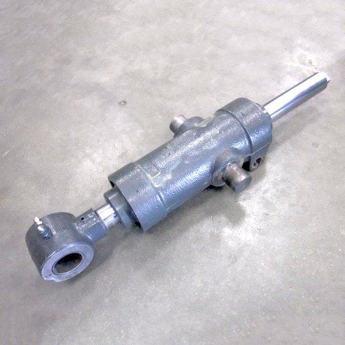

130,100 plus hoses to get piston out.. looks like this....steering-cylinder- l3600.jpg
