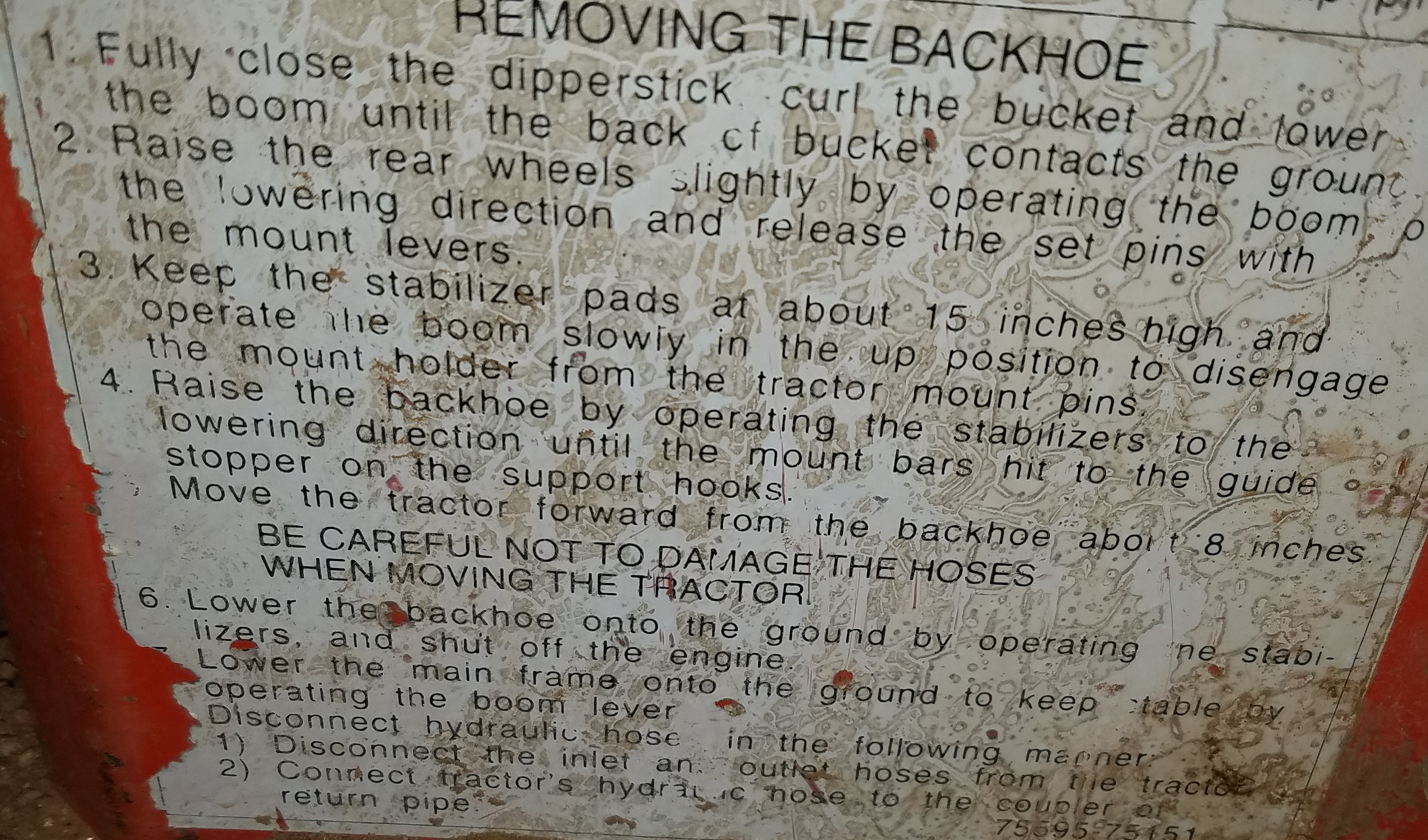

Hi! I bought a used L35 and it appears the backhoe has never been taking off. For the love of all creatures big and small!!!!! Why will my backhoe not come off? I have followed the directions on the actual backhoe to a T (and tried other suggestions with information I found on the Internet) and while I am able to release the set pins with the mount levers, nothing budges when it comes to the backhoe coming off. Mind you it took me about 5 hours to just get the mount levers to break free and move from their posts. Seeing this is the first time attempting this, I used a half can of Kroil soaking everything - From the mount holder, to the mount pins, to the mount levers, etc. I actually backed the large bolts on that are part of the mount holder (I believe) and sprayed Kroil in there. (Side note: Has anyone installed a zerk on the bottom of the mount levers? I really do not want to spend the time again getting these to move). Talk about going from crazy excited to f'ing p*ssed in 2 seconds; After I finally got the second mount lever to break free, I thought I was done. Uggg!

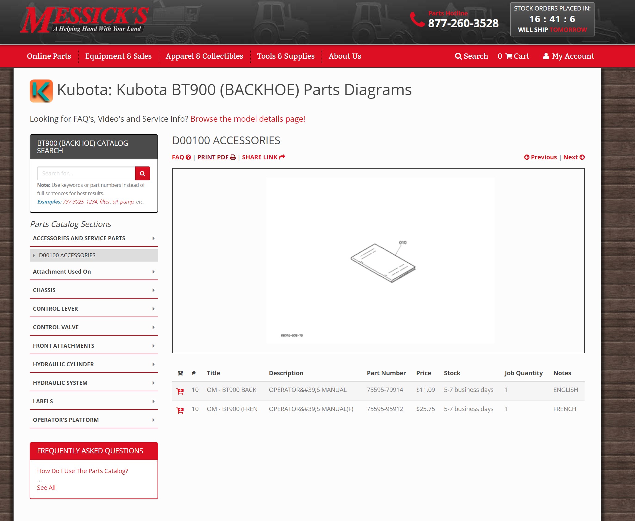

There is an online parts diagram of the BT900 on the Messick's website, if that's of any help (Kubota BT9 (BACKHOE) Parts Diagrams). It looks like the L35/BT900 uses some kind of clamp with a release lever to hold the backhoe in place to the tractor's subframe. I could well understand that if the previous owner never took the backhoe off, all that stuff is pretty well seized in place.
If you've never done it before, one thing that may not be obvious is that you don't want 1,000+ lbs of steel just falling to the ground when the pins are released, so it's designed so you have to use the boom and outriggers to gently take the load off of the mounting points before things will loosen up. This video shows some guy doing that with a different model, but the concept is the same for any backhoe (KUBOTA L424HST 3 WITH KUBOTA BH92 BACKHOE REMOVAL - YouTube). Different backhoes have slightly different ways of aligning and releasing the tension on the mounting points and you'll have to eyeball your setup to figure out what to do. Mine was similar to the video, where you put downforce on the boom and then you inched the outriggers up so the frame of the backhoe dropped slowly away from the tractor.

I looked at the Messicks online parts diagram too (thank you Messicks). The setup is exactly the same as my B21. I took the backhoe off for the first time after 12 years. A couple days of penetrating fluid and using only hand pressure on the levers, that got it done. The levers, pins, springs, jaws, and moving locking block were all stiff but eventually opened up. After I got the backhoe off, I took all that stuff apart and oiled it up with Fluid Film, it has been easy ever since.

Edit - I am tired... I completely missed how nice this site works. When you wrote "uses some kind of clamp with a release lever to hold the backhoe in place to the tractor's subframe", which diagram were you looking at? Was it the B00100 MAIN FRAME?

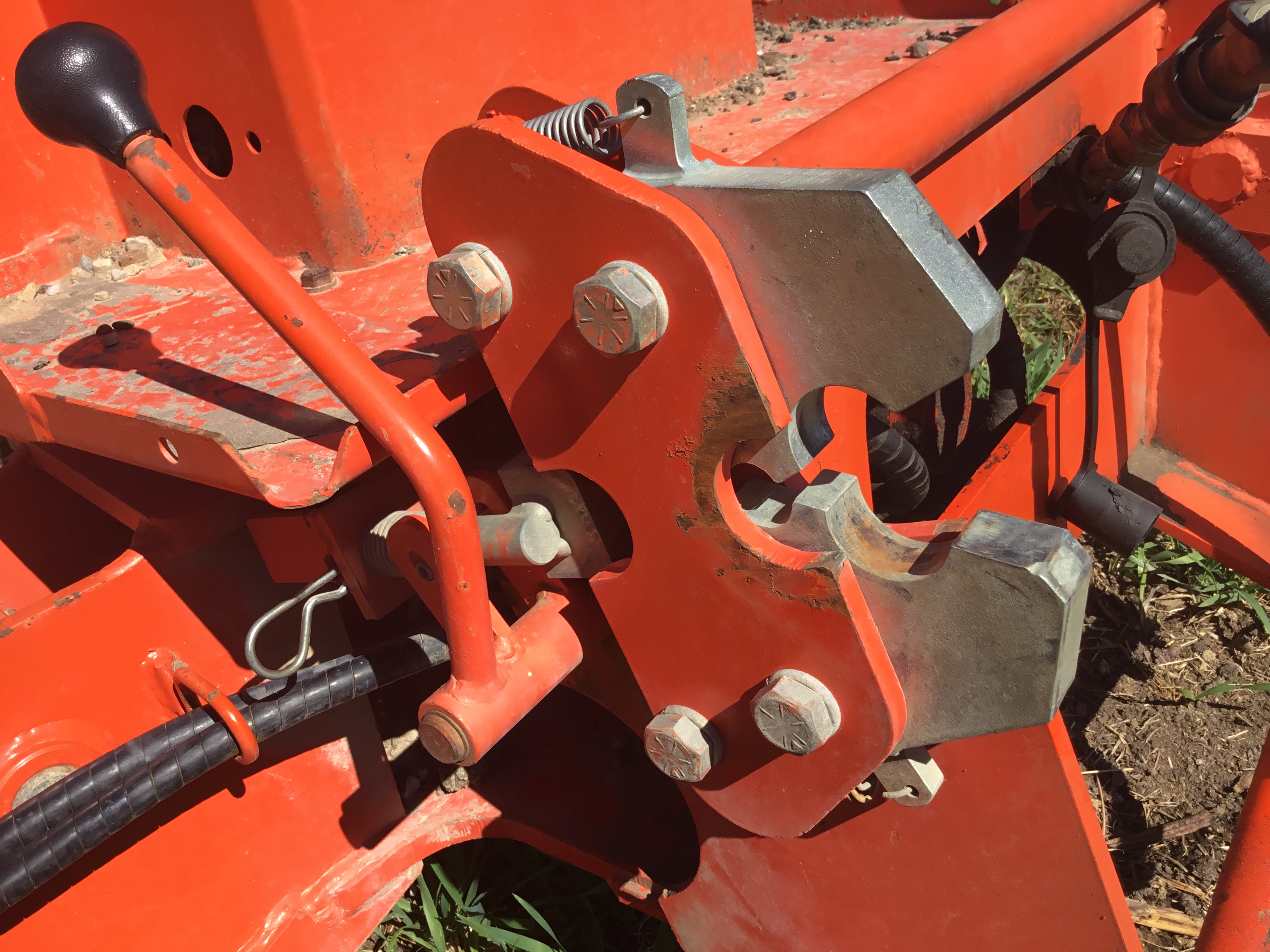

Ok.... After a semi good night of sleep and looking further at B00100 MAIN FRAME diagram, we are talking about the same thing.... Yea - Progress! When I originally stated in my first post "release the set pins with the mount levers", those are 140 in the diagram. They are now moving freely back and forth taking the Pin Sets (50) out completely. But as I said originally, nothing happens. Here are the directions I am using and for some reason it is not disconnecting... The plot thickens...

You are on the right track. Pins out, good. Levers moving, good. When the levers move they shift a locking block out of the back of the movable jaws that grab onto a cross shaft. The movable jaws are spring operated and will open up off of the cross shaft on their own. UNLESS the jaws are crudded up. If so, the springs are not strong enough to open them. So you need to get good penetrating oil on those jaws (all four of them and both sides of each jaw = 8 applications). Then tap and/or pry with a hammer and punch to get a little movement. It might take a couple days and several tries but eventually those jaws will open up.
also after you move the levers you need to RE-insert the pins to keep the locking blocks from going back into the locked position.

**** I am close... I thought that is what was going on with those springs... I kept saying to myself - they have to do something. I even backed off those 2 large bolts on each side a little to get Kroil to seep inside. But bottom line, they are movable jaws that need to "open" and let go! I can't thank you enough for confirming what I was thinking.... Now I know where to go!!!!!! Wish me luck!!!!!

If both levers are free and are pulled back all the way I don稚 see why it won稚 come off with proper hydrologic operation movements.
I guess possible rusted where the silver clamps meet at the orange shown in pic could be.

The jaws do get stuck. But once the jaws are open a little you can move the boom and use the weight of the backhoe to force them open all the way.

Photo helps visualize. From the way this looks, once the locking pins are released, it seems like you could use down force on the boom to help pry open the jaws, right? Maybe soak the jaws with your favorite penetrating oil for a couple of days first, spend some time tapping with a ball peen hammer (the vibration from tapping helps loosen bound up crud).
Must be a son of a gun to work on this while the BH is still on the tractor. Please be careful while trying to get it to pop loose. If something shifts unexpectedly while fingers, hands, feet, etc., are in the wrong place, it could ruin your day.

I had the same problem with my L35. The backhoe just would not wiggle, and I suspect it had never been removed when I bought the tractor a few years ago. Even after a couple weeks of soaking the attach points with LPS-2 and other penetrating lubricants I couldn't get it to move. I finally fully extended the hoe, then bounced the back of the tractor with the hoe extended, lifting the rear tires off the ground in the process. That did it, and the backhoe came off easily from then on. You'll have to "roll" the backhoe off the tractor, by using "raise boom" hydraulics to rotate the top of the main frame away from the tractor (the mount holders will open up as you move the top of the main frame away from the tractor), then use the stabilizers to lift the hoe main frame out of the bottom attach points on the tractor.
I've removed and installed the hoe a dozen times since then (to attach a woodmaxx chipper), and I can remove the hoe in a couple of minutes now. Installing it takes a little longer because aligning the hoe with the tractor takes a bit of time. Maybe this technique will work for your machine too.
