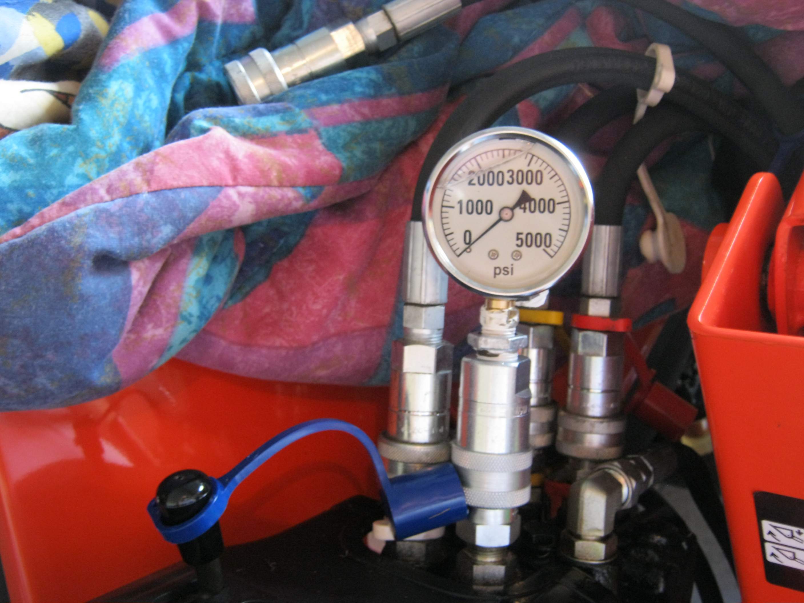

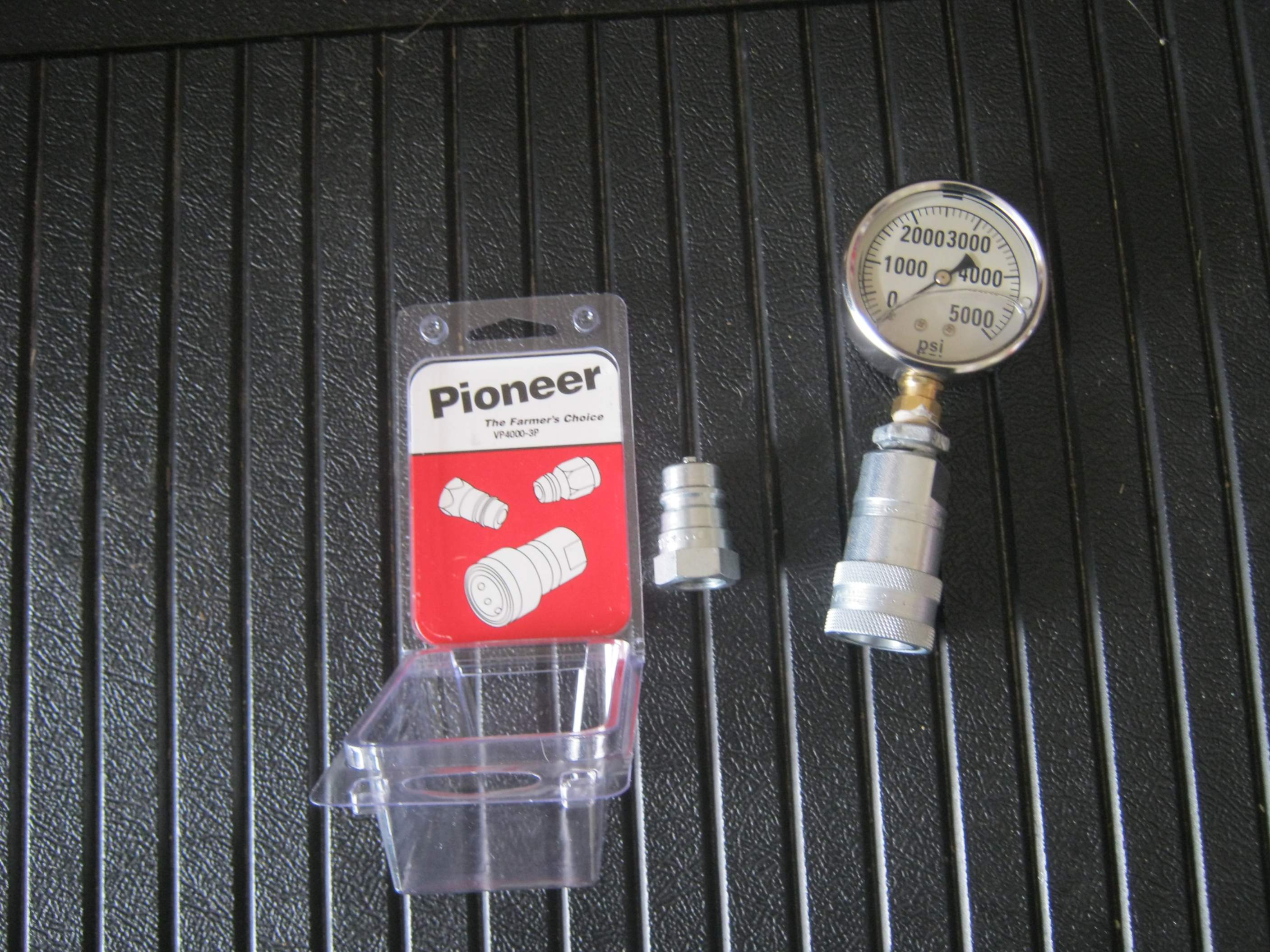

Just for starters have you tried checking hydro flow with wet guage to see what its reading ?
Boone
No, I haven't found a flow diagram or any other info about the 3400 hydraulics. Would a service or repair manual help me with the information on all the elements involved to isolate the leak path?

Don't know but I would be curios to know what wet guage reads hooked up. Someone(s) here (TBN) will know,be patient I 'am sure good advise/experience comeing.
