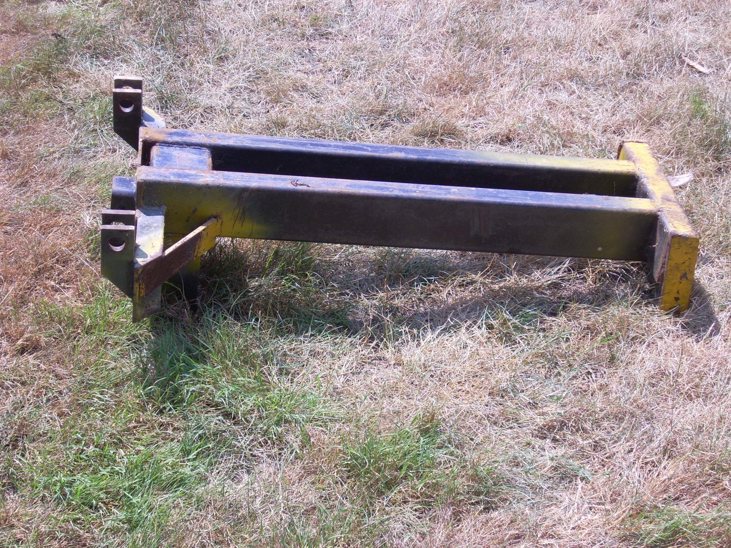

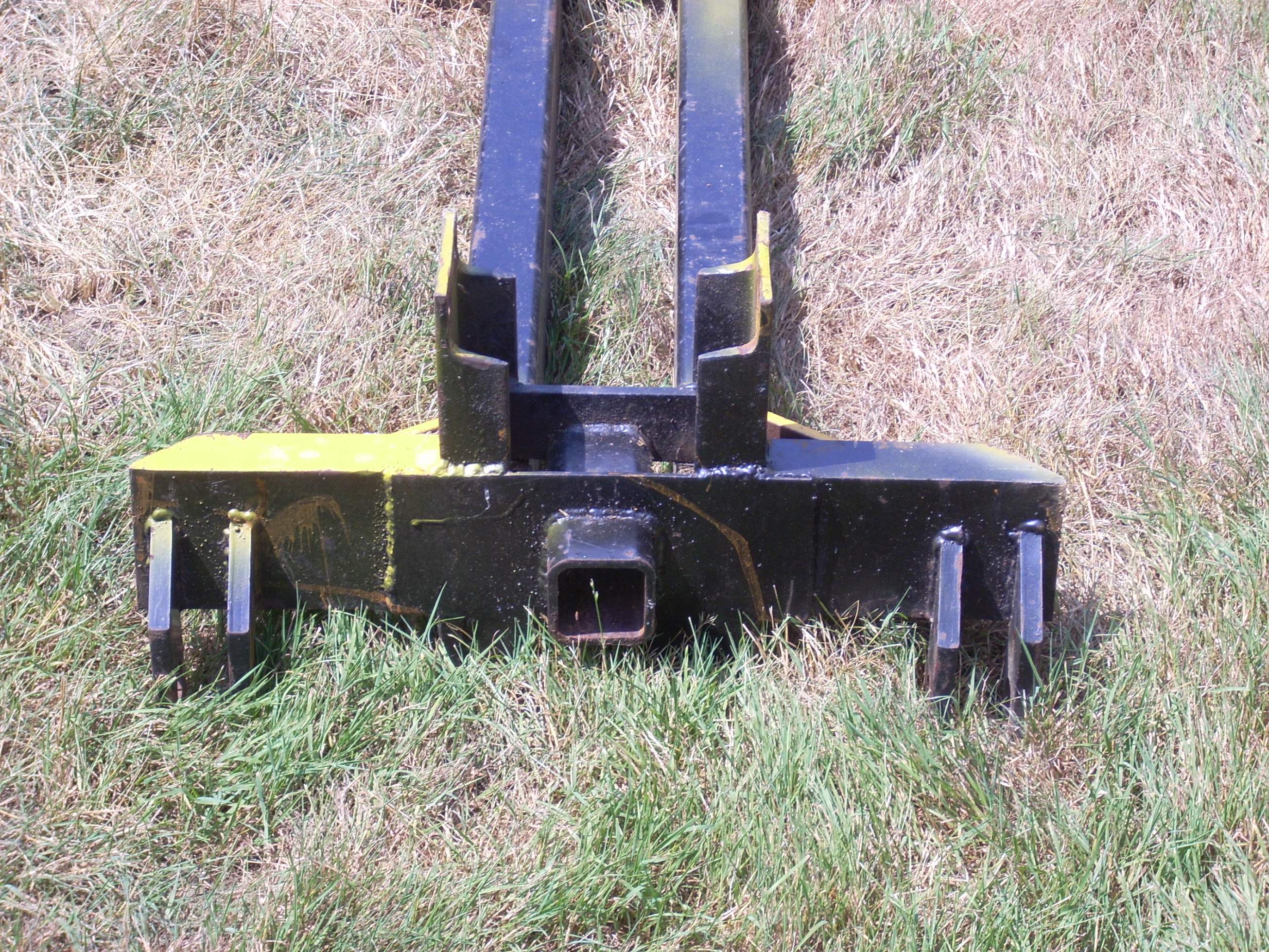

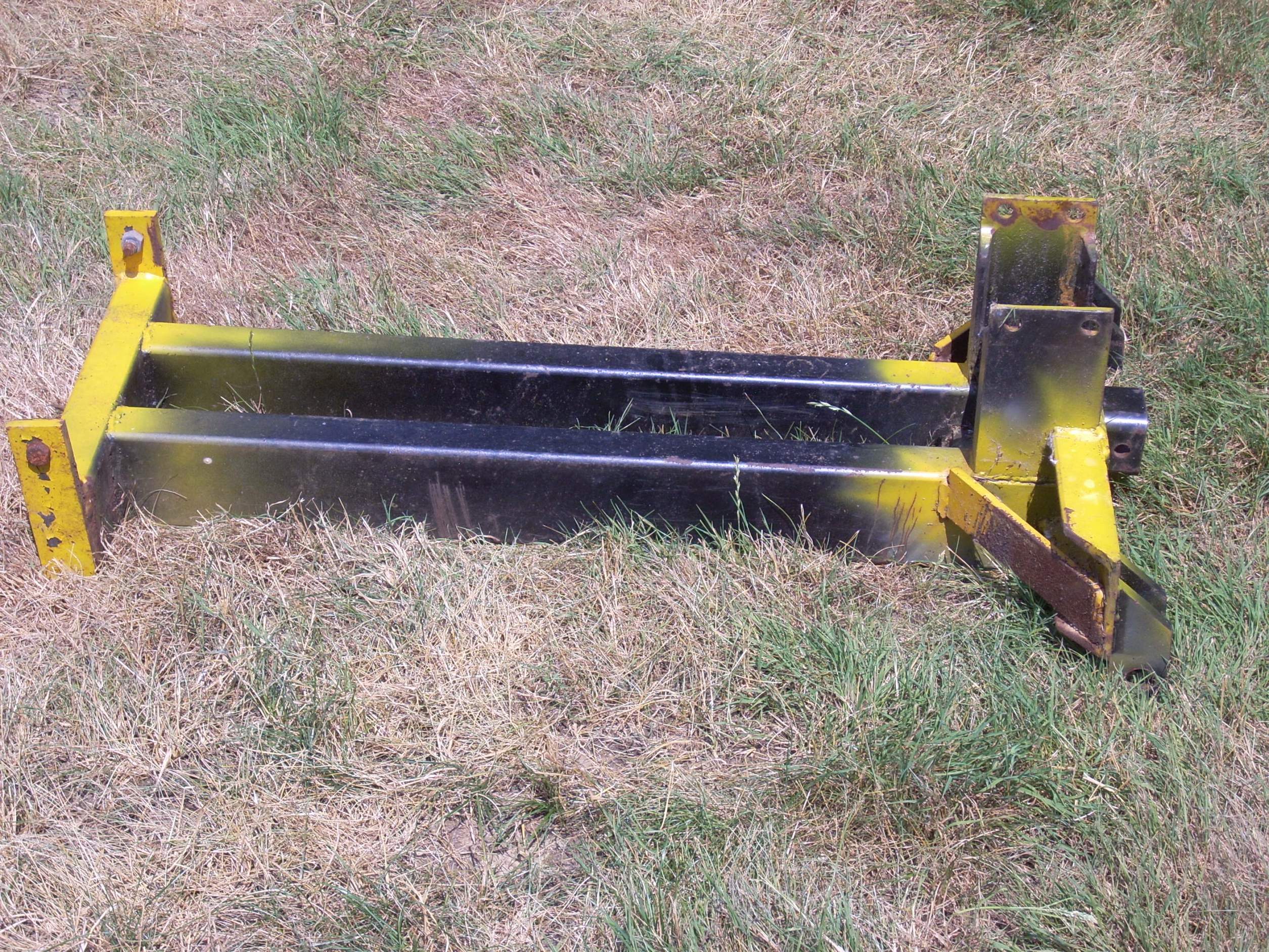

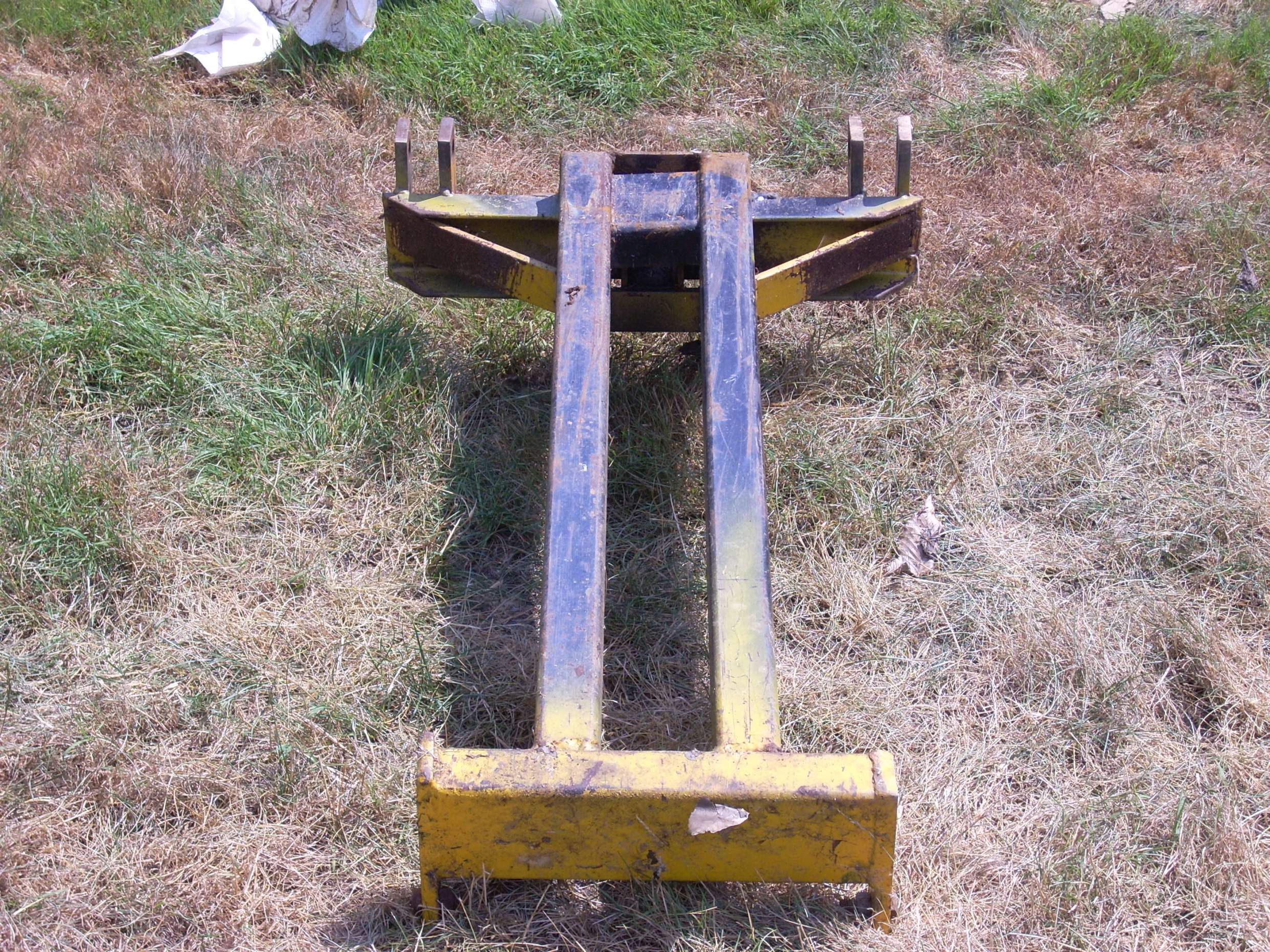

View attachment 352994View attachment 352995View attachment 352996View attachment 352997
This is the Sub-frame from the b7510 we used to have. I think there are pictures still on here.
Plow Mount Build Thread
North- I'll have to get some of the L3400 though. I built it specifically so that I didn't have to mount it to the loader arms. I felt it was much strong connection and it made manuvering a little easier as well. I wouldn't ever put a plow on a Quick Attach unless it was on a skid loader. I have used the subframe for 3+ years now and It will easily push a 7.5' plow till snow is rolling over the top. I can still stack snow pretty high and I have no issues running into a solid bank and pushing it back with the way I have it mounted.
Let me know if you want any pictures. The only I would change is that I built the lift post out of 1"x1" tubing and I bent it one morning when I picked the plow up while it was frozen to the ground. :confused3: Lesson learned on that, bump it first to break it loose then lift it! lol
