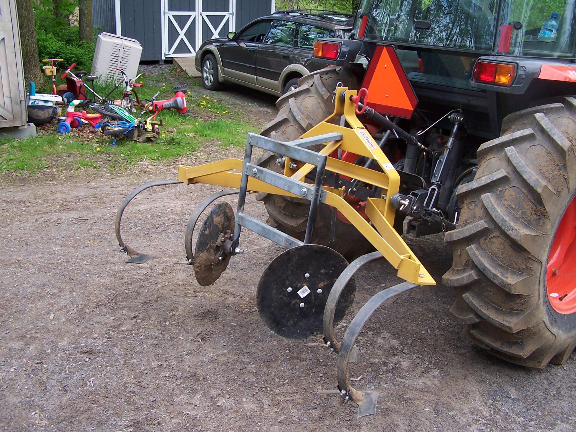

I added a hiller to my cultivator and remove when weeding.

And I also stole 'nybirdman's" idea. That implement resides at my BIL's place as he plants the potatoes and corn(I plant the rest of the stuff).

Just wondering if you realize your disk are on backwards, the concave side facees into dirt to form hill.
