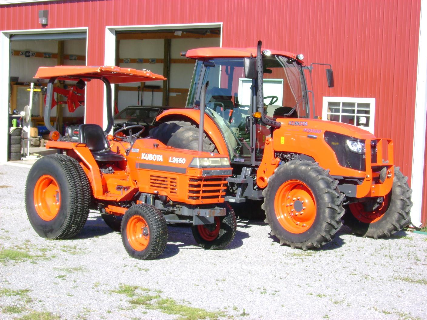

/ kubota L2650dt #3
Look another L2650dt
