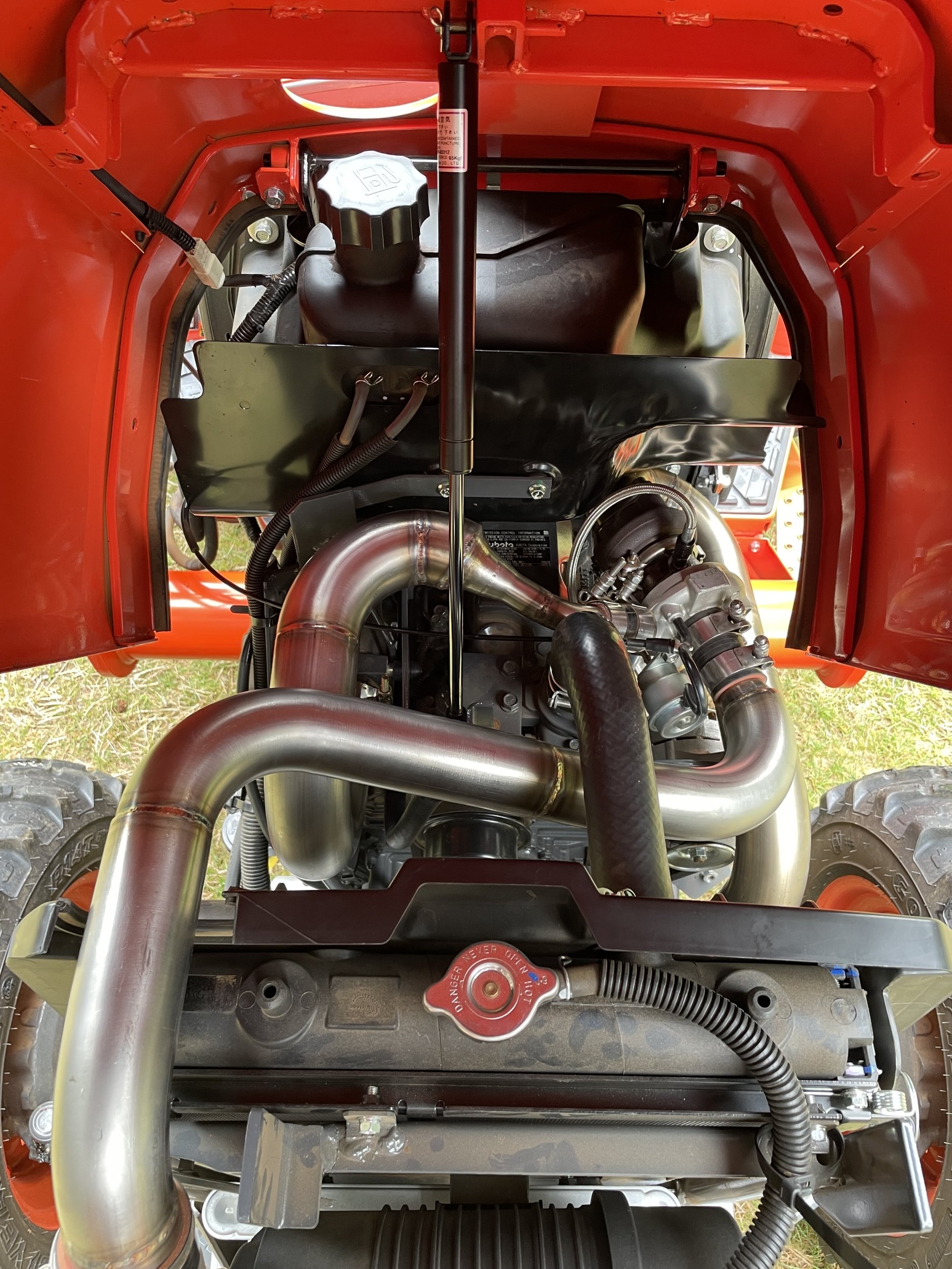

Well, it could still be the right tractor if you choose to modify the L2501. My L2501 is equipped with a Turbo Kit and produces 44 HP and 35 PTO.
With the Turbo, the L2501 produces more than enough power and continues to be just as reliable as stock.
Mike
Can a Turbo kit be put in after sale and avoid the Regen?
Absolutely! No regen whatsoever.
But, as mentioned, it will void your factory warranty if applicable.
The L2501 is practically bulletproof, so, I threw caution to the wind and installed the Turbo Kit soon after I purchased my tractor.
Mike
