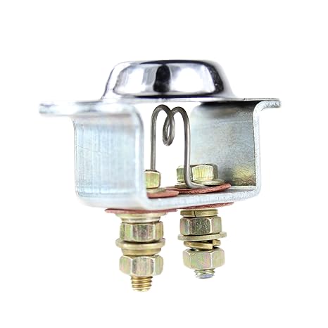

Thanks for decoding the lights for me. I was only guessing what the light on the left was. There is a metal ring on the right next to the tachometer. Is that where the glow plug light should be? There is an empty hole and no light has ever come on that I have noticed.
It’s not a light per se. It’s a coil of wire that glows red when hot that should be under that metal ring. If there is no wire in there, that might be a problem. Pete’s says glow plug indicator is in series which I think means your glow plugs won’t work if the indicator is missing or loose. Electrical is not my thing though :p
   / Kubota L175 Won't Start #15
This is typical of what a glow plug indicator might be (comes in many different forms though)... As current flows through coil of wire to heat glow plugs it also heats coil of wire in indicator, its like a pilot lamp for a "on/off" switch... If unit is missing (if it originally had one) or damaged or glow plugs (all) have failed you will not get a glow indication that may be indicator of problem...
And if functioning properly may look similar to this...

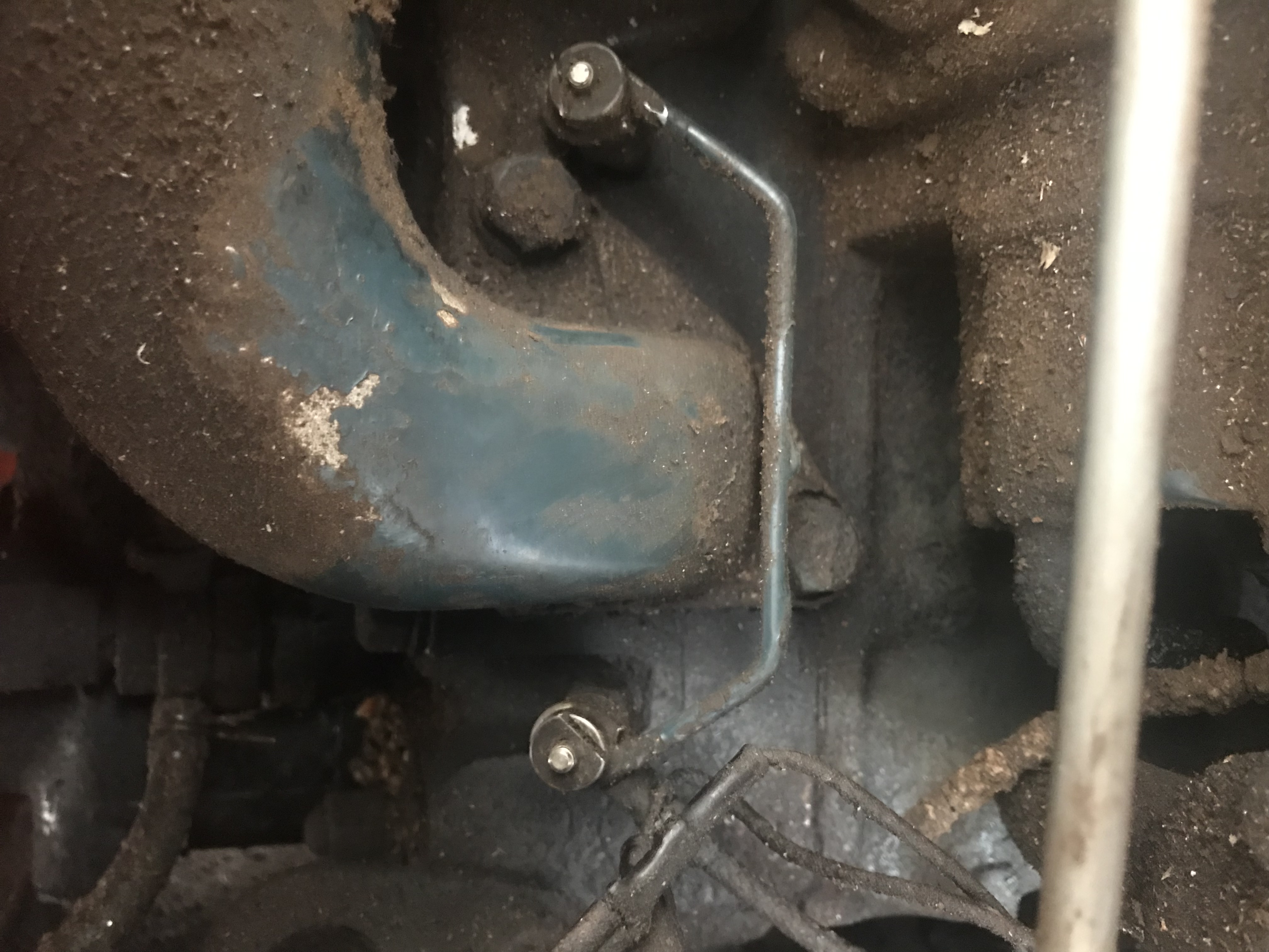

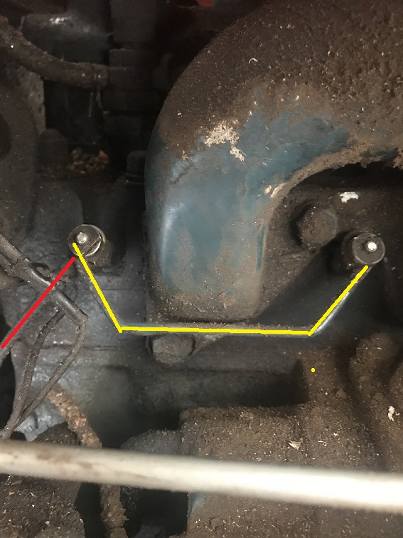

Can you tell me why it is said the glow plugs are wired parallel when there is only one wire going to the first plug that is jumped to the second plug? IMG_8458.jpg
   / Kubota L175 Won't Start #18
Because its next to impossible to wire in series..... Series would be one after the other like those Christmas lights where one goes out and they all go out.....
Parallel mean they each get their power from a common buss and their ground from a common source (head of engine)...
The buss highlighted in yellow is what supplies power to second glow plug, this is what makes GP's in parallel....
