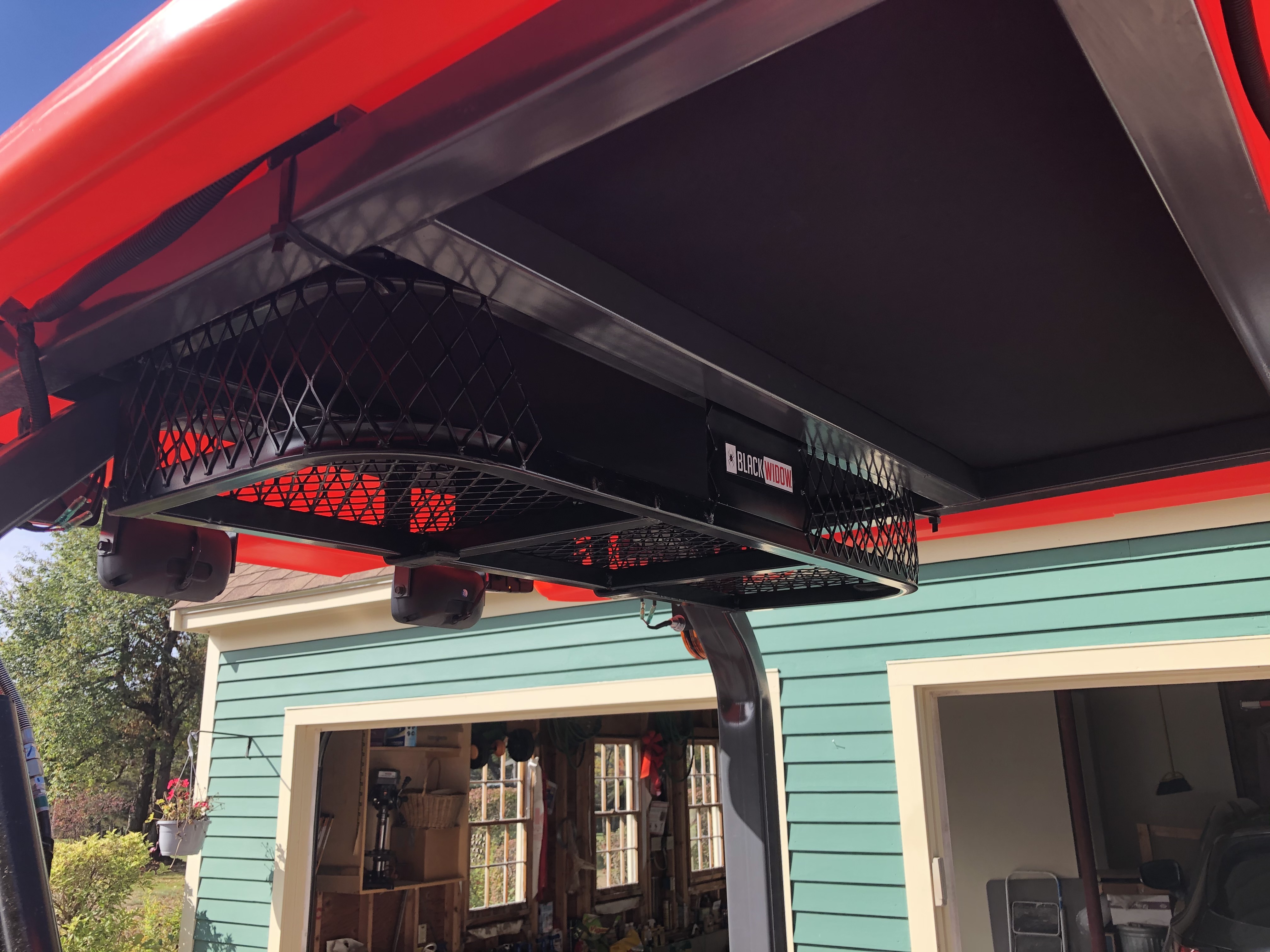

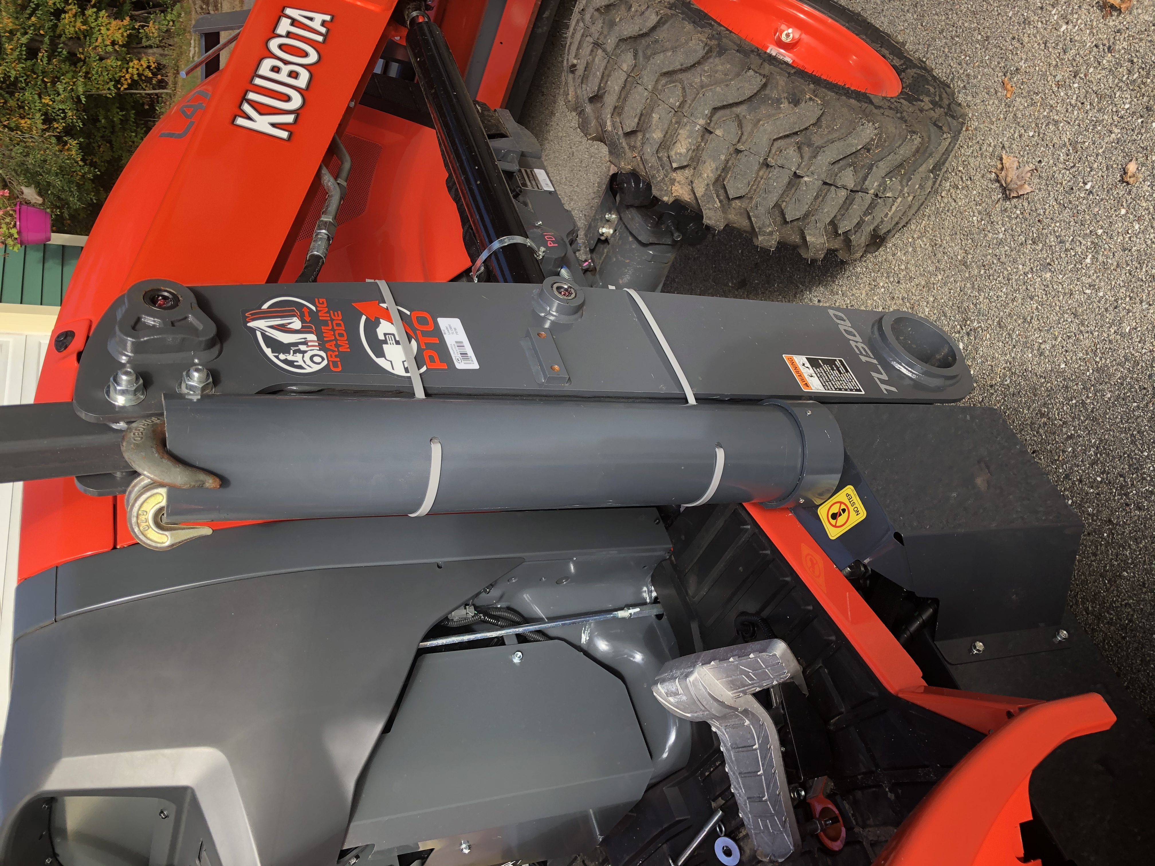

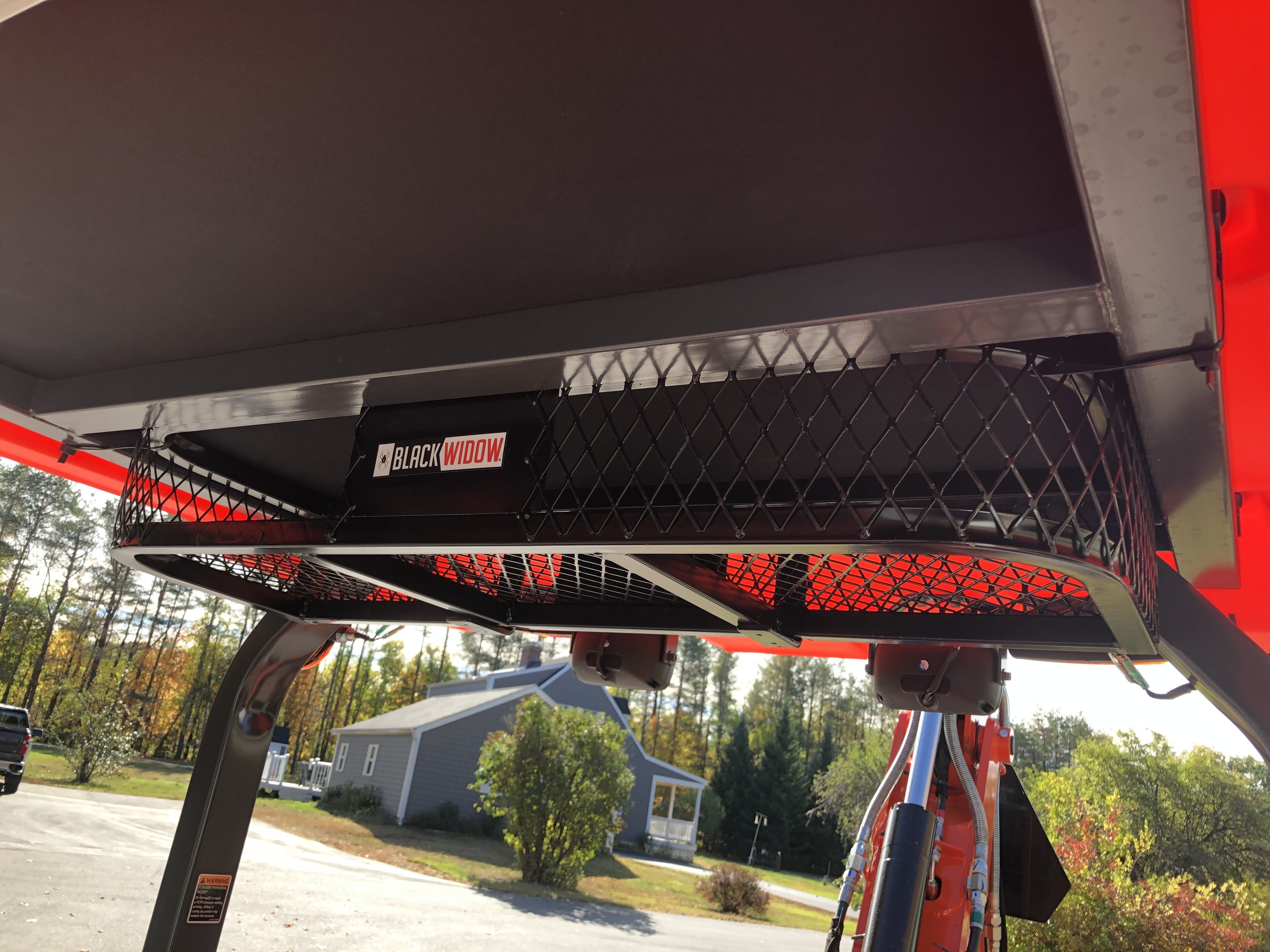

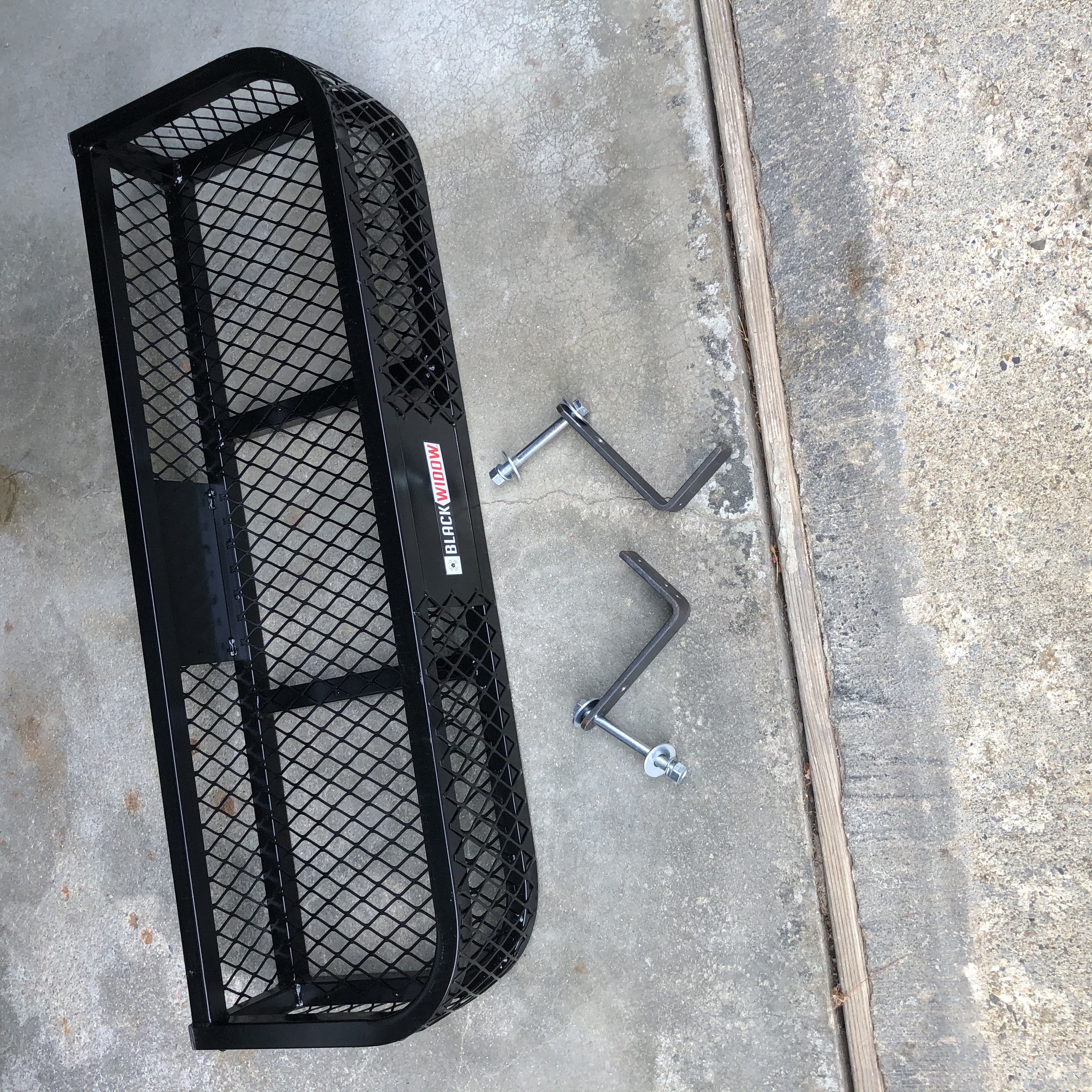

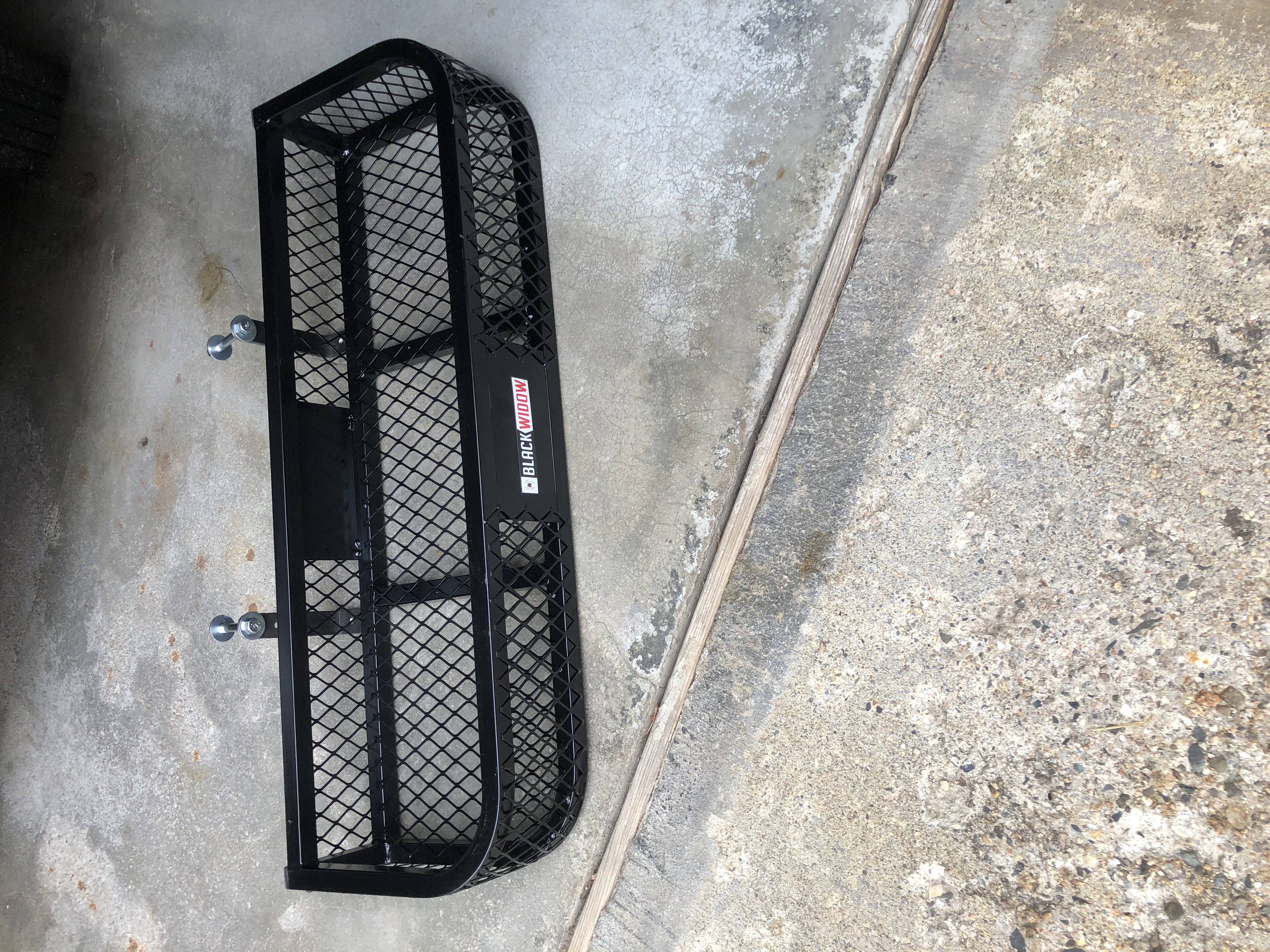

Hello everyone - here are a couple of things I have done to increase storage on my new L-47. 1. - 4" PVC pipe with bottom cap for chain storage (I got this idea from another poster here on TBN). 2. ATV mesh basket for under canopy storage. ( I bought a 13" wide x 37-1/2" wide x 6-1/2" deep ATV mesh basket on Amazon-for $112.00 and mounted it using L brackets and existing bolts on rear of canopy support and heavy duty zip ties for front of basket. I then cut out a portion of front edge of basket and filed any sharp edges and and re-painted to touch up.) So far - have been very happy with my increased storage.

I love that chain in the tubing concept. You did drill drain holes?

Yes, did drill the drain holes.

OK, I’m going to ask a dumb question because I’m probably missing something. It seems to me the basket is mounted flush to the underside of the roof. How do you get things in and out

I cut out a section on the front side - appx. 10-12" long. If you look at the photo - where it says "Black Widow" - it is just to the left of that.

Because fire department aluminum fiber wrapped 4000 PSI air cylinders have a "lifetime", they are drilled and discarded after a certain number of years. I attached one similar to the way HK did about 10 years ago. I cut the bottom of the cylinder off and removed the stem and mounted it upside down. Works fantastic, drains well and the aluminum does not rust.
