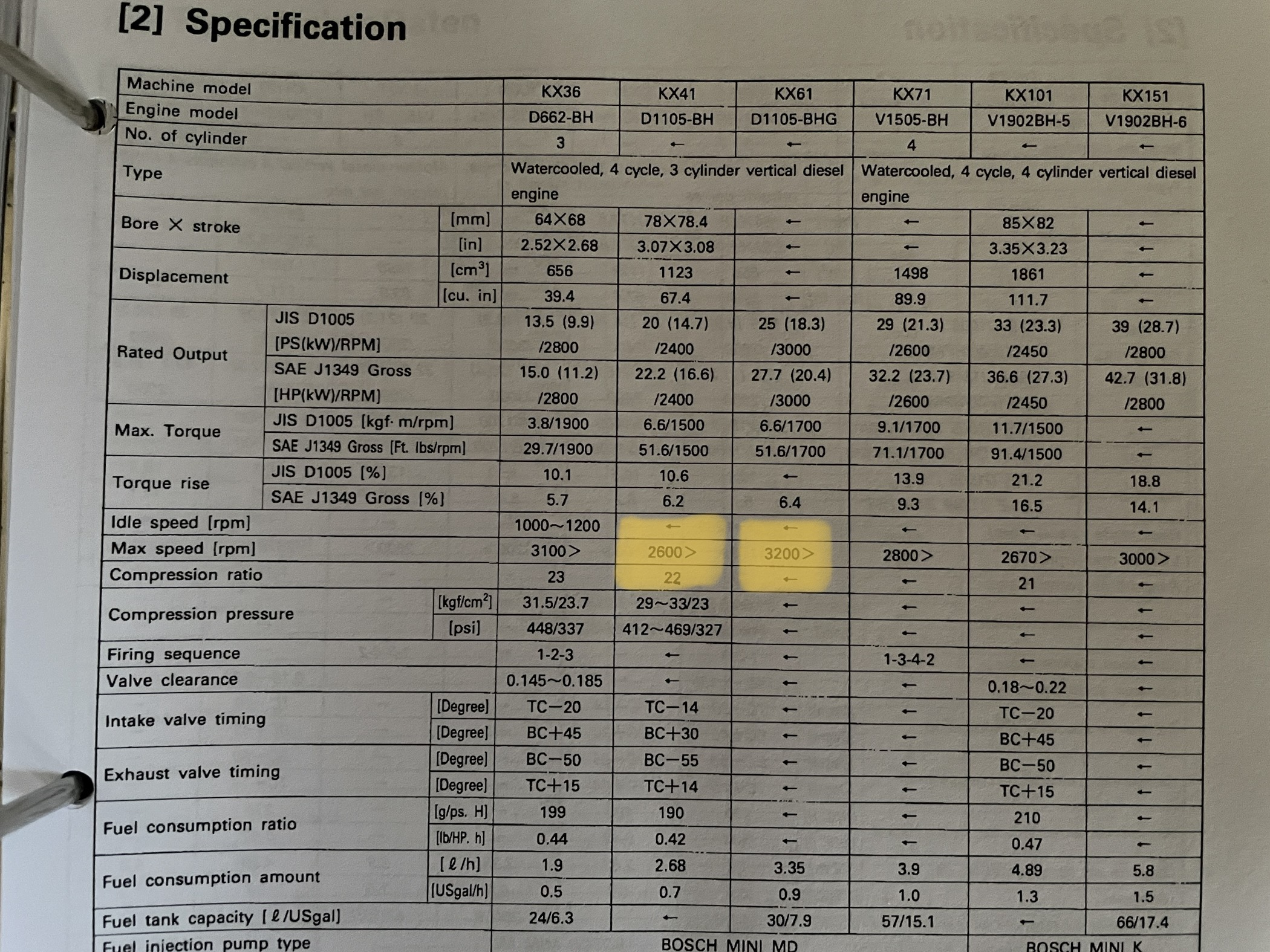

Everything I can find says that engine is rated for 2300 RPM not 3000. What if you drop the rpm to 2300 and see how it works.
Someone may have adjusted the throttle stop thinking they were increasing power. Or could the governor be going full bore without a load causing a increase in RPM?
After watching the first video again and it was started at max RPM, at the start it was about at 2300. Then it started over revving slowly until it reached 3000 RPM.
If it revs high enough for the valves to start floating you would lose power. If fuel is not a problem, then I would start investigating the proper max RPM setting.
Yeah, you're right - kind of.
Max RPM for the D1105-BH in the KX41 is 2600RPM.
Though, from what I've seen, the D1105 comes in various configurations for different applications and max RPM ranges from 2300-3300.
I see what you are saying but notice the HP difference between the two you highlighted. That is not achieved by increasing RPM alone. It requires a different tune. Could be a different injector pump or the fuel turned up on the same pump.
I think in your case the RPM needs to be no more than 2600.

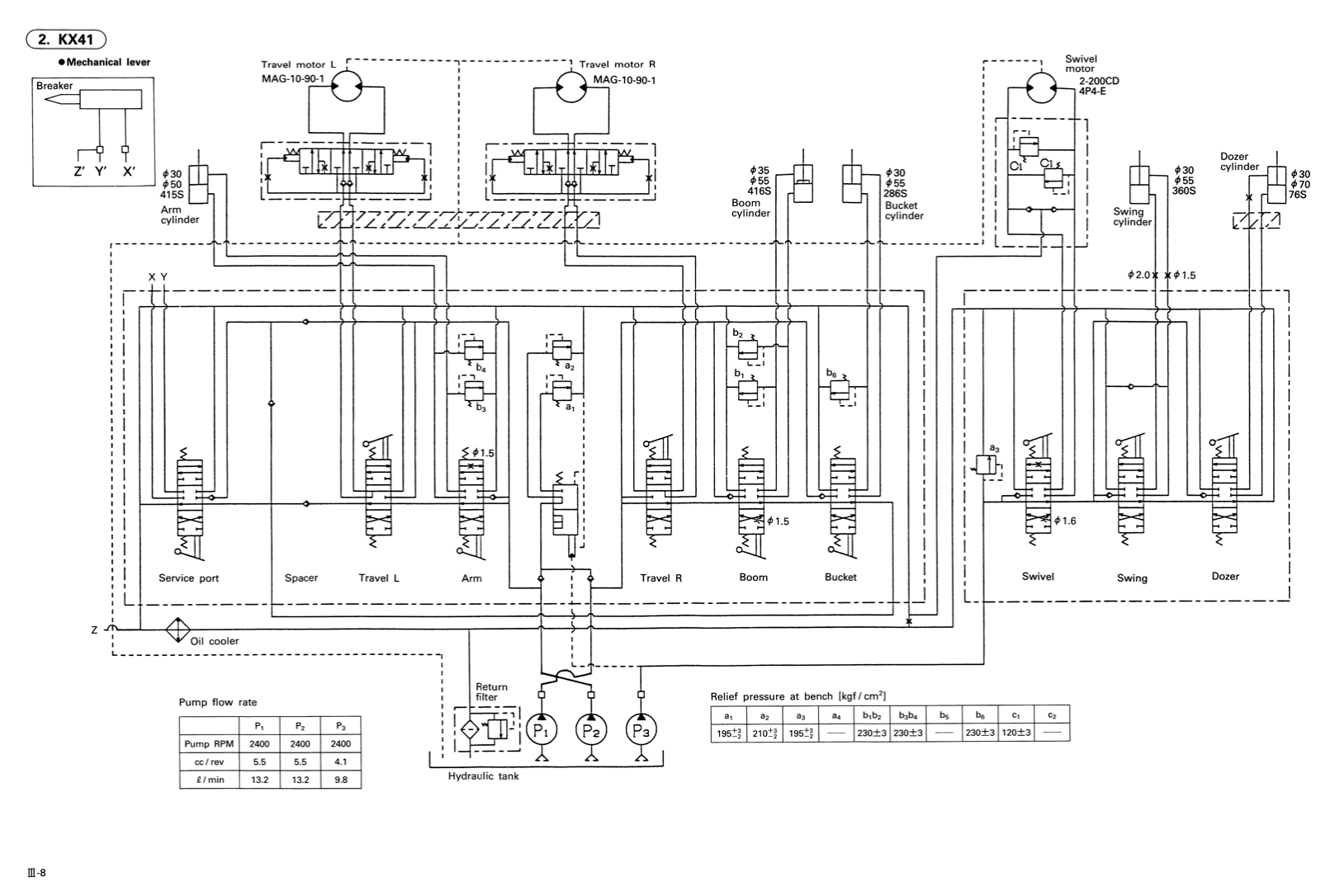

When you tested Pressures at lower RPMs did the pressure drop as soon as you stopped activating that function? If yes does pressure also drop the same way at higher RPMs? Is there a certain RPM where revs drop and doesn’t recover? I.e. 2,000 is OK 2,300 drops..
I was going to study the hydraulic schematic in post #6 in greater detail but it is no longer there.
