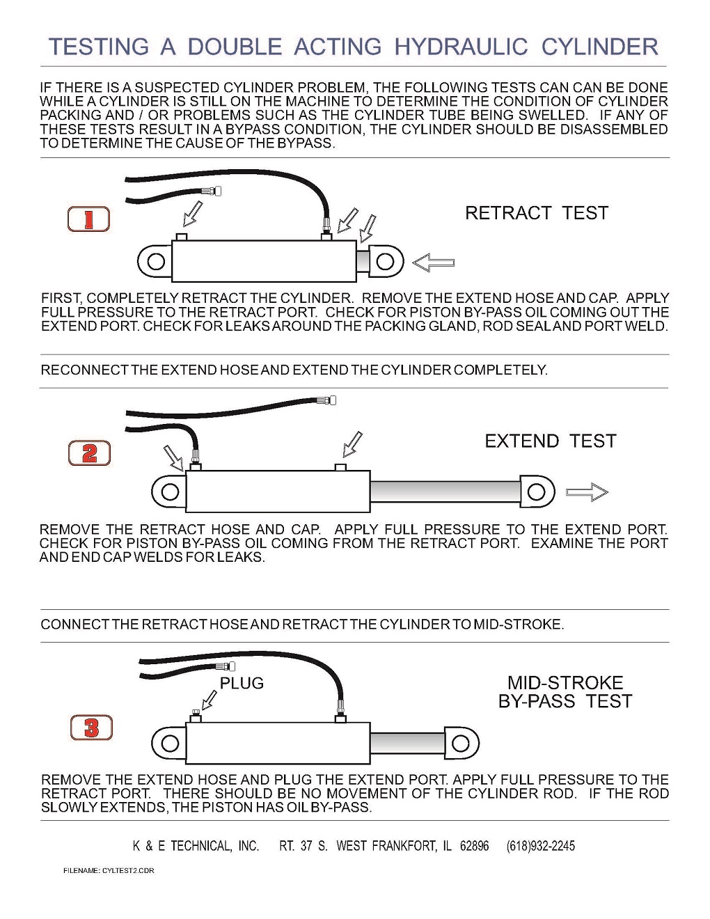

I have a Kubota model L4200 with Kubota loader.
I think it's about a 1998 model; I've had it for about 8 years.
It appears to me to have a problem with the bucket tilt being very weak.
It has been like this ever since I had it.
Just now, for example, I unloaded a bundle of 16 pieces of 29ga. roofing metal, 3' wide x 12' long.
According to several charts I looked up, the total weight ranged from 325# to 375#.
The bucket has 3' long forks, and I had the straps attached midway along the length of the forks.
When I lifted the load to clear the side of the truck, I also tilted the forks downward a little to keep
the straps from sliding back on the forks.
Then as I was lowering the load, the forks started to angle downward and I went to tilt the bucked
back to keep the forks level so the straps wouldn't slide off.
Well, the bucket wouldn't tilt back; in fact when I tried to tilt it back, it actually started to tilt down more.
So, needing to lower the load without the straps sliding forward off of the forks, I then managed to
manually slide the straps on the forks all the way to the edge of the bucket.
Surprise, the bucket still wouldn't tilt back but actually still tilted downward more when I tried to tilt it back.
It sure seems like the tilt should be more powerful than that.
The tilt has the same diameter cylinders as the lift.
Even if the bucket won't tilt back with a load on it, shouldn't it remain in the position
that it's in when trying to tilt it back instead of tilting downward more ?
I was thinking about fitting the tilt with larger diameter cylinders, but I'm now thinking
that there must be something wrong with the hydraulics.
Maybe a leaky valve or something that's letting the fluid bleed back ?
Anyone else have this problem on a Kubota bucket tilt ?

If you take the time to do the following test procedure you will identify if you have a cylinder problem and exactly what the problem is.
There are many stories on the forums of owners damaging their loader cylinders using forks.
The loader valve has its own built in relief valve.
Once you have the control lever in the middle or neutral position, the relief valve is no longer in the circuit and able to protect from over loads.
Back dragging with forks is a common way to bust cylinders internally. The long length of the fork is like a pipe on the end of a power bar. The forces are magnified beyond imagination.
A hydraulic system normally operating at 2,200 to 2,700 psi can easily generate 6 to 7,000 psi using forks.
Dave M7040

I agree 100% with Daves assessment , I like the 3 step test also , very good way to test . My guess is your relief valve is opening when you open your tilt valve. If your piston seals were bad it would slowly drop with tilt valve in neutral. Length of forks are simply applying to much leveridge

If the cylinders did not drift with the valve centered in the hold position the cylinders are OK.
A pressure test at your loader valve work port Quick Connect fittings will verify pump and main relief valve health.
Many CUT loader valves do not have load checks, yours either does not have them or one could be faulty.
375# centered as far out from the bucket pins as you describe could easily create more pressure on the rod side of the bucket cylinder circuit than the relief valve could hold when the curl valve was stroked.
In the absence of a load check in the bucket circuit and given an acceptable relief valve pressure your loader reacted properly to an overload condition.
There's an excellent chance that a set of pallet forks connected directly to your loader frame or QA device would have handled the same load just fine.

1.Relief pressure is too low.
2.The load is too great.
And when I make the tests in post #4, and if the cylinders pass the tests, what then could the problem be ?
Without establishing cylinder drift with the control spool centered, post #4 tests are a waste of time.
And if it's a messed up valve in the control, is there any way to test for that ?
Connect both curl circuit hoses to the lift circuit QA connectors and the lift circuit hoses to the bucket circuit QA connectors.

The simple test is to swap the lines on your loader valve so that the lift arm circuit is controlling the bucket. If the problem goes away then you have determine the valve is the problem.
