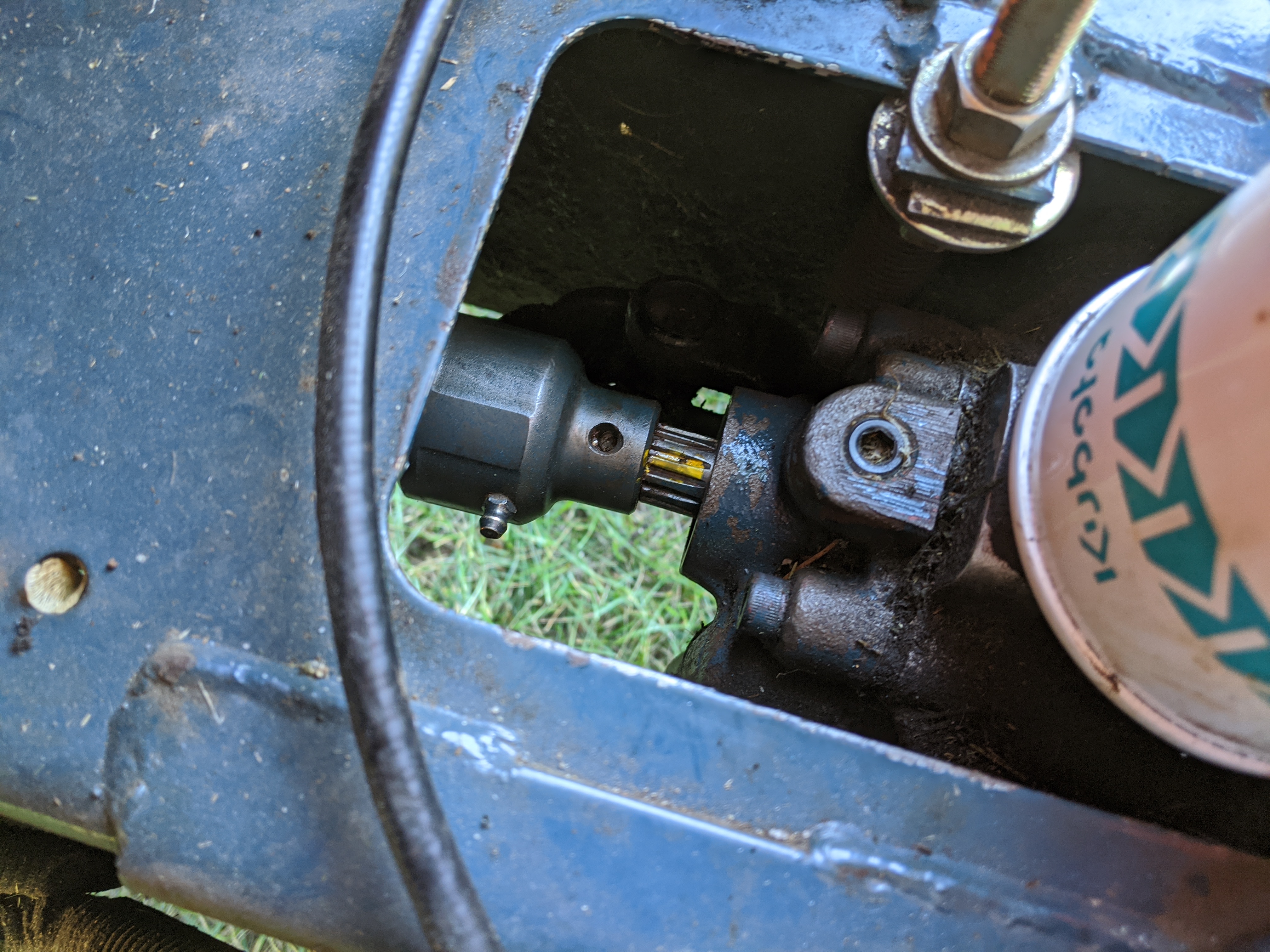

While mowing with my old Kubota F2100 front mount mower the other day I came to a abrupt halt accompanied by a grinding noise. It didn't take long to figure out that the coupler coming from the engine/clutch was spinning on the input shaft for the HST.
Replacing the through bolt only got me so far (I snapped 3 to finish the yard) and I switched to a grade 10.9 (up from 8.8) which only got me so far as well.

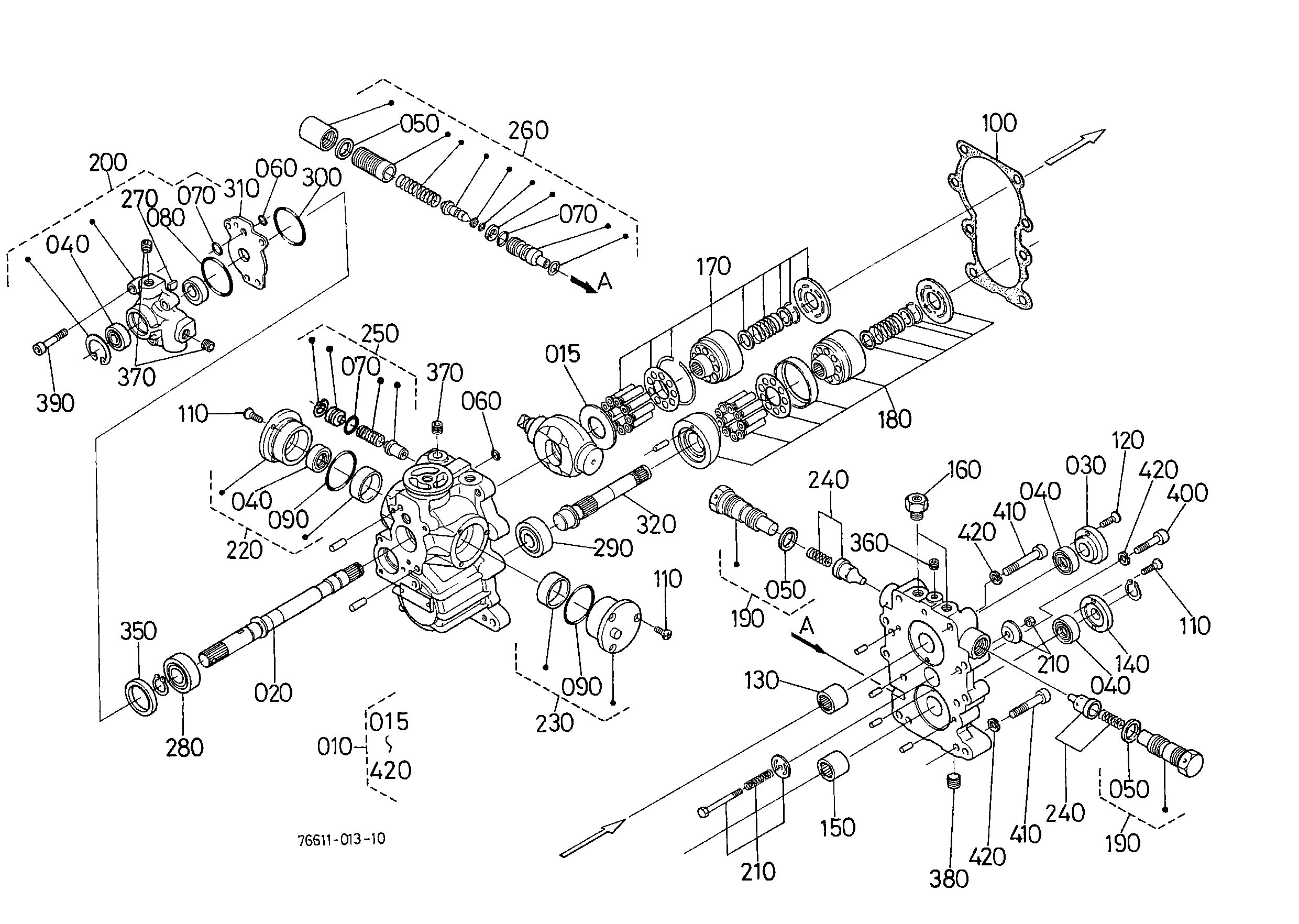

I wondering what my options might be at this point. A look on the Kubota parts finder page puts this shaft at nearly $1200 which is a lot of money to invest in this old girl (about 3500hrs on the meter). Pluis this isn't a job I see doing myself. Pulling the HST doesn't look too bad, but I don't intent on splitting the case myself.

I think I under stand the grease fitting now as it appears the coupler has a ball joint of some kind, I guess to accommodate whatever driveline flex there is.

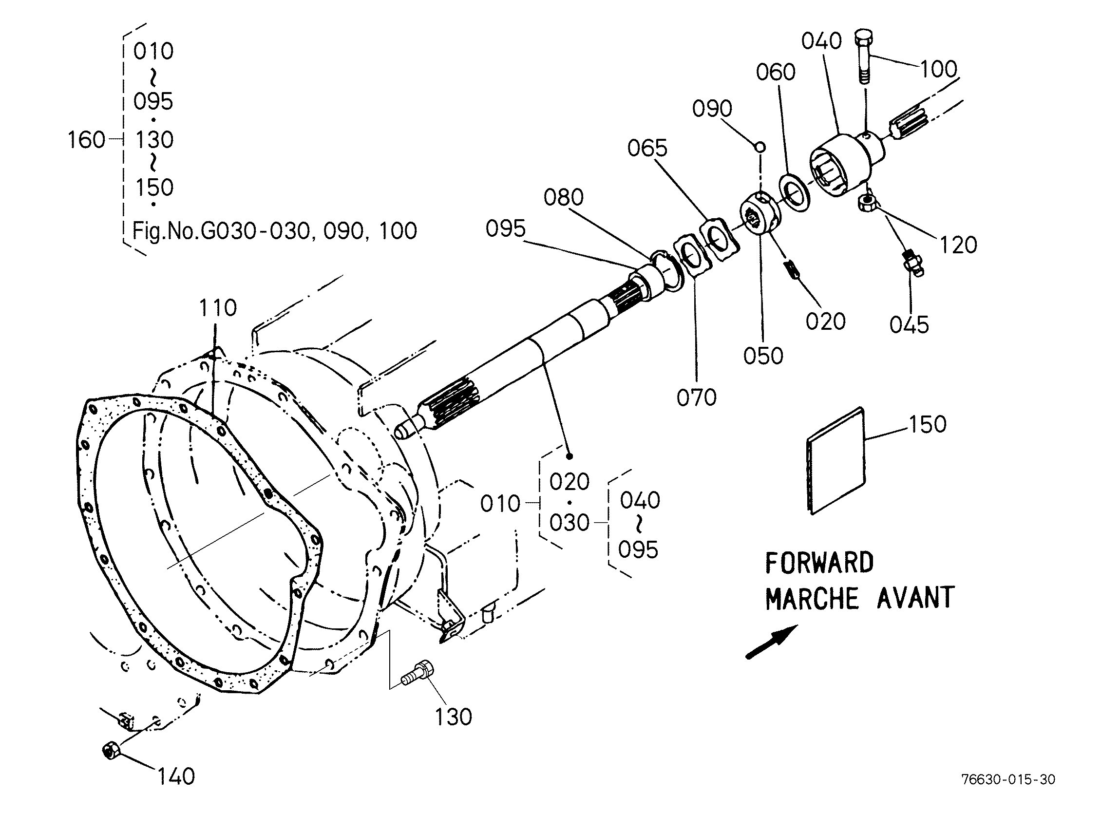

See if you can't find a browning taper lock hub assembly the same size and spline count as the input shaft. If so then take part #40 to a machine shop and have the hub welded on. Reattach to your input splines and tighten down the taper lock. Chances are it will never come loose again.

IT appears the the parts 40 and 50 are part of a CV joint.... IF you are blowing shear bolt/pin 100 then it may be easy to replace the CV joint and not have to deal with $1200 shaft....

I had "my guy" pull the HST and the shaft comes out relatively easy once you have the HST out. Both the shaft and the ball-joint coupler were demolished.
We talked about various options, many of which he was not comfortable with as he wanted to ensure it didn't end up with imbalance or vibration that could wreck (even more) very costly HST components.
Before I ordered a new shaft, he told me he was going to stop by a machine shop he deals with to see if they could re-spline the shaft. I'm guessing they were going to give it a shot, as I haven't got a call back.....

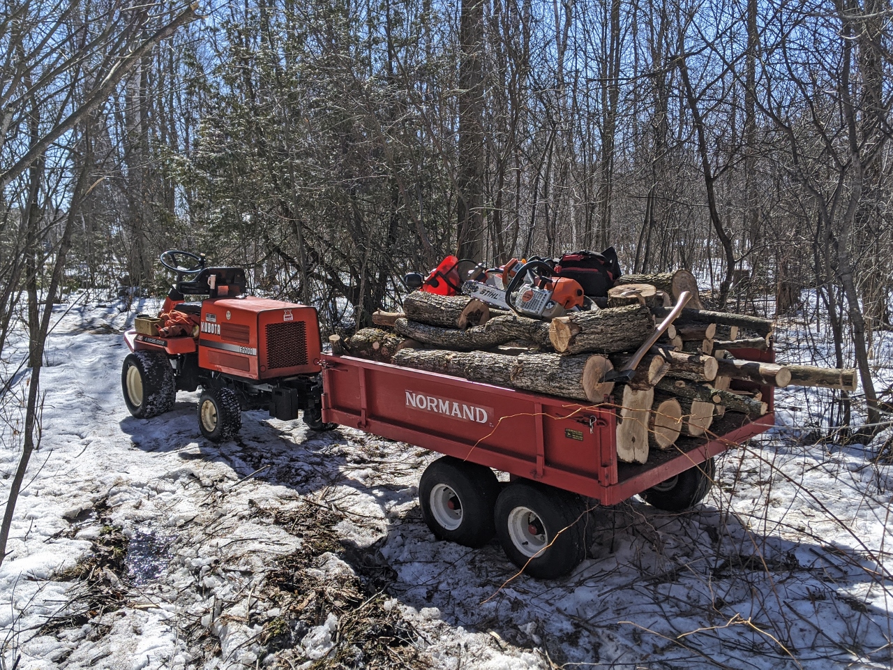

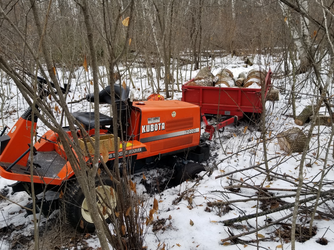

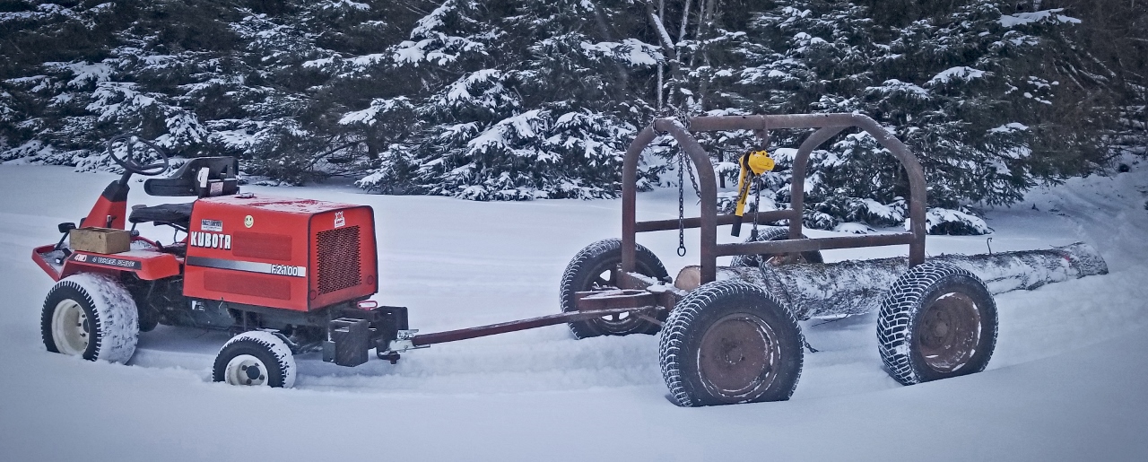

Again, I was disappointed that this shaft would have failed, then I remember how many times I had gotten bogged down in the mud and snow with a thousand pounds plus behind me. Nevermind the countless years of plowing abuse (II use a blower now on another tractor).

I'm shocked you get along with those turf tires in that terrain and envirnoment. Snow, maybe not so bad, but turfs and mud don't get along.
