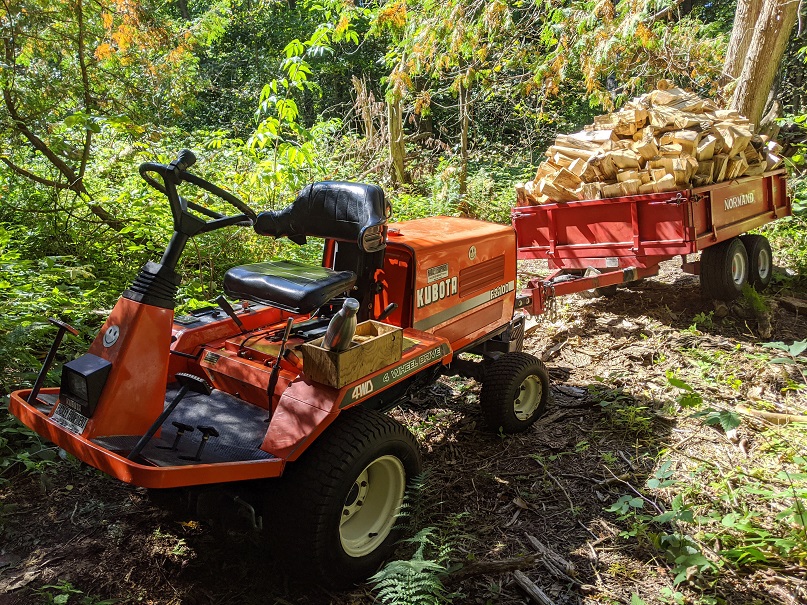

All patched up and back to work. Had the shaft repaired and a new coupler put in.
